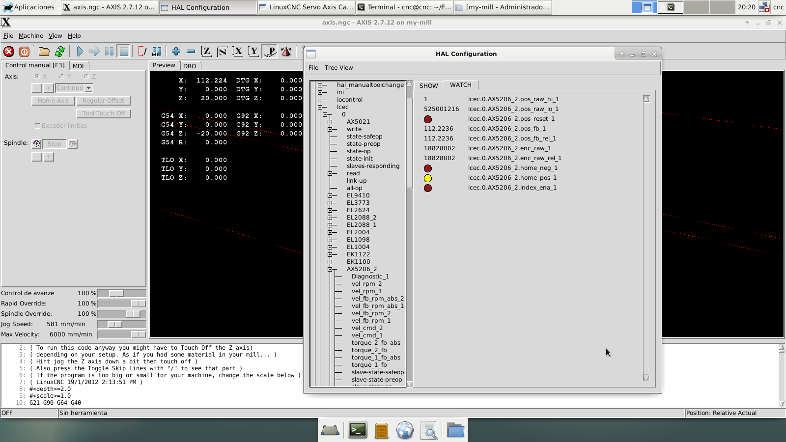

Hello,
someone can help me, I have a doubt with this part of the file code, I think this serves for the home function, I do not understand its operation, I can not find any concrete example of how to connect it to the .hal file.
thanks
Chimeno

hello again, you can expand the scale, now I need to use the scale correctly.
regards
Chimeno

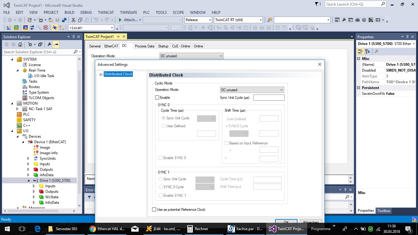

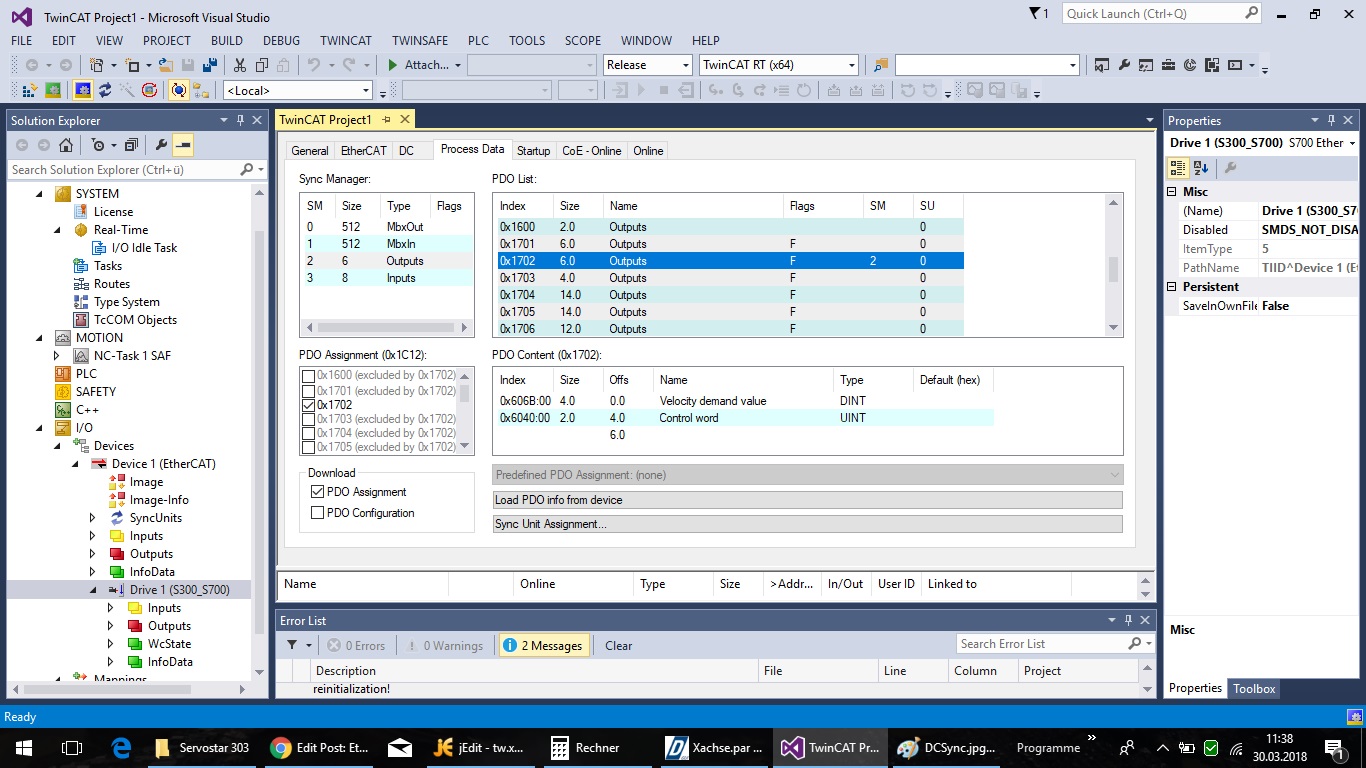

30 Mar 2018 09:33 - 30 Mar 2018 09:39 #108094 by ChrisB
Replied by ChrisB on topic Ethercat HAL driver
Hi
i use Patchcables.
Now i solved the problem more ore less. i changed the networkcard. i used the 8169 chip and now i use the 8193c with the 8139too kernel driver. I read that some people had problems with the 8169 chip.
Now the slaves are found by the cmd-ethercat-tool in any combination.
But up to now i am very close to get it running.
With a small sync problem oder config problem.
But i can't find the mistake.
When i start linuxcnc my kollmorgen S300 has an errror. F29 invalid ECAT actual-value mapping length
So it seems to be a problem with my xml config.
I attach my config and the output of the cmd tool and my hal and ini file. And the pdos output
And how can i config the dcsync?
The IO's work well

30 Mar 2018 10:49 #108099 by sirop
Replied by sirop on topic Ethercat HAL driver
Hi
i use Patchcables.
<pdoEntry idx="6040" subIdx="0" bitLen="16" halPin="Control_word" halType="bit"/>
and
<pdoEntry idx="6041" subIdx="0" bitLen="16" halPin="Status word" halType="bit"/>
So in both cases you map 16 bit pdoEntry to halType="bit" . Does this make sense?
I would use smth. like halType="u32" for control and status word, or if you need bitwise operation on control and status word,
then use halType="complex" as in github.com/sittner/linuxcnc-ethercat/blo...ercat-conf_X.xml#L98 .
