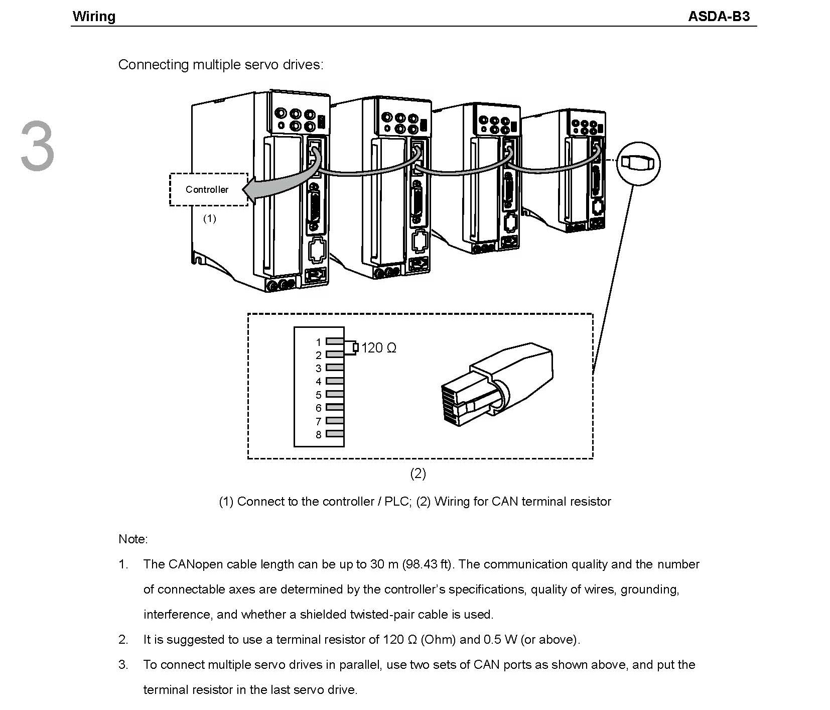

Hello
zmrdko,
Thanks a lot for your reply.
I don't get the usage of 120 Ohm on both ends? I just would determinate the last one - as shown in the delta manual.
Do I missunderstand it?
Are you working with an extra translator from CANopen to EtherCAT - like in front of the EL6751?
Thanks a lot for your help in advance,
best regards
Jürgen
best regards
Jürgen

AH, this translator is just working as Slave ...
So how I am getting the DELTA into a CANOpen/EtherCAT MASTER?
Thanks a lot for your reply in advance!

hello gentelmen,
there is single master EL6751 + single canopen slave .. in my case is the Sew EuroDrive lteb+ which has canopen port directly on board... I did el6751 master component and sew lteb+ component...
there is speed limitation of 4ms scan cycle but it is periodical ... it is defenetly no RT but for spindles with only speed control should be used...
enjoy
enjoy
