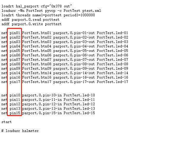

About "pin01 ..." :
this is the name for the hal net connection, it could also be xx,yy,sk,red,blue ...
at this example the connection (net) bettween
PortTest.btn01 and parport.0.pin-01-out and Porttest.led-01 is named "pin01" .
every net (connection) in hal needs an unique identifier (name). read the hal section of the manual.
so if you don't know how to link, try for example
net mynet PortTest.btn01 lcec.0.3.xxxx
for me it is not clear whats is your question.
-does your ethercat not work?
-you don't know how to link the gladepanel to the ec-slave?
-linking works (no hal error), but there is no function at testing? ...
About "pin01 ..." :
