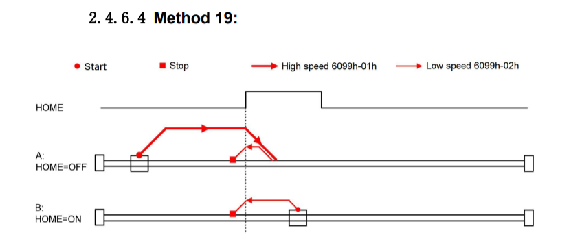

Yeh, I had a bit of a play this morning before work and did not have much luck.
I added an input for the home switch which is fed by an output from lcec.
Take homing method 19
When the home switch (attached only to the drive) is activated per the top diagram, the drive halts movement. It should halt and reverse to find the edge which its not doing. Deactivate the switch and the move to position finishes (applying offset set in the drive).
I did get it to force lcnc homing but the drive was not in correct state. I will try your ideas.
Somehow I think linuxcnc still has its finger in the pie and possibly overriding our desired behaviour.
- Posts: 21901
- Thank you received: 7465
09 Jan 2022 22:16 #231263
Replied by tommylight on topic Ethercat - newbie guidelines
Homing from the wrong side of the switch would result in what you describe, see lover part of the drawing.
Just a stab in the dark.
- Posts: 12141
- Thank you received: 4141
09 Jan 2022 22:36 #231265
Replied by rodw on topic Ethercat - newbie guidelines
Yes its possible the HOME_LATCH_VELOCITY has an incorrect sign. I did think of that. But this is all happening external to Linuxcnc. Eg Linuxcnc is not commanding the motor to move, the drive is.Homing from the wrong side of the switch would result in what you describe, see lover part of the drawing.
- db1981
- Posts: 790
- Thank you received: 276
09 Jan 2022 22:57 - 09 Jan 2022 22:58 #231266
by db1981
Replied by db1981 on topic Ethercat - newbie guidelines
but maybe your input logic on the drive is inverse, or them are sink inputs.
hold down the switch, start the homing, release the switch and push it again.
I'm shure your drive then has done the excepted homing.
normaly you can set inverse of the input with an register.
Last edit: 09 Jan 2022 22:58 by db1981.
- Posts: 12141
09 Jan 2022 23:05 #231267
Worth a try! 0x2008 sets input port polarity on this drive. (Normally Open or Normally Closed)but maybe your input logic on the drive is inverse, or them are sink inputs.
- Posts: 21901
10 Jan 2022 06:04 #231288
I never said anything about LinuxCNC.
What you describe exactly matches the B section of the attached picture, so the drive is doing what is told but from the wrong side so it stops.
- Posts: 12141
10 Jan 2022 10:02 #231294
Well I went back and checked what limit switches I had bought and they were normally open (NO). I checked the settings and NO polarity is a 1. Bit 4 (where the first bit is 0), is the one applicable for the home switch. The default setting in the register is 0xF0 so the input was set to NO.
I played around with the polarity and ended up with an utter mess. so reverted back to the working config using the component above.
So I'm going to sit this out until I get some ball screws mounted and the drives off my desk and into a machine. That may take a while.
Thanks everyone for your support. I will report back in due course.
