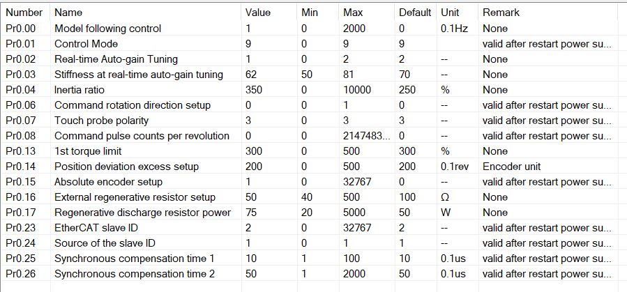

Now I'm the one with the late answer - sorry for that, but I've been really busy with work over the last few months.
The setup and fine-tuning of the drives not only took a lot of time, but also had its ups and downs. In the meantime, I have a working setup (you can find all the files attached to this post), but there were many lessons to learn and there are still many things to learn and optimize.
1.) I have also come to the point that Pr0.02 must be 1 for "Velocity Mode".
2.) The machine works when Pr0.00 is set to 1 for all axes, but your comment is correct and I missed that statement in the manual. I will try 0 or 100+ and report back on the results.
3.) Regarding my experience with PID: As you can see in my INI/HAL, there is a PID put in place. Initially the parameters were set to achieve the lowest possible following error (<0.01mm) while still keeping the machine stable at higher speeds (10m/min). But when operating the machine, cracking noises could be heard. At first I thought these were coming from the mechanics, later I found out that this was coming from the PID. Then the PID was disabled by setting all parameters to 0 except FF1 which is set to 1. The machine worked although having larger follwing errors and the results were amazingly good! BUT - and of course there has to be one - I had another strange problem. When the machine was switched off after moving to any position, the current set position was set equal to the commanded position, thus ignoring/overwriting the feedback from the abosolut encoder! Since there is always a small difference between the commanded position and the target position, there were growing deviations when several parts were machined in succession without a zero point being set in between, or when the machine was switched off and on several times for a single part.
Therefore, you can now find very low values for the integral part of the PID with P=5.
As the machine is running and the first projects were granted higher priority there was not much more fine tuning and optimization the past months. But knowing there is someone working on the same setup is motivating me againg to look deeper into the topic. I hope that we can find the best setup for this sort of setup and can post it soon.
Many thanks for your input!
PS: Please apologize for the messy HAL/INI file with german and english comments all mixed up.

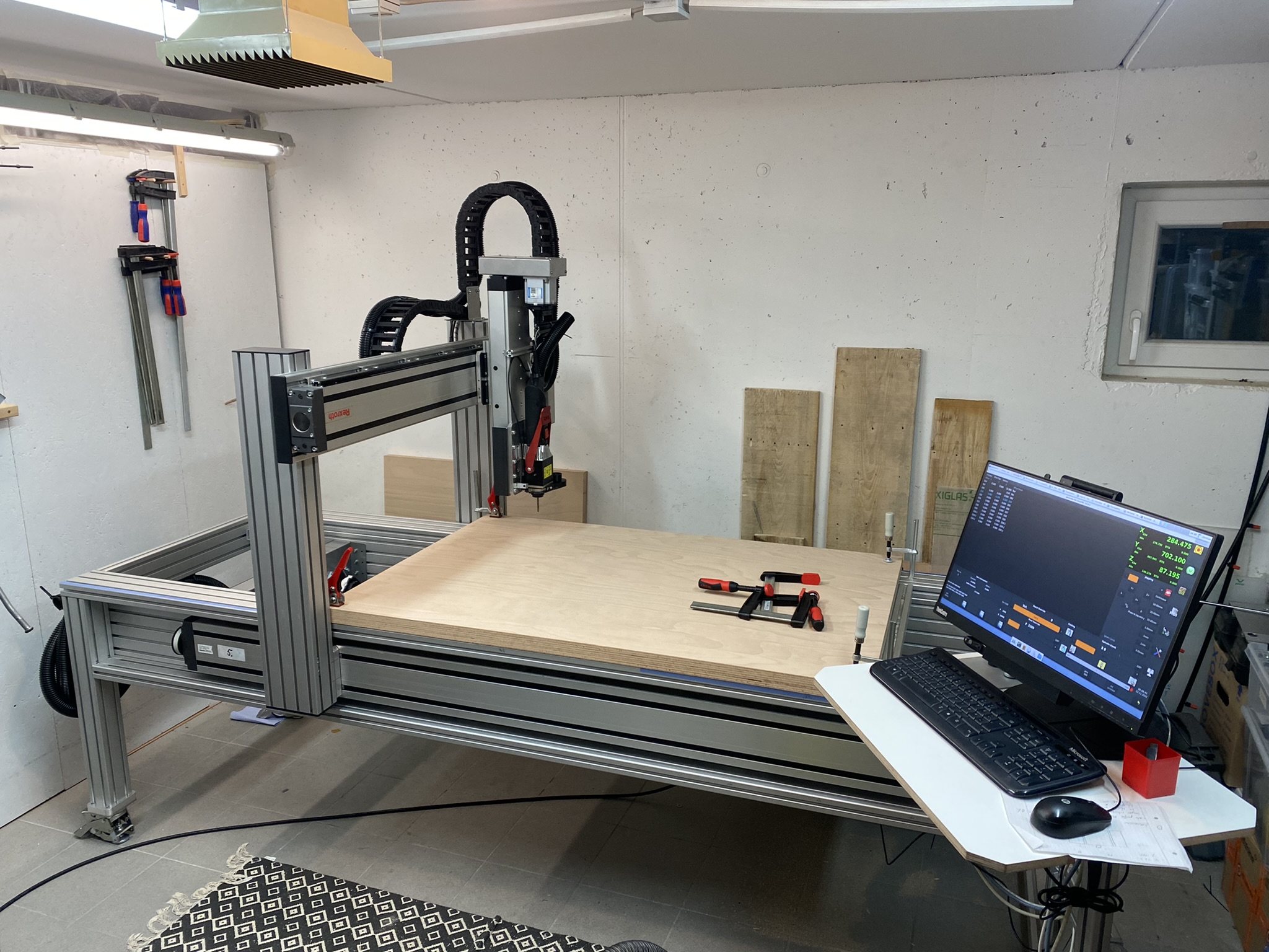

PPS: I am very curious about your machine and would be happy to know more about it. You can find a picture of mine in the attachments (the first to be uploaded at all)
Cheers Christian

Setting up the drives took a while: yeah... they're capable but I suspect that there's a bunch of 'smart' things happening that are making them useless in position mode (eg they'd settle with a huge steady state error etc) and the documentation/software isn't clear on what might be doing that... but PID back to LCNC in vel mode works well. I guess that's the difference between a $10k yaskawa setup and these :shrug:
PID: yeah, I have mixed settings:
There's still a lot of drive-side tuning I could do, need to dig through the manual with velocity mode in mind to find it all though. If the budget could stretch to a bigger gearbox (400W rated one was $500) to suit my spare 750w motor I'd change over X and solve a bunch of issues.
Your deviation problem is interesting.. I don't have absolute encoders on mine so I haven't had that issue, I need to home before use. I vaguely recall seeing something in one of the ethercat threads about updating lcnc using the absolute encoder but I can't find it nor remember enough to give you a good search term.

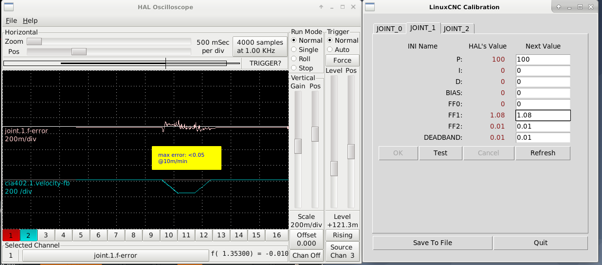

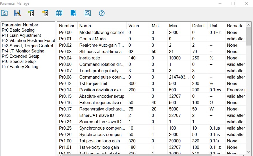

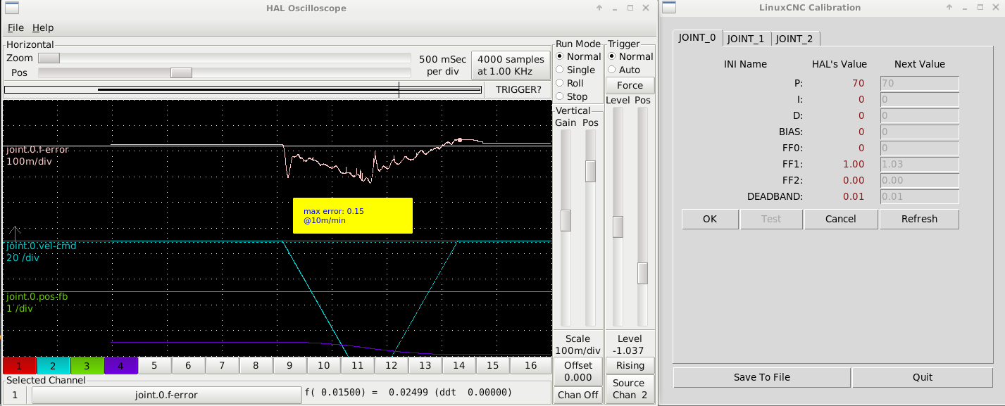

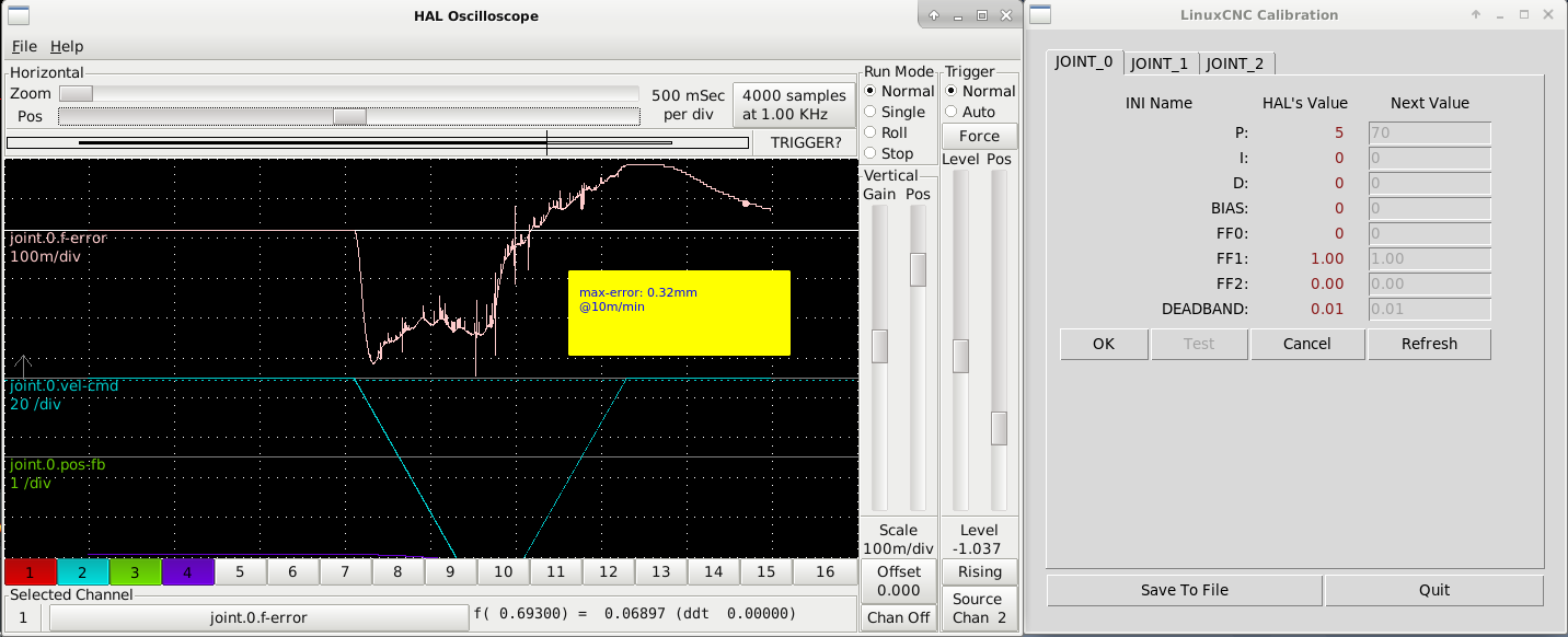

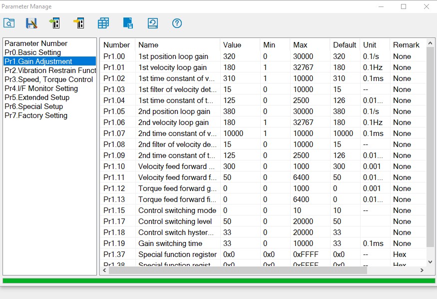

Today I spent some time on optimizing the drive setup:
Initial Setup:
The speed was set to 10m/min and I moved the axis.
Following errors were about 0.35mm.
Afterwards I have changed the parameters of the drives to
The results in hal-scope basically did not change - which admittedly was a bit unexpected.
But the big game changer was that from now on I was able to adjust my PID parameters freely without any strange interferences from the drives (in the past I got rattling noises and vibration as soon as the PID parameters became to "strong").
The procedure was as follows:
I used these settings to mill a few parts and I am really happy with it!
Attached you will find my latest settings.
Maybe you can try this approach with your machine setup and report if you also get good results?
Cheers
Initial Setup:
- Pr0.00 = 1 (set bandwith automaticall)
- Pr0.02 = 1 (velocity mode)
- Pr1.15 = 0 (mode of position control - fixed to first gain)
- PID within LinuxCNC was basically the same for all axes with P=5; I=0; D=0; FF1=1
- Pr0.00 = 0 (inactive)
- Pr0.02 = 0 (inactive)
- Pr1.XX Gain adjustment values set to default
- Inertia Ratio values remained unchanged

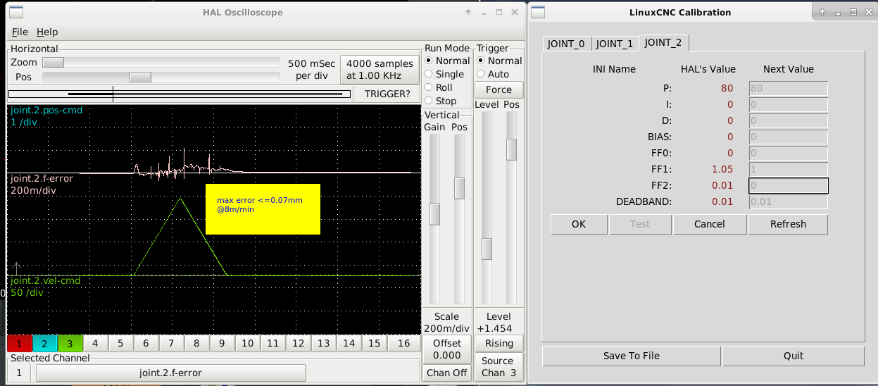

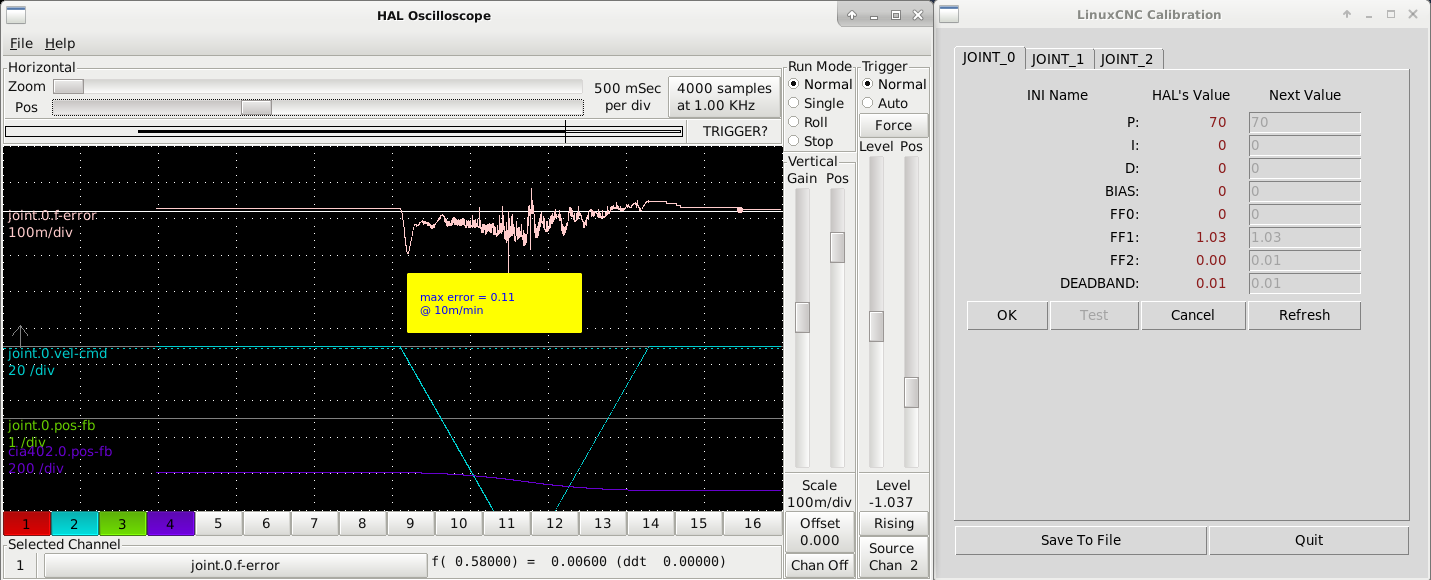

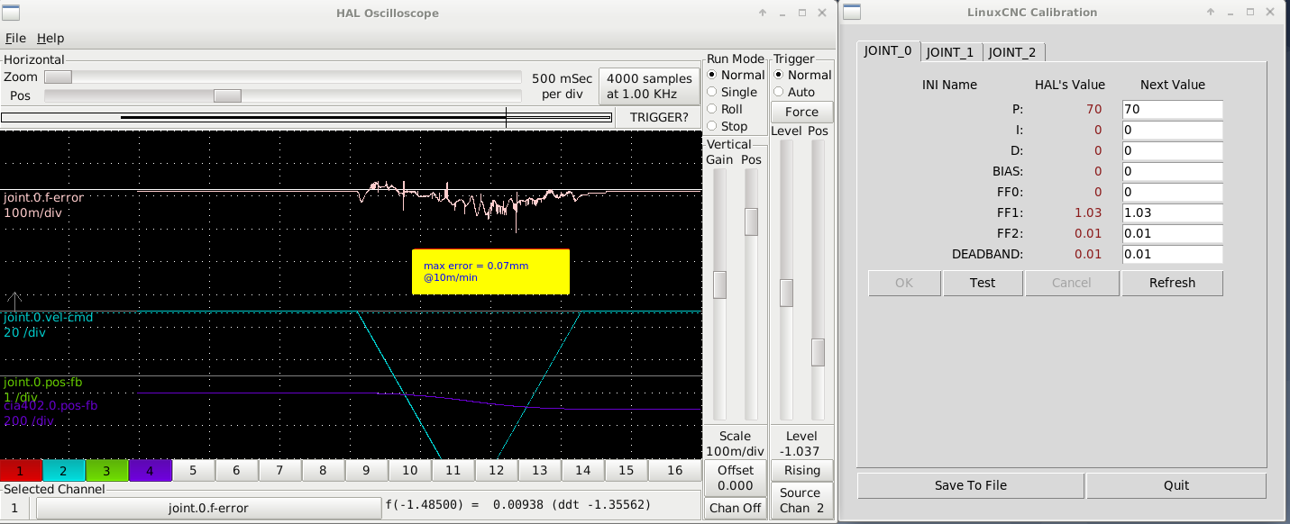

- Increase P until some oscillation is visible and slighlty lower the value again (velocity set to 10m/min)
- Then I tried to use I and D to adjust the remaining error as well as overshoots without satisfying results - so I kept I = 0 and D =0
- Increase FF1 very slightly and got the effect that was expected from integral part
- Put FF2 into action to remove overshoots as expected from differential part
Cheers

Quick update:
Did what you suggested and it definitely improved things. A couple other things I played with that you might find useful:
- Manually tuning: X axis is flawed (dual fixed 4m ATL5 steel core belts the gantry crawls up like a rack, is effectively a spring, resonance issues) so I ended up manually tuning pr1.00-04, and pr1.12 while linuxcnc was simultaneously tuning the PID on linuxcnc. I started with setting the drive's stiffness to give some good starting values, then switching the auto modes off as you recommended, then playing with the settings manually. I didn't bother doing this for the other axis as they were fine without it. I managed to halve the following error this way (but likely only because it's such an odd kinematic setup)
- 3.12 and 3.13 accel/decel: These values limit drive's responsiveness but do prevent jerk, I reduced the from the defaults (100) to 20
- 3.14 - Sigmoid accel/decel: given the springiness of the X axis I added a tiny bit of S curve via this parameter which smoothed out the bounce and allowed smoother movement/tighter pid.
- 3.16 Zero speed clamp: I'm unsure if this had any impact during PID testing but I suspect it will in use. Basically it sets what RPM the drive should consider 'stopped' and try and clamp the speed at 0. Given the very low reduction on X (one revolution of the motor is 6.3mm of travel) I dropped this to the lowest value of 10 for this axis. I think it'll have an impact when the drive is accelerating from stop etc.
- 4.37-39: for the axis with a brake (Y in my case) tweaking these settings improved smoothness when the drive is enabled - previously the axis would drop a small amount when the motor turned off leading to a shock load on the brake. You might find it useful also
- 6.08/09 torque compensation: It took forever to find a parameter to bias for gravity, turns out it's these two. My Y is on a 10mm ballscrew and pushing ~15kg, if you disconnect the motor from the screw it falls pretty quickly (all axis are set up for high speeds and small loads). I noticed that the drive would always lag going up and then overcompensate, by tweaking this I got it to behave symmetrically.
One thing I haven't been able to figure out is vibration suppression... I previously got it to work (in one of the videos I sent you) but I haven't been able to get it to work with the velocity mode change (with drives set to auto or manual), not sure what's going on there. Also never got the adaptive auto filter to do anything (in position or vel mode), did you ever play with those features?
