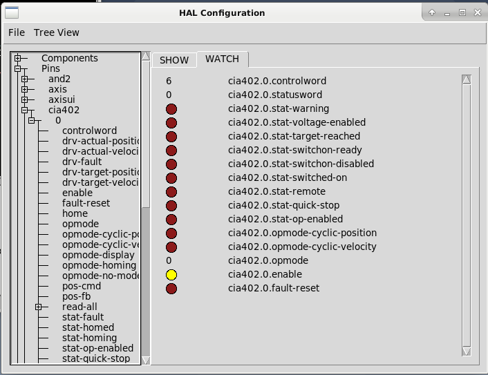

OK, so the current state is this .
I have power to the drives and the Estop circuit is ok . But the drives are still reluctant to run .
The drive is in PREOP mode and the status word remains 0 whatever I do .
Is it possible the drive times out after a certain amount of time, or is it something to do with the clock syncronisation ?
P.S. It doesn't respond to error clear as well .
Last edit: 24 Oct 2021 11:30 by Niko.

hello,
as long as the drive is in ethercat preop mode there is no cyclic pdo communication.
So, something with the ethercat configuration is still not working.
You have to look in dmesg for the error messages, with ethercat debug level set to 1.
start linuxcnc cnc, and search in dmesg for the messages after the last "ethercat: requesting Master 0" ....

Report from dmesg :
A few datagrams timed out and the drives have
And all of them have this error
[ 15.109130] EtherCAT WARNING 0-2: CoE Emergency Request received:
Error code 0x3120, Error register 0x00, data:
[ 15.109135] EtherCAT DEBUG: 00 00 00 00 00
[ 15.109619] EtherCAT ERROR 0-2: Mailbox error response received - Unknown error reply code 0x0013.
[ 15.109628] EtherCAT ERROR 0-2: Failed to read number of assigned PDOs for SM2.And all of them have this error
Failed to set SAFEOP state, slave refused state change (PREOP + ERROR).
AL status message 0x001E: "Invalid input configuration".
Last edit: 24 Oct 2021 13:39 by Niko.

seems that the slave has an fixed pdo mapping.
I think you have post the pdo config of this drive on top of page 2.
So build the ethercat_conf exactly like the readout has been.
SM2
RxPDO 0x1600 ""
PDO entry 0x6040:00, 16 bit, ""
PDO entry 0x6060:00, 8 bit, ""
RxPDO 0x1601 ""
PDO entry 0x607a:00, 32 bit, ""
PDO entry 0x6081:00, 32 bit, ""
RxPDO 0x1602 ""
PDO entry 0x60ff:00, 32 bit, ""
use 1600, 1601 and 1602 to get the pdos you need
