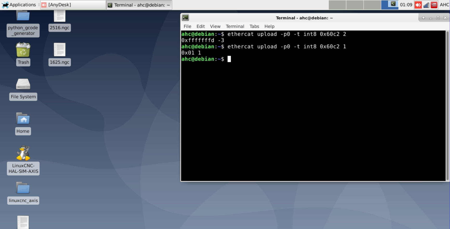

hello all
I have been developing a wood drilling machine with Linuxcnc and I am using delta asda-a2 servo drivers and motors. My servo xml file attached below and I have a problem like in the video. these servos making noise in a short period of time and I have no Idea why. With Mitsubishi motors and drivers I had no problem. Do you have any idea?
Thank you

did you set the following parameters correct in the servo drive ?
-0x60C2:01 = 0x01 (interpolation time period 1ms)
-0x60C2:02 = 0xFD (interpoltatin time index 253)

I think our 0x60C2:02 parameter is not correct according to picture.
right?
right?

Hello,
the values are correct.
Did you checked with halscope that this behaviuer is not related by the joint.pos.cmd?
Is this signal clean? If not, it could still be an hal/ini problem. Is Trivkins used or an special kinematic?.
How did you get the etherlabmaster and linuxcnc-ethercat? ec-debianize or one of the images that i don't know?
Last way to check, would be to change the pll clock.
for that you have to install an rip version, and then apply the "add-task-pll-functions.patch" from the patches folder in linuxcnc-ethercat.
After this you can set refclocksynccycles to -1 and sync the linuxcnc task to the ethercat clock.
