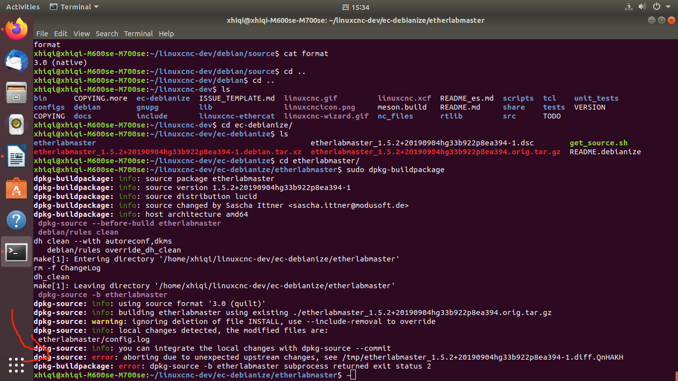

Hello, now I have a problem, I hope you can help solve it, thank you very much
I have an incredible problem with installing linuxcnc and ethercat When you do the ec-debianize installation, after sudo. / get _ source.sh, you need to do the following sudo dpkg-build package, but the problem is that I ' m confused for a long time, and I hope you can help, thank you again!

did you check with dpkg-checkbuilddeps ??

has the get_source scripted worked completly. Shoud display a longer lister of patches that get applied.....
another case could be missing kernel headers:sudo apt install linux-headers-$(uname -r)

15 Oct 2021 02:19 #223147

主要解决图片中出现的问题

without informations, we are not able to help.
On what kernel/system you are trying to build?

linux kernel
Driver configuration dpkg-checkbuilddeps between ethercat and linuxcnc
Mainly to solve the problem in the picture

which linux kernel / version.
post the output of the command "uname -a"
