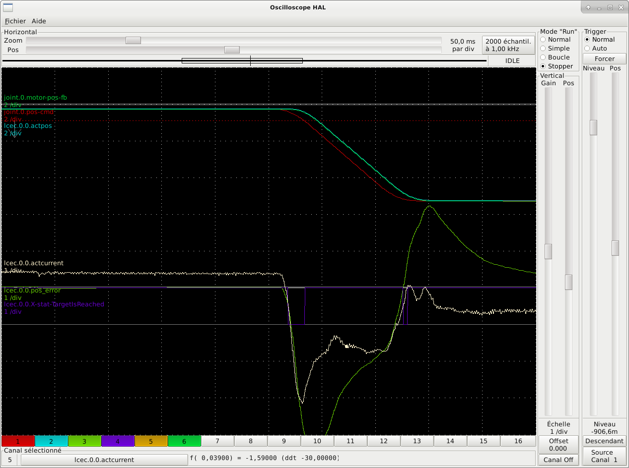

So, in my case I try to set up one axis
I tried in position mode and now in speed mode, it's working! movement and scale are ok
but the f-error is very too big, with at least 25 milisecond of "latency" between pos-cmd and actual-position (see capture screen).
And I don't understand why? I tried to improve gain and other parameters
(all servo's parameters are make with KincoServo+)
I guess this error is a clock fault ??
or other way ?

there are a few points in your hal file that may cause this behaviour:
-place the line "addf x.pid.do-pid-calcs servo-thread" after the "addf motion-controller", with your current order pid will calc with the values from the wrong cycle. search in this forum for "execution order" i have explained this a few times.
-net x.s.pos-cmd => x.pid.command => axis.x.pos-cmd
your are using the wrong pos-cmd, "axis.x.pos-cmd" has to be joint.x.motor-pos-cmd . I believe this is the main reason for your delay.

Thank for your help,
I noticed your message on "execution order" and made some adjustments since then. ( this one )
I changed too axis.x.pos-cmd to joint.0.motor-pos-cmd
and increase gain for a best response
but always ~20ms of delay..
You can see on new screen capture (oscillo_3.png) where I have added joint.0.motor-pos-fb (green)
Why I have a delay between joint.0 and lcec.0 ?? and so why lcec.0.0.pos_error seems coming at the right moment ?? ( this will prove that  is not a clock / sync problem, no ?)

quickly:
My reference was not the right one: lcec.0.0.pos_error is about speed and not position. The good reference is joint.0.f-error
