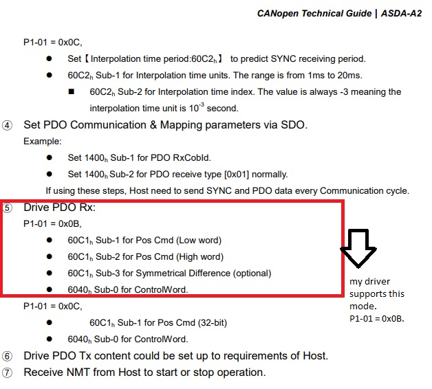

Hello;
I already checked the ESTUN servo driver with EL6751. The pdo of the target location in the ESTUN driver was U32 bit.
I wanted to run my Delta ASD-A2 drive on the side to improve myself. However, in the Canopen whitepaper I found that the pdo target location consists of High(16bit) and low(16bit) words. As you know, Linuxcnc sends the Float type target location command. To solve this problem I will need low and high 16 bit conversion from Float. And of course, it needs to convert as fast as possible to match real time. My opinion is to convert from float to binary as fast as possible. The Ethercat Hal driver does the rest by dividing and sending complex data type bits. Waiting for your valuable ideas.

LinuxCNC HAL has float-to-int conversion:
linuxcnc.org/docs/2.8/html/man/man9/conv_float_u32.9.html
But it probably makes sense to write a custom component to output two 16-bit values as I imagine that there is some scaling required?

Yes Andy.
I am proficient in C language.
Thanks for your support and advice. Earlier, I converted an integer 16bit value to 2 8bit values (high and low). Of course, it's not that simple when it comes to converting a floating number.
void split(uint16_t pxreg1,uint16_t pxreg2)
px2=(uint8_t)(0x00ff)&(pxreg1);// low byte
pxreg1=pxreg1>>8;
px1=(uint8_t)((0x00ff)&pxreg1); high byte
px4=(uint8_t)(0x00ff)&(pxreg2);//low byte
pxreg2=pxreg2>>8;
px3=(uint8_t)((0x00ff)&pxreg2); high byte
I'm continuing to work. If I find a fast algorithm like I mentioned, I will share it. Being open to ideas has always improved me.

I don't think that you need to worry too much about speed. The component will run once every mS and will probably complete in nanoseconds.
I would let the compiler convert the float to an int, then split that into two HAL pins.

Hello. This is a simple component. I have tested on the EL6751. The result is very good. I haven't had any lag issues. I wish you good luck. Kind regards.
SERDIGI.
SERDIGI.
component split "Delta ASD-A2 Firmware 1.03 linear Interpolation position register splitting HIGH Word and LOW Word";
pin in float pos_in;
pin out u32 pos_out;
pin out u32 pos_low;
pin out u32 pos_high;
pin in float resulation;
variable uint32_t xtemp=0;
variable uint16_t px1=0;
variable uint16_t px2=0;
function _;
license "GPL";
author "serdigi";
#include "rtapi_math.h"
FUNCTION(_) {
xtemp = pos_in * resulation;
px1 = (uint16_t)(xtemp)&;(0xFFFF);
px2 = (uint16_t)(xtemp>>16);
pos_low = px1;
pos_high = px2;

I'm late to explain what I'm doing.As you all understand I used igh etherlabmaster and linuxcnc ethercat driver.I was able to run Delta ASD-A2-M (Canopen supported) sevo drivers by including EK1100 and EL6751 in this system.But since the firmware of the drives I have is outdated, the position register in my linear interpolation mode was still u32, but still wanted 2 as u16.I also tried this simple solution. It worked without any problems.
