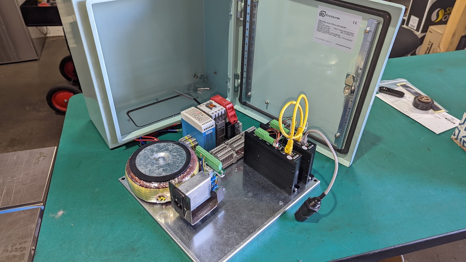

A couple of us are just starting our journey with ethercat
Rtelligent ECT60 and ECT86 drivers and matching closed loop steppers are a good starting point. They have been mentioned in a few threads here.
It untested but I think this IO module might be good value as it has encoder, pwm, analog inputs and outputs all on the one interface
www.aliexpress.com/item/4000894948243.ht...356.4.2cf81bd5mTHQGI
The other I/O alternative would be the Beckhoff gear. They have been very helpful in our country.
I've been trying to document our findings in git here
github.com/rodw-au/linuxcnc-cia402
I think thats a working config and include installation instructions which we found worked. I'm about to try them over the weekend now I have a testbed wired up.

Yes. I had to go and measure it as it was still rolled up. The encoder cables on my NEMA34's that came with my ECT86 drives are about 5 m long
There are three of us now with them and the instructions in our git are evolving rapidly as I got them moving today!
I'm still waiting for a NEMA23 but I am also using an ECT86 driver for it as I can feed them from a 60 volt AC toroid I have on hand
The following user(s) said Thank You: huhuoyun

I saw this sentence "loadrt cia402 count=3" in the HAL file of ECT60. What is puzzled is that the cia402 real-time library cannot be found in the LinuxCNC real-time library; how did you solve it?

<quote>huhuoyun post=229252 userid=31017>I saw this sentence "loadrt cia402 count=3" in the HAL file of ECT60. What is puzzled is that the cia402 real-time library cannot be found in the LinuxCNC real-time library; how did you solve it? </blockquote>
If you follow the instructions I included, all will be revealed<br />github.com/rodw-au/linuxcnc-cia402/blob/...n%20instructions.txt
</quote>
Note this has been updated today to include the Rtelligent RTEC1616 I/O board<br />There may be some sdoConfig statements required.<br />I have not tested internal homing yet. Waiting on sensors but the drives gallop away looking for them!
</quote>
