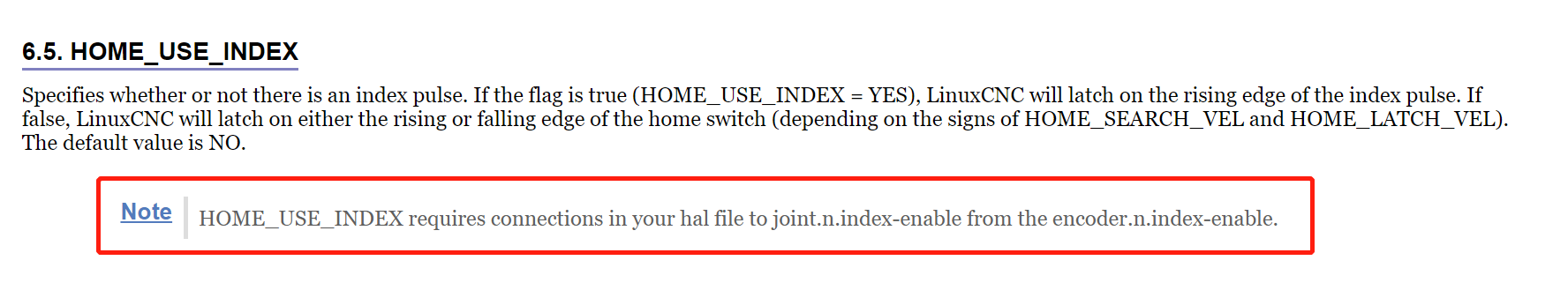

I use the Ethercat bus to control linuxcnc. I found this problem when I configured the home switch. Which pin is ‘’encoder.n.index-enable’’?
I think I should write something like this in the hal file
net encoder_index encoder.n.index-enable joint.n.index-enable
But I don't know which pin is ‘’encoder.n.index-enable’’, because I don’t see which PDO is the index signal in the CANopen manual.
What should I write?
net encoder_index lcec.0.0.??? joint.n.index-enable

I don't know if this is standardised, but on my EtherCAT drives the index flag (called "Phase Z" by Omron) is part of 0x60FD "Digital inputs". Bit 16 to be precise. This is 1 if the index was detected during the last communication cycle.
For better precision it's possible to latch the exact encoder value when the index pulse was detected and read it back, just as if it was a touch probe. I'm not sure how to make LinuxCNC use this value though.

Thank you for your help, I did not see that the 16-bit of my servo drive 60FD is the index signal
