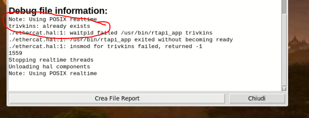

Right! I had to comment the lines for the resolution of the problem. For example if I put the first line
loadrt [KINS] KINEMATICS
It gives me the following error

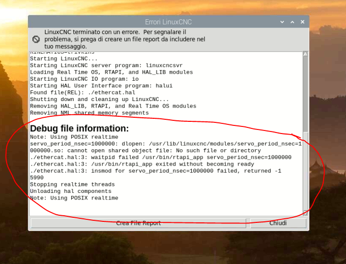

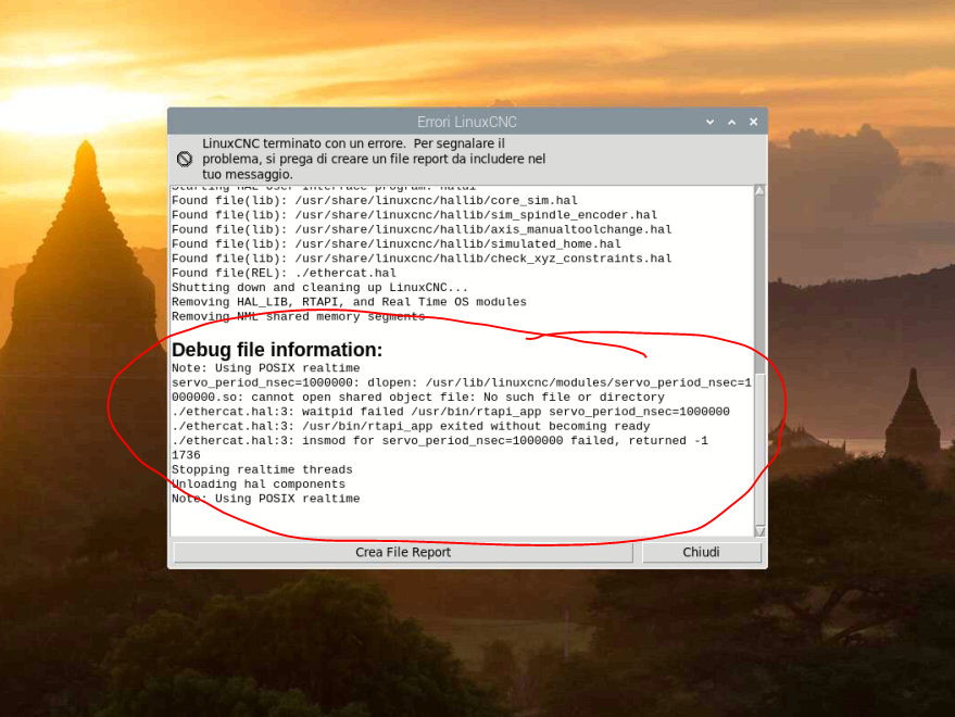

The second line instead
loadrt servo_period_nsec = [EMCMOT] SERVO_PERIOD num_joints = [KINS] JOINTS
gives the following error

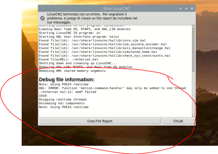

with addf motion-command-handler servo-thread
I get this
I get this

28 Jan 2022 09:25 - 28 Jan 2022 09:27 #233357
by db1981
Replied by db1981 on topic Stepper motor not running (Linux CNC + EtherCat + RPi 4)
your problem:
you are using one of the preconfigured sim configs. Hal files are all loaded in the order the are placed in the ini file. And the loadrt and addf insides , are all added in the order they placed in the hal file.
In your case ethercat.hal is loaded as last hal file , and all functions are placed at the end of the realtime thread. This will never work.
Get rid of the core_sim. hal and put the ethercat.hal in the first position, add the neccesary parts like motion etc. to the ethercat.hal , to get an clean function running order.
If you have done this, and got linuxcnc to start:
-First check if the communication works. "ethercat slaves" command, all slaves have to be in op mode.
-then set the enable pin from an cia component and check if the drives gets enabled. (normaly you will hear some pwm noise....)
-if this works, you can start to send pos oder velo commands.
Last edit: 28 Jan 2022 09:27 by db1981.

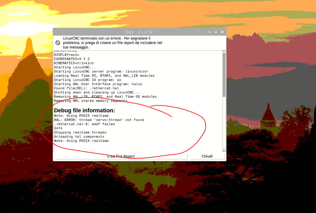

- Dj Junior
- Posts: 33
28 Jan 2022 09:44 #233359
by Dj Junior
Replied by Dj Junior on topic Stepper motor not running (Linux CNC + EtherCat + RPi 4)
- db1981
- Posts: 790
- Thank you received: 276
28 Jan 2022 10:25 #233360
by db1981
thats because the servo-thread is created in this line : #loadrt servo_period_nsec=[EMCMOT]SERVO_PERIOD num_joints=[KINS]JOINTS
you have to put this in the ethercat.hal
- Dj Junior
- Posts: 33
28 Jan 2022 10:33 - 28 Jan 2022 10:33 #233361

- db1981
- Posts: 790
28 Jan 2022 10:38 #233362
by db1981
something missing:
loadrt [EMCMOT]EMCMOT servo_period_nsec=[EMCMOT]SERVO_PERIOD num_joints=[KINS]JOINTS
take this line
take this line
