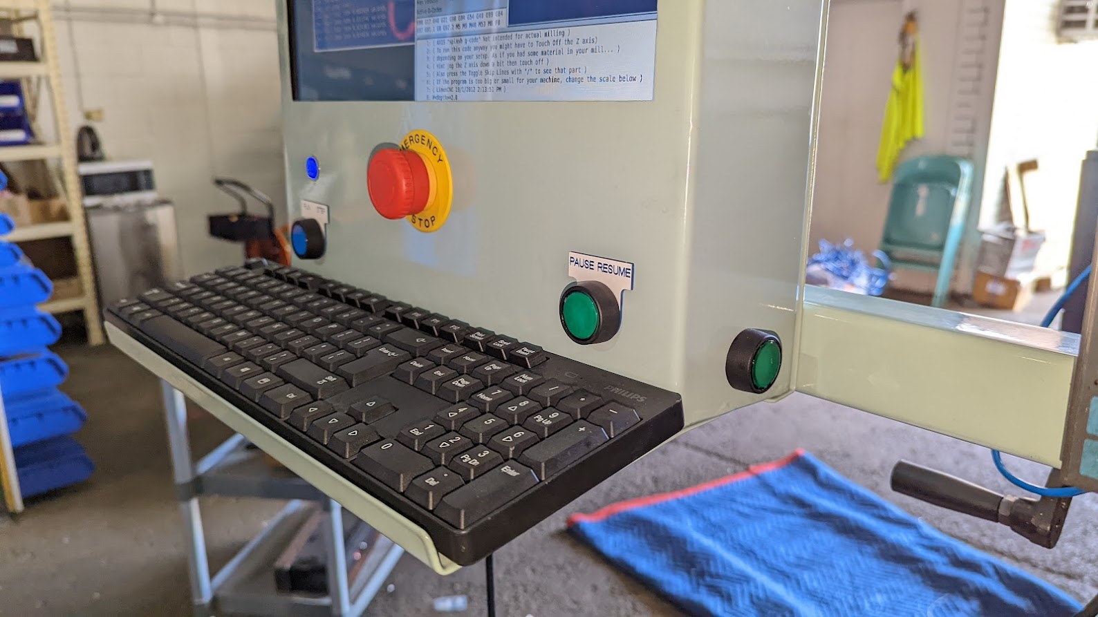

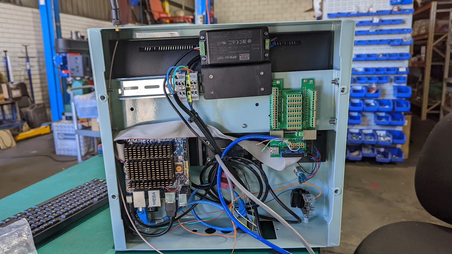

Hakan, thanks. I built a pi with debian 11.2 today and installed linuxcnc from a .deb Steffan Moller made recently but my config needs more work.
Is it a viable ethercat master? I noted you replaced it in one of your youtubes.
Robert, yes its a shame the Odroid H2 was canned due to lack of chips.... I haVE it tucked away in a HMI unit I built...
