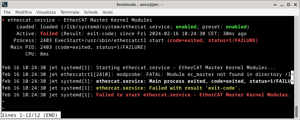

16 Feb 2024 10:15 #293494
Replied by rodw on topic Ethercat installation from repositories - how to step by step
This is a different error so something has changed.
Its saying ec_master cannot be found but the full line is cut off.
If you have built from source, the location is different to using the repositories.

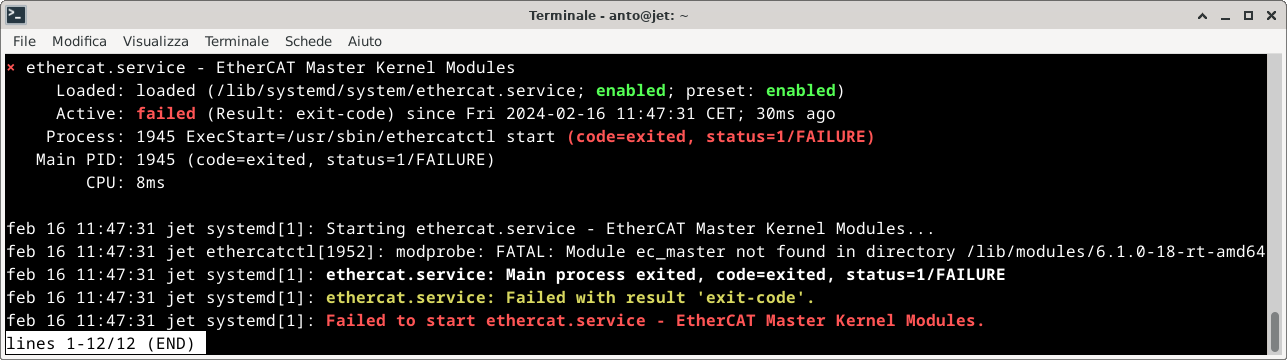

16 Feb 2024 10:57 #293498
by jjdege
Replied by jjdege on topic Ethercat installation from repositories - how to step by step
- jjdege
- Posts: 127
- Thank you received: 38
16 Feb 2024 16:56 #293525
by jjdege
Hi rodw
I solved it by going back to linux-image-6.1.0-17-rt-amd64
work!
I install linux-image-6.1.0-18-rt-amd64 still error
I don't know, maybe the work of recent times
Thank you
sudo apt remove ethercat-master libethercat-dev linuxcnc-ethercat
sudo apt install ethercat-master libethercat-dev linuxcnc-ethercatwork!
Thank you

17 Feb 2024 22:16 - 17 Feb 2024 23:03 #293660
by igh-vh
Replied by igh-vh on topic Ethercat installation from repositories - how to step by step
Have you triedto rebuild the ethercat modules after upgrading the kernel? And are the corresponding headers also installed (linux-headers-6.1.0-18-rt-amd64)?
sudo dpkg-reconfigure ethercat-dkms
Last edit: 17 Feb 2024 23:03 by igh-vh.

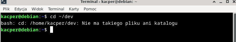

- Rojs0nik
- Posts: 2
25 Feb 2024 17:29 #294411
by Rojs0nik
Replied by Rojs0nik on topic Ethercat installation from repositories - how to step by step
Hello everyone,
Can anybody help me because when I typeit says that there is no such file or directory
cd ~/devPlease Log in or Create an account to join the conversation.
- Posts: 12128
- Thank you received: 4140
25 Feb 2024 19:12 #294432
Sorry, I missed a command
mkdir ~/dev
I amnot sure where scott is with his cia402 support as this may become redundant.
mkdir ~/dev
