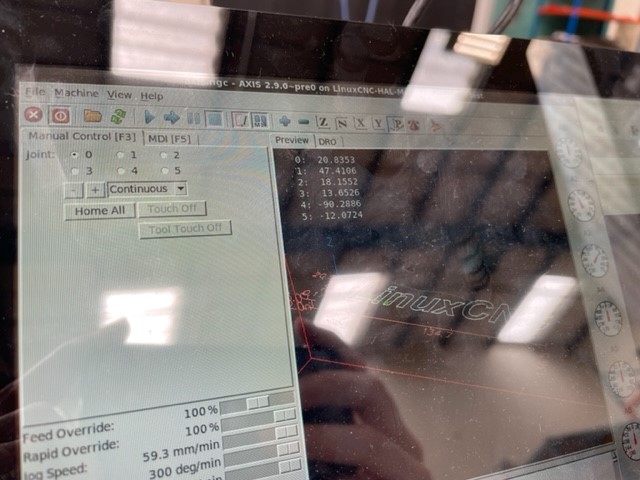

19 Jul 2022 12:07 #247760 by ftree
Replied by ftree on topic EtherCAT driver for a 6 axis robot
Hi!
I am a little over my head setting up LinuxCNC with the Meca500 robot.  I am looking for paid help as I am at impasse.
Is there anyone on here able to look at my LinuxCNC ini and hal files for a fee?
Here are my LinuxCNC project files
github.com/djsftree/linuxcnc-ethercat/tree/master/wip-meca500
I am struggling with the pid feedback, estop setup, axes setup, following errors when attempting to jog.
The only thing that appears to work so far are the six encoders correctly reporting the joint angles.
Image attached.
Some barriers to my thought and progress.
1).  When coming out of estop and to activate the robot I need to send the following sequence with a few 10ms pause between each.  How do I so that and where in a HAL LinuxCNC friendly way?  I can do this manually using the "HAL Configuration" buttons.
lcec.0.Meca500.ctrl.deactivate 1
lcec.0.Meca500.ctrl.activate 1
lcec.0.Meca500.ctrl.home 1
The robot activation can be check with
lcec.0.Meca500.status.activated
all joints of the machine are then homed by the robot firmware - status check by
lcec.0.Meca500.status.homed
If anyone can help I would be much appreciated.  Like I said, I'm happy to pay for your time if you think you can help.

19 Jul 2022 15:41 #247771 by ftree
Hi!
So, without any PID and just using the motion controller outputs
joint.0.vel-cmd => lcec.0.Meca500.vel-cmd.a1
joint.0.motor-pos-fb  <= lcec.0.Meca500.encoder.a1
I was able to jog each axis ok (with following error after a few seconds).
At power-up, the Meca500 knows the approximate angle of each of its joints, with a couple of degrees of uncertainty. To find the exact joint angles with high accuracy, each motor must make one full revolution. This motion is the essential part of a procedure called homing. During homing, all joints rotate simultaneously. Each of joints 1, 2 and 3 rotates 3.6∘, joints 4 and 5 rotate 7.2∘ each, and joint 6 rotates 12∘. Then, all joints rotate back to their initial angles. The whole sequence lasts a few seconds.
Initially (at application startup) clear both the MoveID and SetPoint fields.
setp lcec.0.Meca500.motion.move-id      0
setp lcec.0.Meca500.motion.set-point     0
To start moving the robot
setp lcec.0.Meca500.vel-command        21
setp lcec.0.Meca500.motion.set-point     1
lcec.0.Meca500.vel-cmd.a1 thru a6 (degree/sec as REAL float)
To stop the robot, you must reset
absolute encoder positions (degree as REAL float) are read from
lcec.0.Meca500.encoder.a1 thru a6
joint velocities (degree/sec as REAL float) can be read from
lcec.0.Meca500.velocity.a1 thru a6
REAL floats was made possible by this commit
github.com/sittner/linuxcnc-ethercat/pull/114
