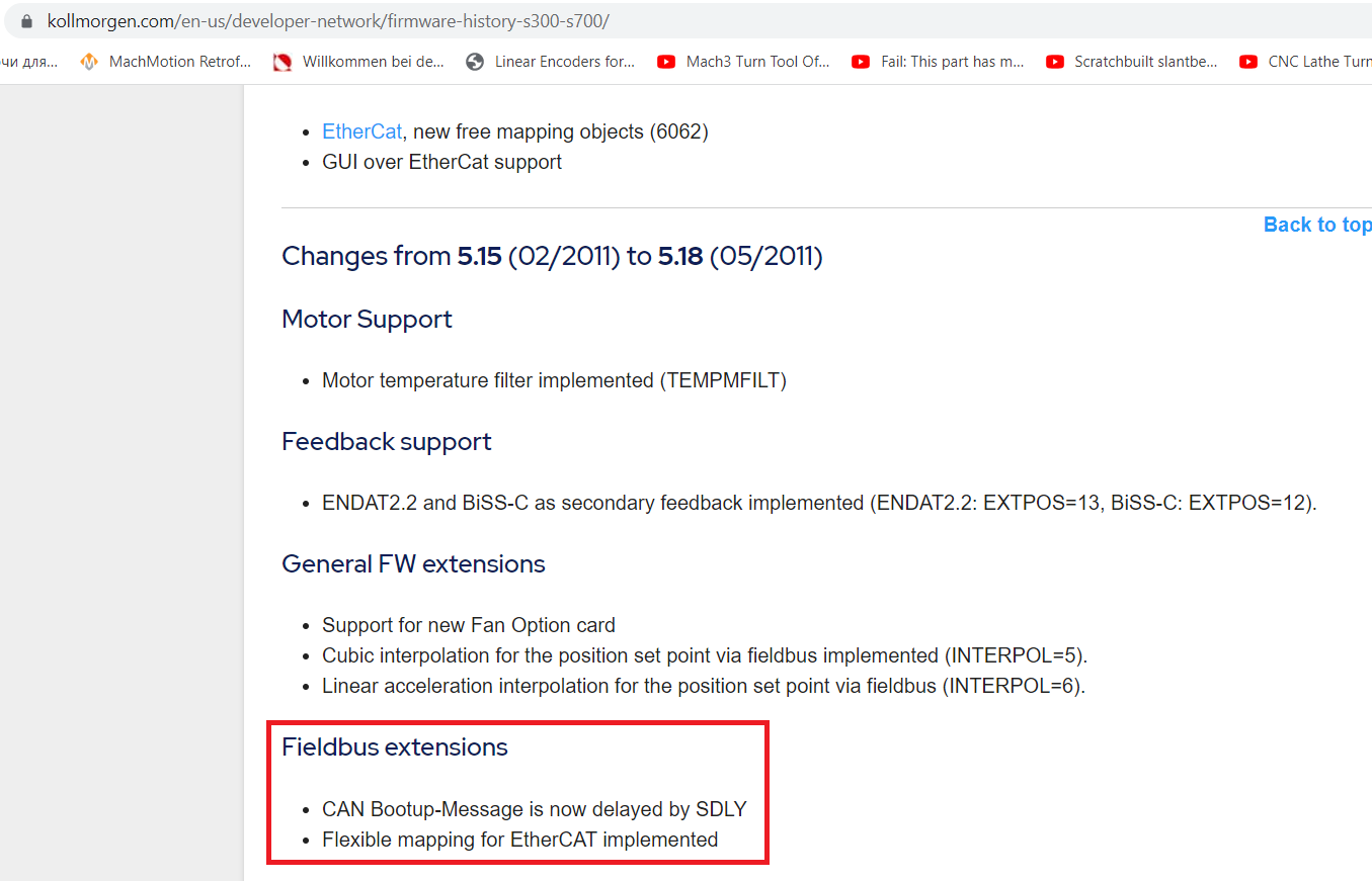

if somebody is still interested in running older kollmorgen stuff over ethercat, I have done several succesfull steps. But from beginning it will be great to read several words from this greenhornview poor described manual .

Drivers have for development reasons several EEPROM configurations and just two of them are supporting
flexible mapping PDOs. If you have working driver with hardware 04.10 and newer and software 05.16. You have to
download manufacturer .xml file where are everything written.

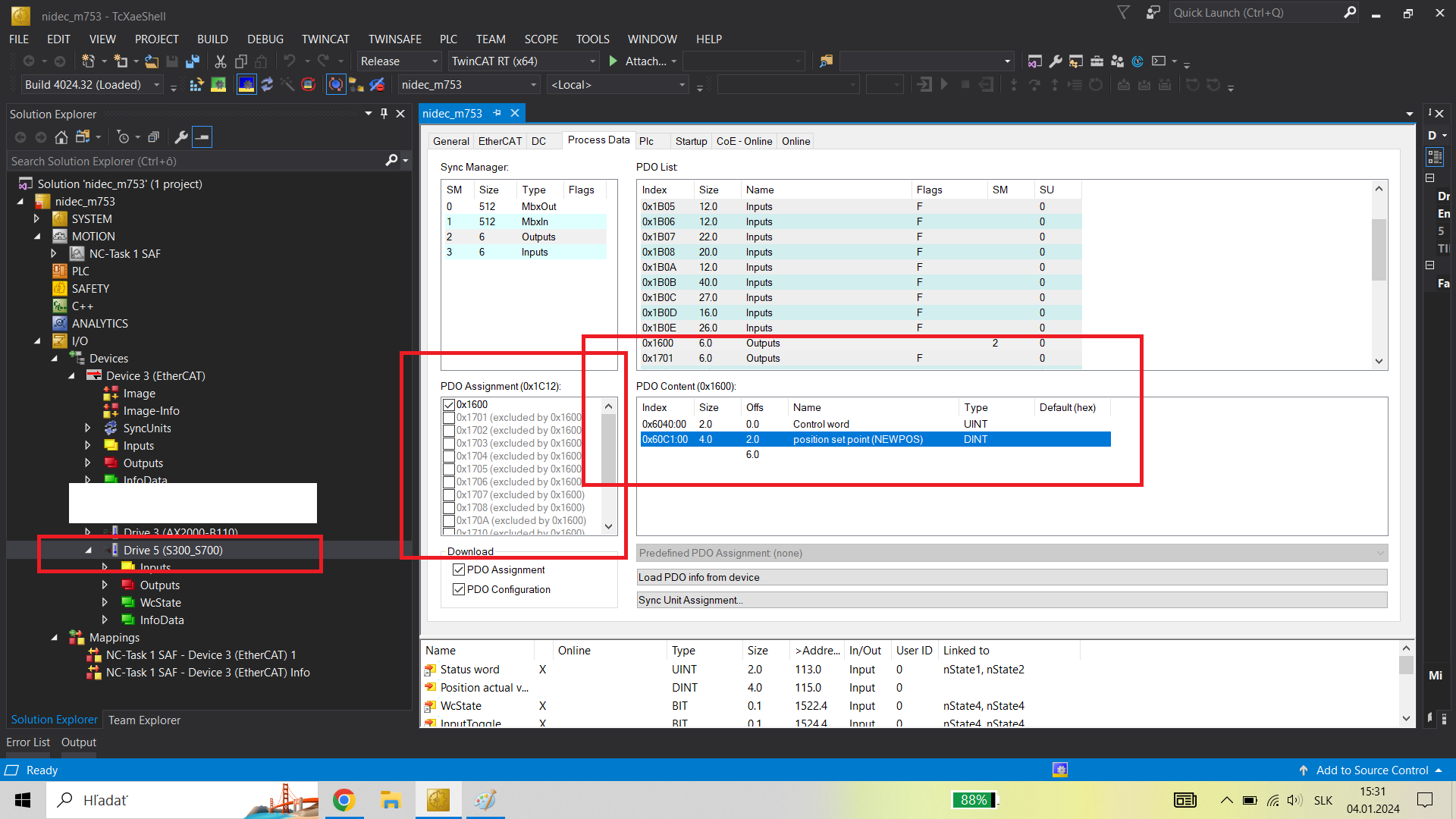

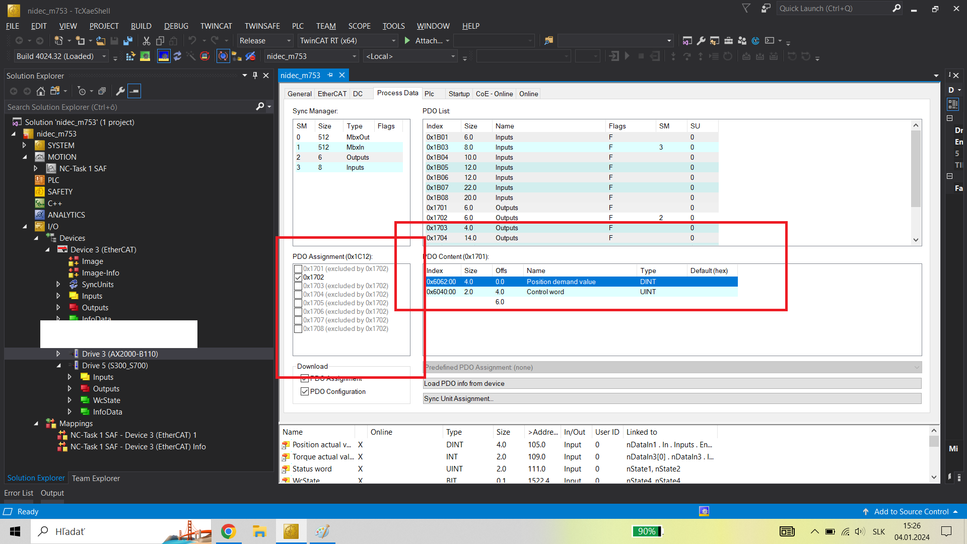

I have Beckhoff AX2006 drivers. What do you think, will be possible to run it with your configuration?

04 Jan 2024 14:39 #289784
by endian
Replied by endian on topic Kollmorgen S300, Danaher S300, telemecanique lexium 15 stuff over EtherCAT
hi,
it will defenetelly can control in the predefineted PDOs.. (*but you have to write demandPosition or demandVelocity component which will transfer datas in the right format to your stuff...*) Flexible mapping PDOs easy probably not, because they have not flexible mapping PDOs and working with demand position/velocity/tourqe control not with constant synchronised stuff... They are great in analog mode.. resolver at motor and linear scale at axis.. it has 2 feedback connectors and possibility to emulate TTL RS422 signal from both of them to the control by predefinated setup over Software DRIVE.EXE ... which can be installed under linux by my step by step guide.
do you have ethercat cards for them yet?
regards foxington
regards foxington

05 Jan 2024 11:57 - 05 Jan 2024 11:58 #289853
by kenedy1
Replied by kenedy1 on topic Kollmorgen S300, Danaher S300, telemecanique lexium 15 stuff over EtherCAT
Yes, I have 3 pc AX2006 and 2 pc AX2020 with siemens motors and B110 EtherCAT cards. I have tried this drivers in past, they works in DC and VELOCITY MODE with predefined PDOs, PID control loop in Linuxcnc. But periodically after 5 - 10 seconds ETHERCAT lost frames, working counter error happens and driver control loop make a random moves. I can't figure out where is the problem. Have you any idea how to solve this problem?

05 Jan 2024 12:29 #289856
by endian
hello,
lets a look at DC synchronization configuration. It should not be as default. It should be larger then "300" nanos
It is too old hardware to run it with all ethercat stuff, from my point of view... it was developed before CIA402(canopen standard). I think
they are no supported from any manufacturers in the world at all... I had terrible problems with the newer but just obsolite S300/S700s.. I broke a stick over them and build just single machine over ethercat... I burned off eeproms(till I found how to overwrite them in the right way) of two ethercat cards B110 from beckhoff .. they have least 5 types of eeprom config and noncountable count of hardware and software revisions which are different in many things..
I have many of S300 which should run over ethercat on the my rack but I do not have a ethercat cards... pitty :/
they do not have probe function just the homing which was horror to build ... therefore I had to write own hybrid component ds402.comp because of overleaks of non cia402 to new canopen ... there is no documentation at all... Everyone who you ask from beckhoff or kollmorgen put hands away...
Only Pilz are reselling them nowdays but in the price of 3 years car.. because advanced safety... AND for S300 they have not offering ethercat from default... I asking technical support for some help with their PMC tendo DD ... and their was shocked, 2weeks of nonsence questions, how I can control their non ethercat stuff over kollmorgen ethercat stuff
but no worries at all, there are much more better drivers on the market in the 1/5 price...
excuse my verbosity,
regards Slav
