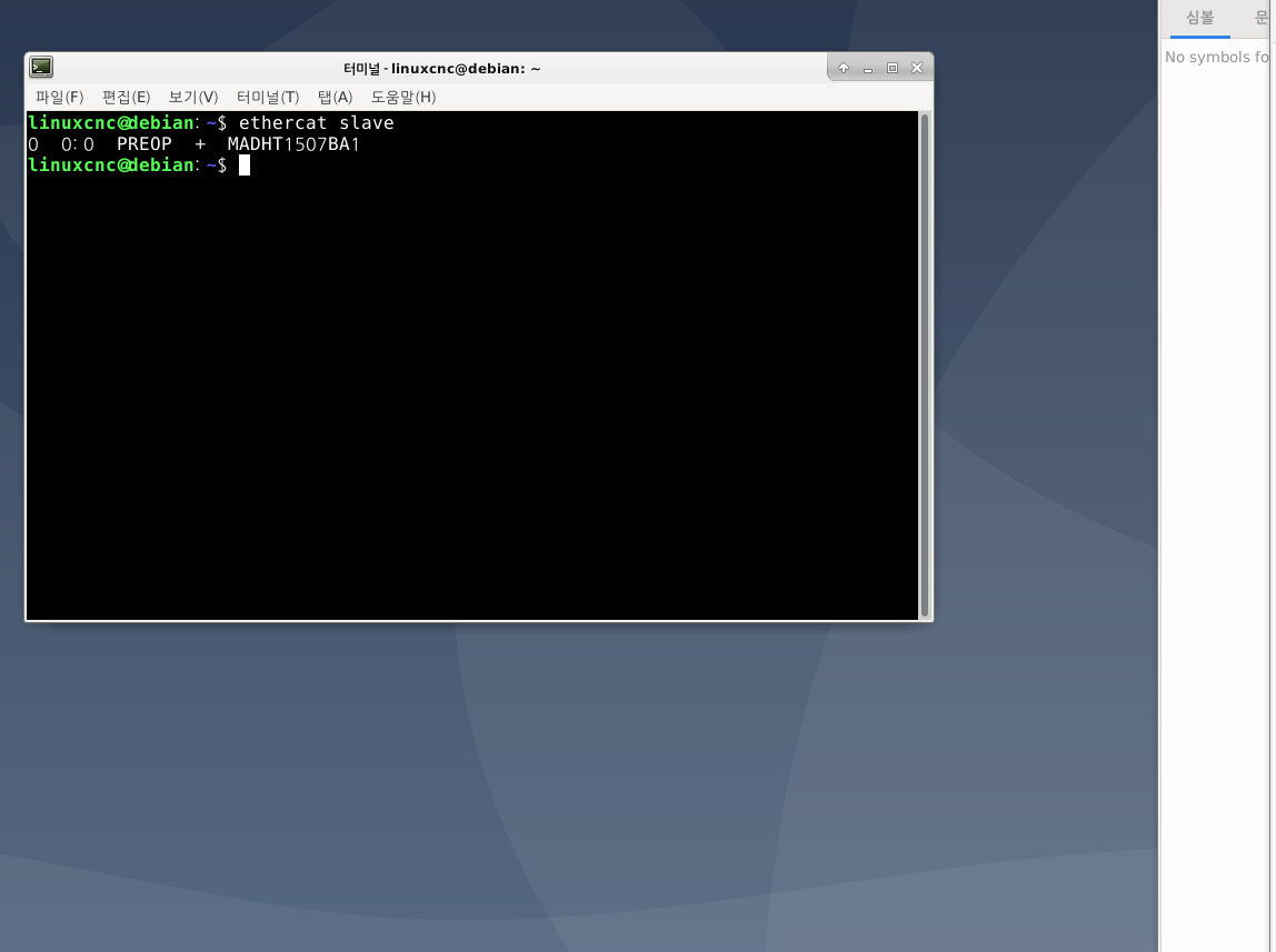

The ethercat slave command is shown below.
" PREOP + MADHT1507BA1 "
hello
We are studying one by one.
Currently connected with Panasonic AC servo motor.
(Please check the attached image)

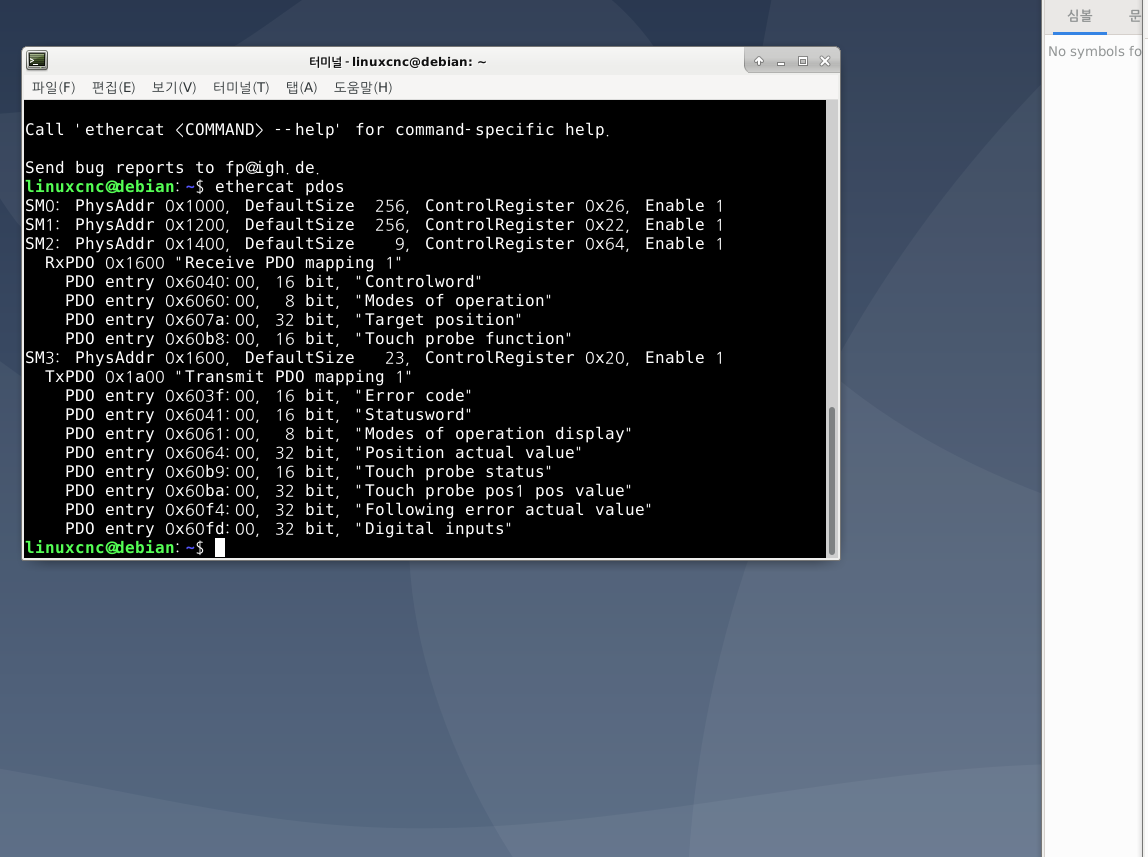

About the ethercat pdos command
The number is printed as shown in the attached image.

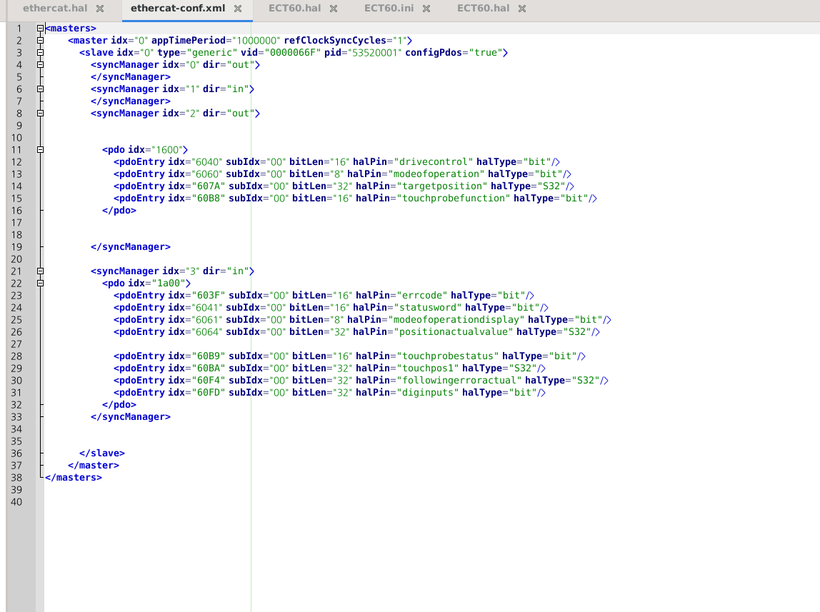

Based on that, I created an xml file.
Could you please look at the HAL file?
I'm totally lost from here

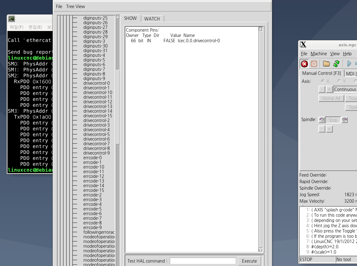

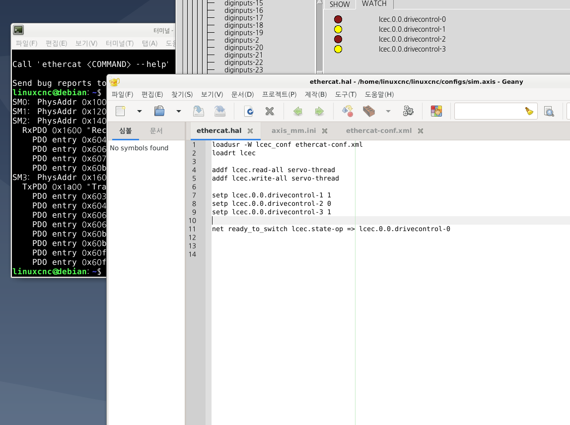

setp lcec.0.0.drivecontrol-1 1 <--
When I tested 1, 0 using this command, I could see the value change in HAL config.
(see attached image)
Now I want to spin the motor. But I don't know which direction
Any help I can refer to please.

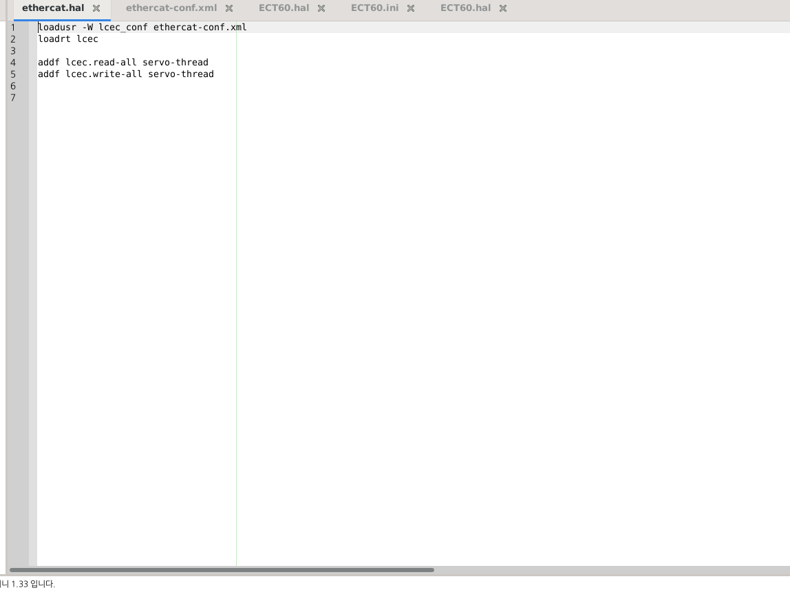

Below is the HAL I created.
loadusr -W lcec_conf ethercat-conf.xml
loadrt lcec
addf lcec.read-all servo-thread
addf lcec.write-all servo-thread
setp lcec.0.0.drivecontrol-2 0
setp lcec.0.0.drivecontrol-3 1
net ready_to_switch lcec.state-op => lcec.0.0.drivecontrol-0
