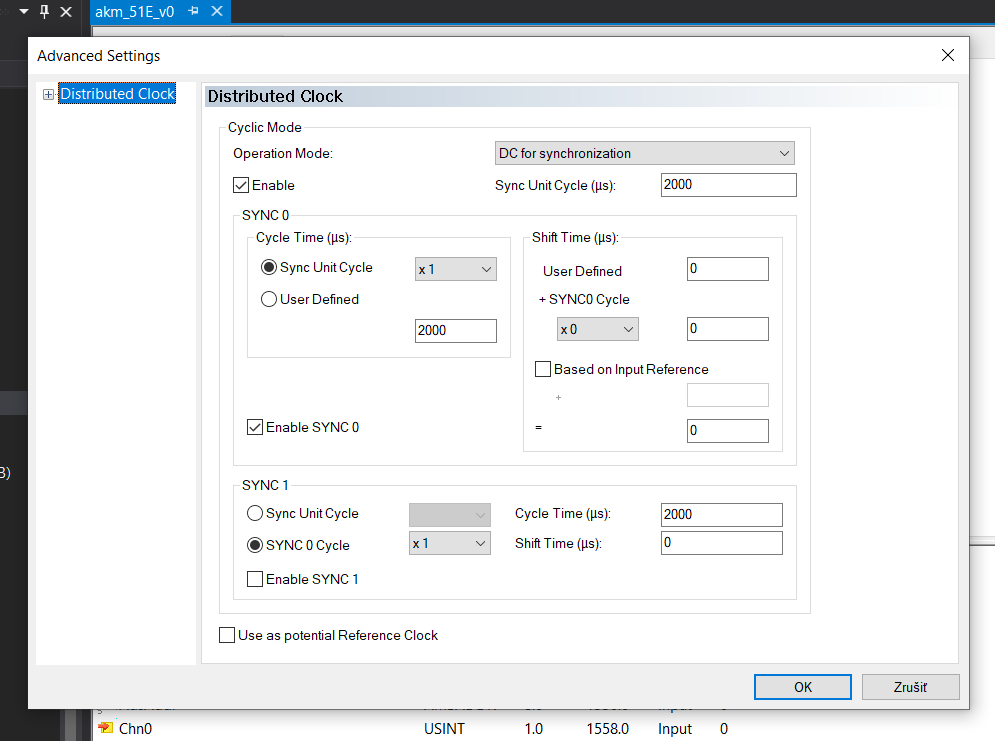

can you post image from twincat witch shows the dc parameters from the slaves ehtercat tab.

01 Dec 2022 18:12 #258242
by endian
Replied by endian on topic DC configuration
by this configuration it has been
it is in phase with DC or???
<dcConf assignActivate="300" sync0Cycle="*1" sync0Shift="0" />it is in phase with DC or???

01 Dec 2022 19:06 #258248
by db1981
Replied by db1981 on topic DC configuration
yes this in phase with every dc cycle.
<dcConf assignActivate="300" sync0Cycle="*1" sync0Shift="0" /> this line should be ok.
what apptimeperiod and servo_cycle you are running?
Your Twincat setup is configured for 2ms / 500hz , if the servo drive is configured for this. It will not run if you lcec set to 1ms/1khz

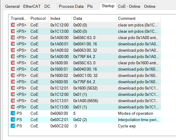

I can create .xml file like below with your assistance now :
is it right write of startup SDO sequence from twincat do you think please?

</masters>is it right write of startup SDO sequence from twincat do you think please?
- db1981
- Posts: 790
- Thank you received: 276
02 Dec 2022 20:50 #258365
by db1981
i've did an mistake in the last post: refclocksynccycles has to be an numberd value.
sync0Cycle = *2 (every second ethercat cycle) may be work to, but is uselles because motion and pids will see the same values for 2 cycles.
Startup Data as SDO Config should work
