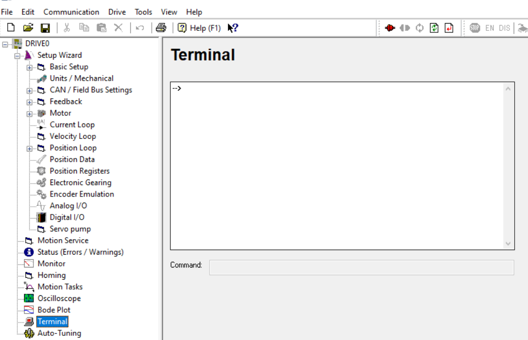

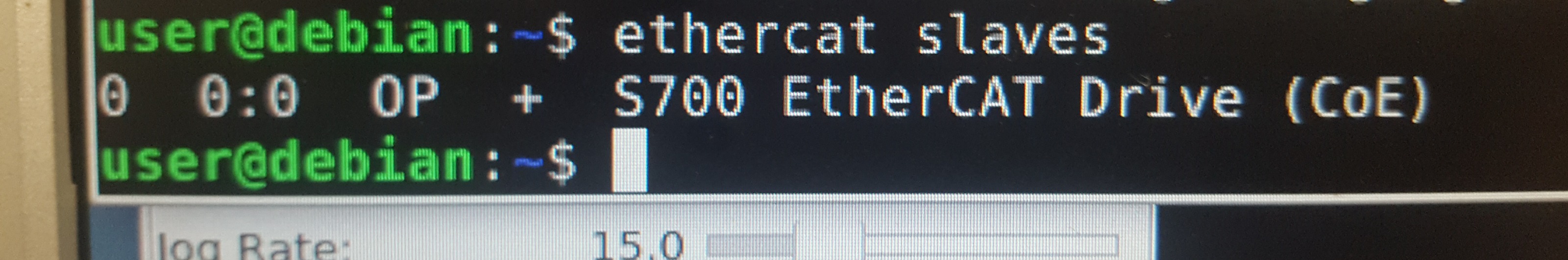

finally we have success, they was more bugs then I expected... drive is in the OPmode after lcnc turned on... attachment 0
There is minimum required configuration for running it in the CSP mode... Attention for this really necessary facts
User have to read or customize settings in the softwate though terminal interface in the DriveGUI software with next commands - PTBASE(in the 250us) and PRBASE(bit resolution per revolution)
For working configuration write in the terminal PTBASE 4 (means 4*250us=1ms == 1 000 000ns of servothread period time) and PRBASE 16(means 2^16=65536 increments per revolution). attachment 1
save all to eeprom and cold start the drive.. after this is driver ready to ethercat run..
After all drive will switch to wait for enable signal.
Minimal necessary .xml config in the attachment 2
I am working on customizing CiA402 component from mr. dominik braun for incremental output and custom OPmode numbers because they are different for older stuff... I will publicate it under DS402 name
enjoy all stuff and work yourself
