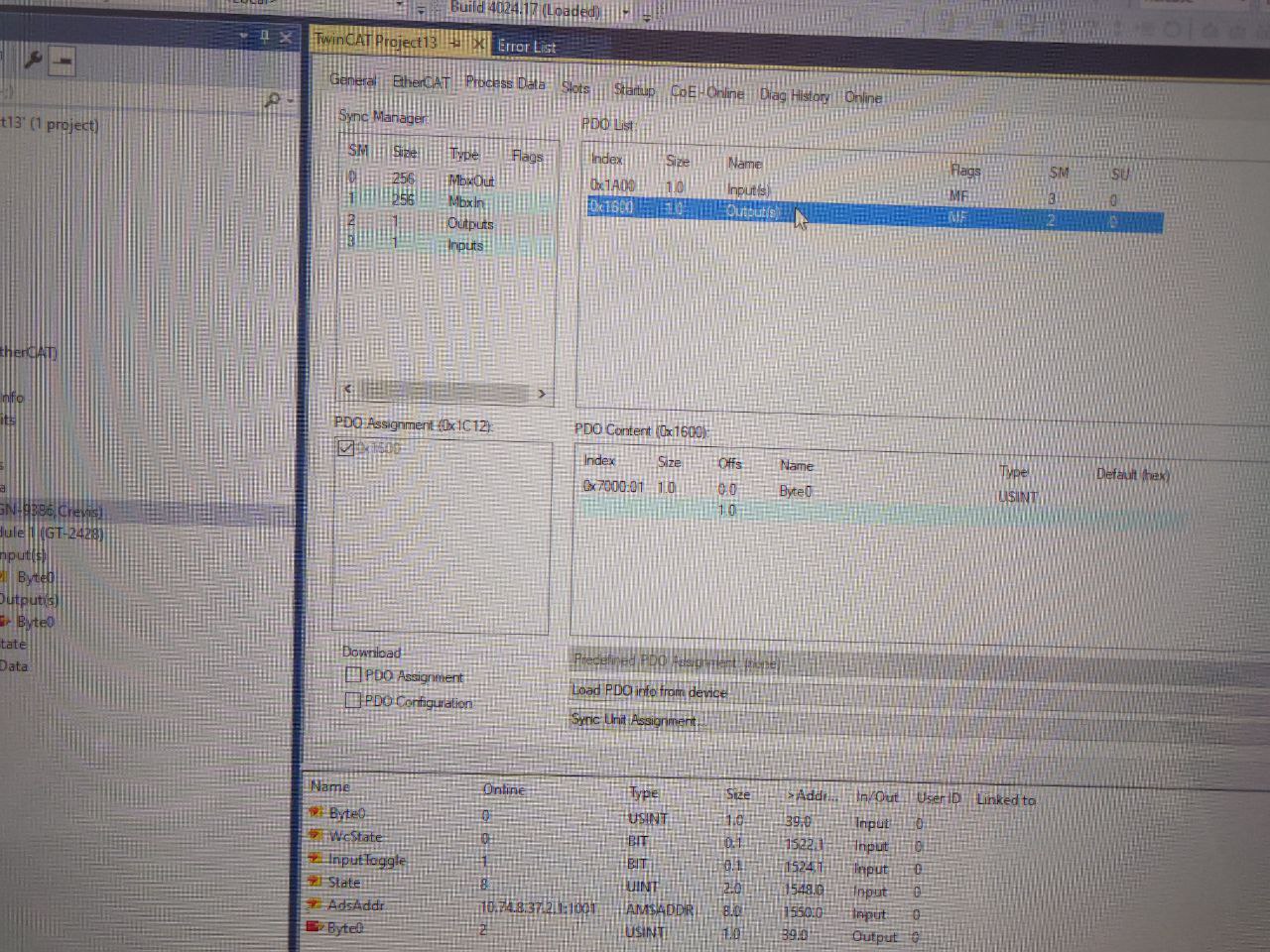

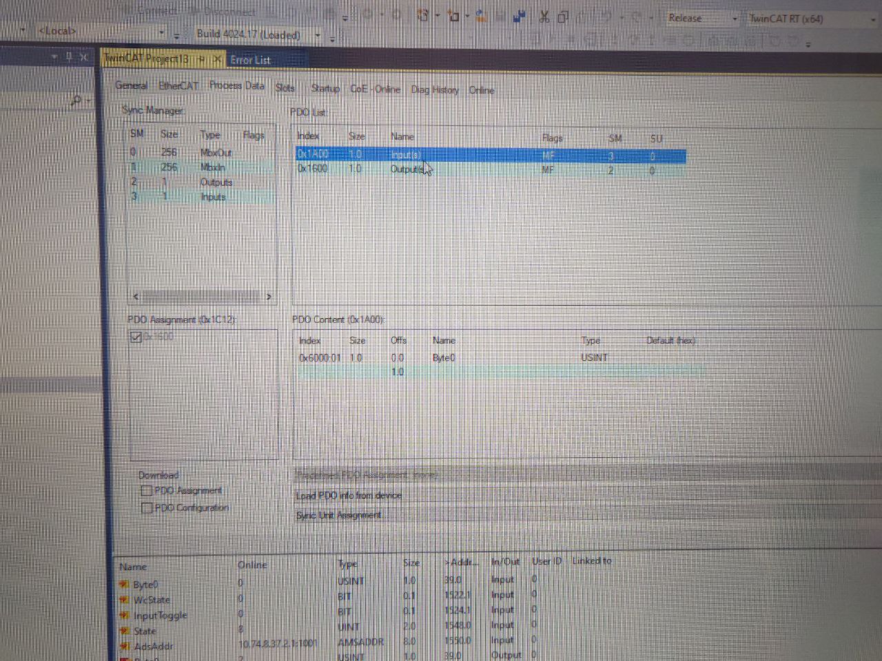

Hi everyone.
I received Crevis equipment for testing
I'm trying to configure it under linuxcnc.
But it doesn't work.
I configured on Twincat - everything works. pic1 pic2

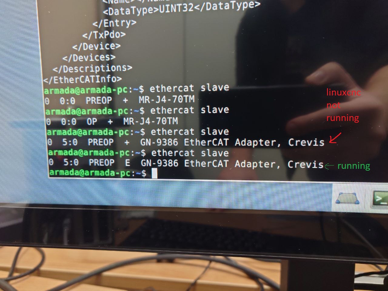

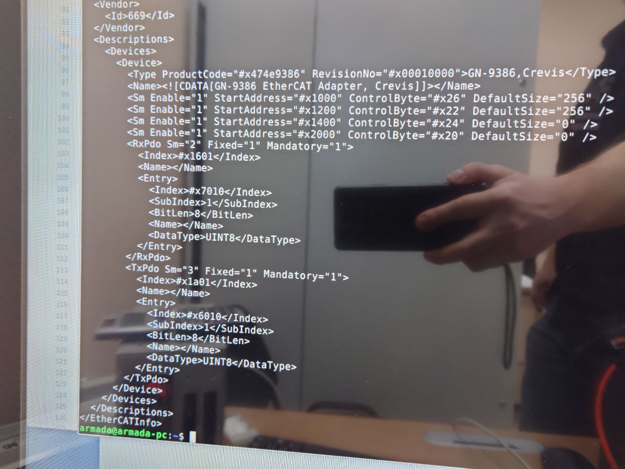

"ethercat xml" get this. pic3
If I use "ethercat download -p 0 -t bool 0x7010 1 1" - work
If I input line to *.xml by <sdoConfig idx="7010" subIdx="01"><sdoDataRaw data="01"/></sdoConfig> - work
But final xml file don't work.
Tell me what I missed?)

fist questian is : if the slave reaches op state (ethercat slaves)
if not , what kind of errors are listed in dmesg....

Linuxcnc start correctly.
If I use "halcmd setp lcec.0.0.outs 1"
Bit in monitor set True, but not in real (LED does not shine)
If add <sdoConfig idx="7010" subIdx="01"><sdoDataRaw data="01"/></sdoConfig> in xml - work too (LED shine)
UPD Yes device is preop. not op

31 Jan 2023 13:10 #263349
by db1981
Replied by db1981 on topic Сonfiguration Crevis
as long as the device is in preop state, pdo communication is not working.
sdo communiction will work at pre op state.
check dmesg for errors.

try without the dc conf line

Perfect!!!
What does this line, which I always set by default, mean?I can't find a good description

infosys.beckhoff.com/english.php?content.../1446575627.html&id=
seems that your slave has no dc clock function.
