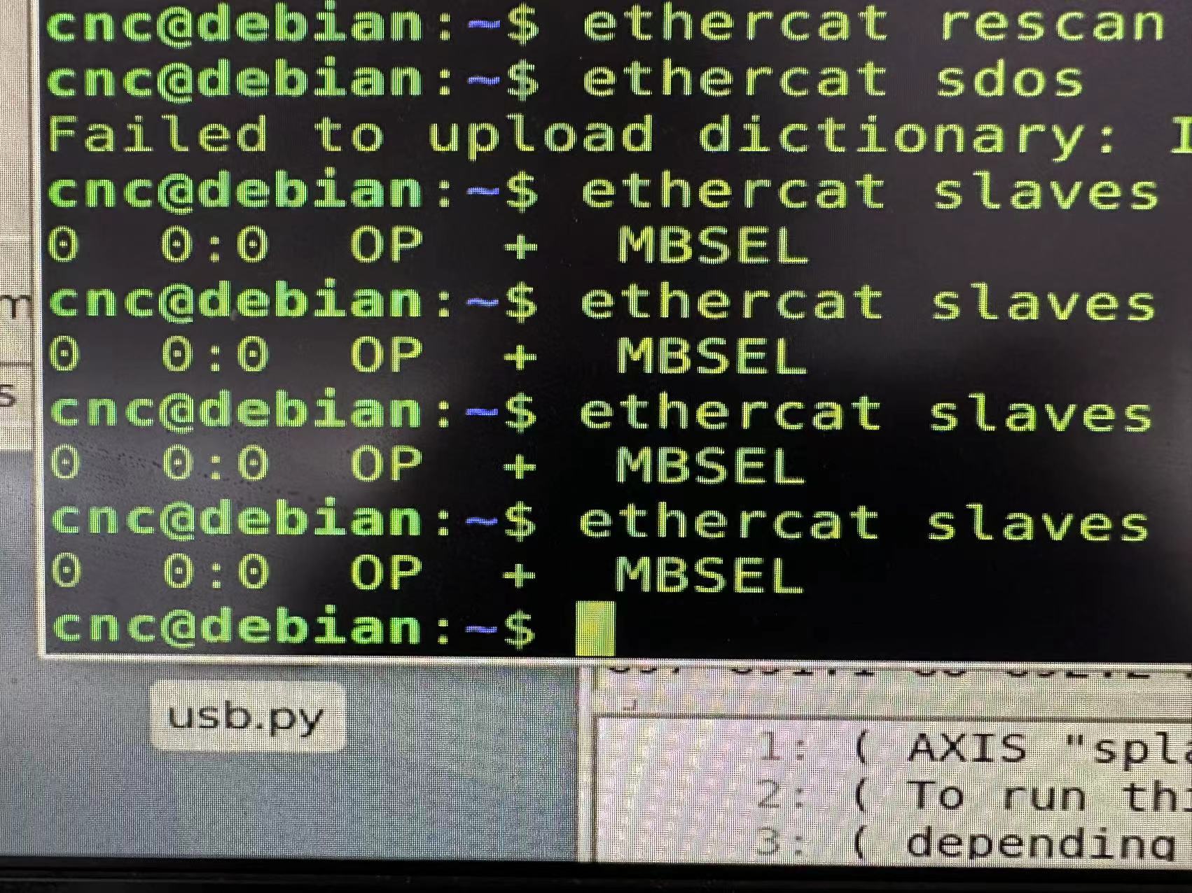

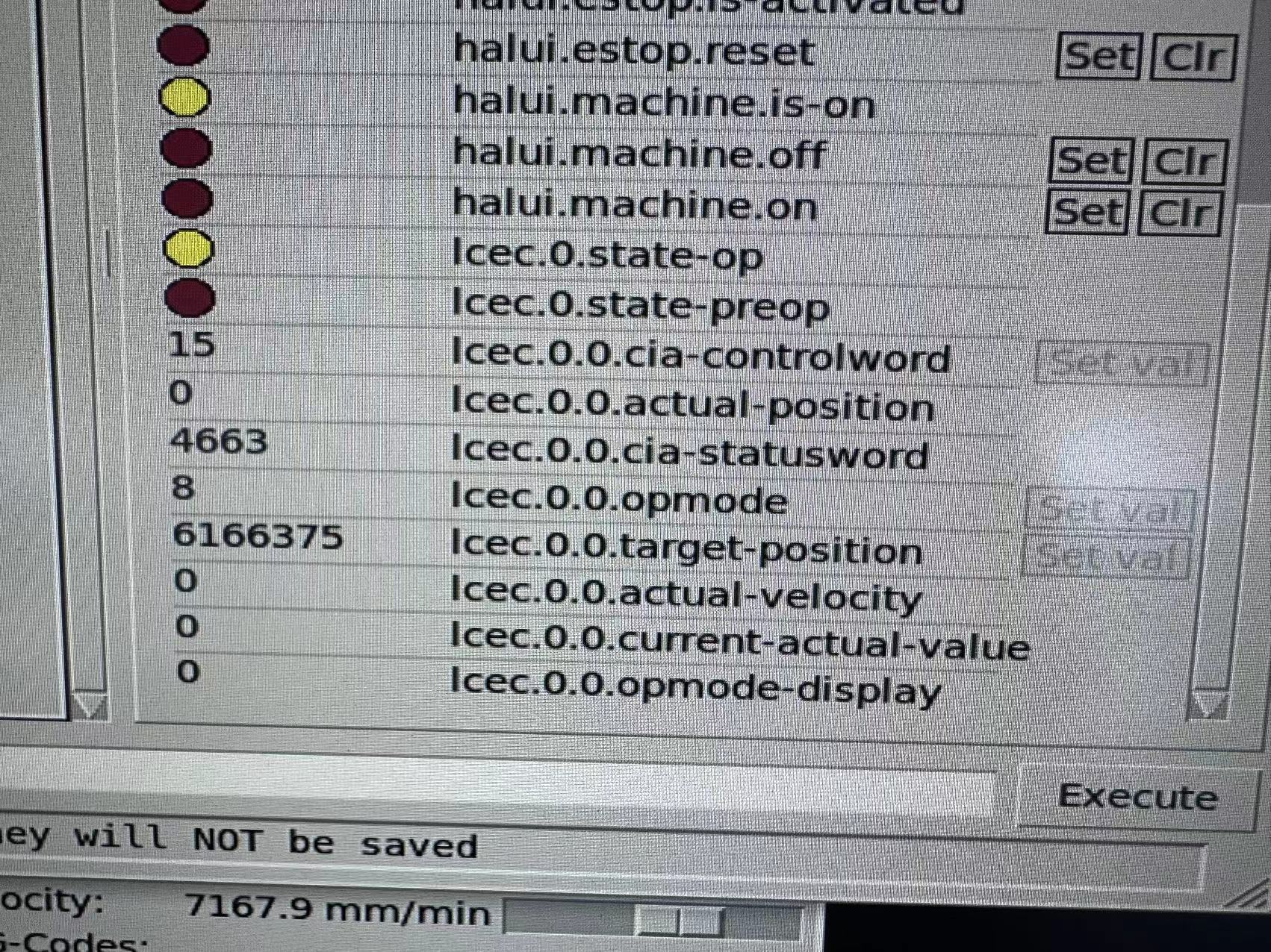

I use a servo drive, the XML file mailbox as follow
<Mailbox DataLinkLayer="true">
<CoE SdoInfo="true" PdoAssign="true" PdoConfig="true" CompleteAccess="false" SegmentedSdo="false" />
</Mailbox>
<Dc>
<OpMode>
<Name>Synchron</Name>
<Desc>SM-Synchron</Desc>
<AssignActivate>#x0</AssignActivate>
</OpMode>
<OpMode>
<Name>DC</Name>
<Desc>DC-Synchron</Desc>
<AssignActivate>#x300</AssignActivate>
<CycleTimeSync0 Factor="1">0</CycleTimeSync0>
<CycleTimeSync1 Factor="1">0</CycleTimeSync1>
</OpMode>
</Dc>
and the XML file I configured in LinuxCNC is the first file.
lcec.0.0 can enter OP mode, but not DC mode. As shown in the second figure, I cannot read information from the slave. Should I change the value of 0x1C23 and 0x1C33, and what value should I change?

I think my config was right. the servo was wrong.
