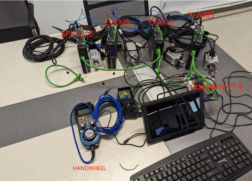

How ethercat contral a servo device spindle? was created by Rabin
Has someone config a spindle using servo device?
I had debugged the XY_AXIS servo, Now them can correct used.
But i can't find some document or HAL or ethercat-config for spindle-axis (servo device + ethercat), someone can help me?

Replied by Rabin on topic How ethercat contral a servo device spindle?
for picture

- Rabin
- Posts: 15
20 Dec 2023 08:18 #288652
by Rabin
Hi, my project has been successful, and I will open source it on GitHub soon. I'm not sure if it will be helpful to you.
