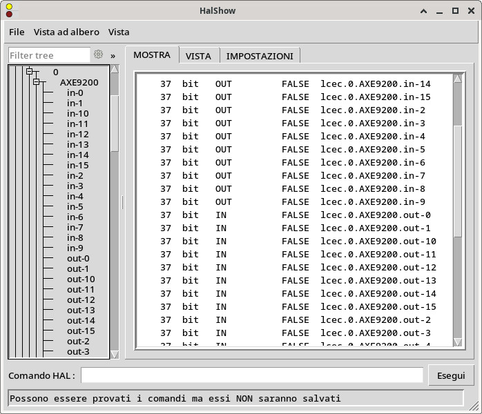

16 Oct 2023 21:45 - 18 Oct 2023 10:10 #283140 by jjdege
HI
try this, I tried it and LNCN sees all I/O

17 Oct 2023 10:49 #283167 by endian
first you should try it without DC maybe. in manual is no note about at all DC.
  <!-- <dcConf assignActivate="300" sync0Cycle="*1" sync0Shift="0"/> -->
second, switch - in / out sync man. direction
  <!-- from -->
  <!-- <syncManager idx="0" dir="in"> -->
  <!-- to -->
​​​   <syncManager idx="0" dir="out">
     <pdo idx="1600"> ....
   <syncManager idx="1" dir="out">
     <pdo idx="1601">
   <syncManager idx="2" dir="in">
        <pdo idx="1a00">
maybe should help

19 Oct 2023 10:06 #283287 by jimwhiting
Replied by jimwhiting on topic Nexcom AXE9200 - Has anyone got one working?
Okay, thanks! I now have them working. The reported direction from ethercat command is misleading... (good suggestion foxington!) They are in fact the other way round.
I've included the working config below, hopefully that will help someone in future.
    <slave idx="3" type="generic" vid="00000752" pid="00009200" configPdos="true" name="AXE9200">
