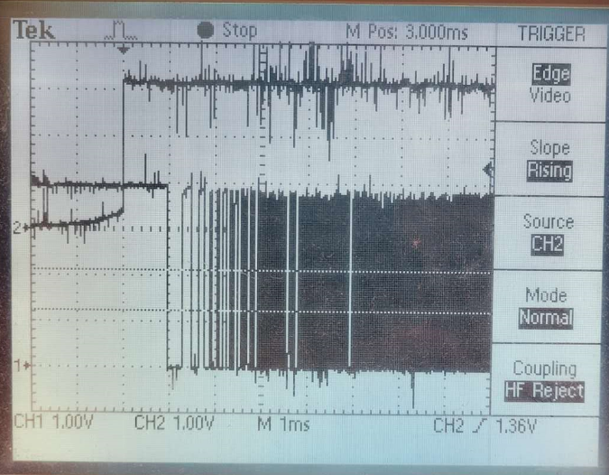

Like I said, the guy does respond. He responded to me asking about that right away, several times. It took them several months to test it but he sent me a response randomly a couple weeks ago:
Hi Justin, sorry for delay on this, we finally had some time to go through this in detail and here is what we found:  We spent some time looking through the firmware and did some testing.  The encoder output response is ~1ms in the testing we performed as you can see below:
 Not quite sure why your controller setup is delayed so much.  Maybe it's the parameters? In our test, the parameters is as below: MAX_ACCELERATION = 127MAX_SPEED = 24OnPosRange = 127Torque Filter = 48GEAR_NUM = 4096LINE_NUM = 2500 The other parameters like the deadzone etc. has no real effect on the encoder output response.  The only parameter that can introduce delay into the encoder output is the MAX_ACCELERATION parameter, so make sure this parameter is set and saved into 127 for fastest response of the encoder output.
Now, I'm personally not quite satisfied with that response as the "controller" lag wasn't the point, the lag difference between the Haimer encoder and the DYN4 encoder output was the point. The scope picture he sent however does show only 1ms lag between the emulated encoder output and the actual analog input rise but for some reason they sent a 1.3v pulse. If that test is good then the encoder output lag itself is actually less than 1ms because the drive had to respond by moving the motor before the encoder had anything to output.
1.3V is the value scope triggered at, rising edge, right side of screenshot.
You are correct, I just glanced at that and thought it was P2P voltage...that scope kinda sux.
