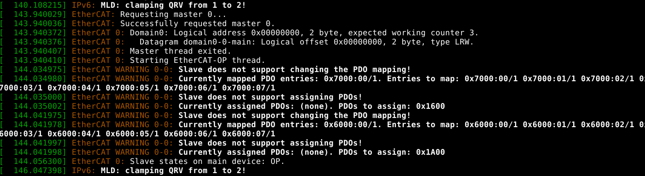

- msantaji1
- Posts: 4
11 Nov 2023 17:20 #285117
by msantaji1
Replied by msantaji1 on topic Non-Beckhoff pluggable IO modules
hello,
check below command output in terminal
sudo dmesg
is it showing slave in OP mode?
refer attached snap
sudo dmesg
refer attached snap
