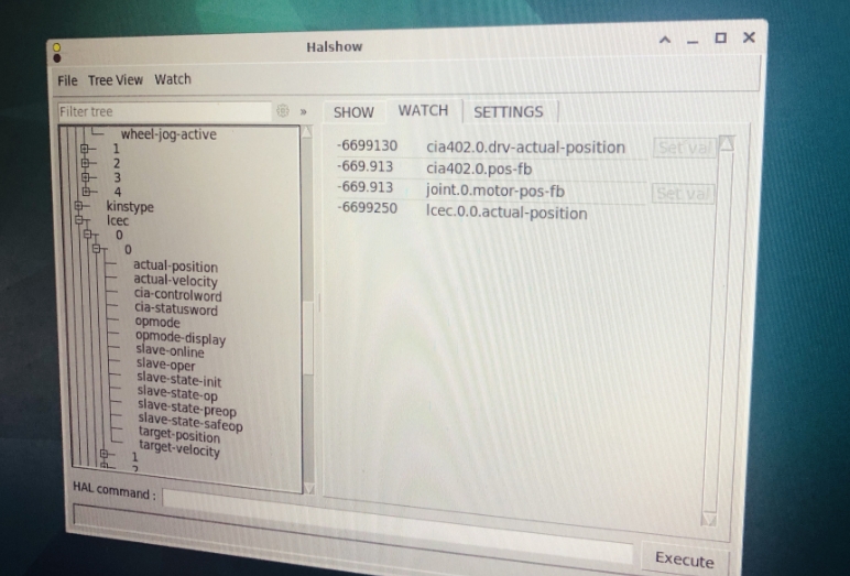

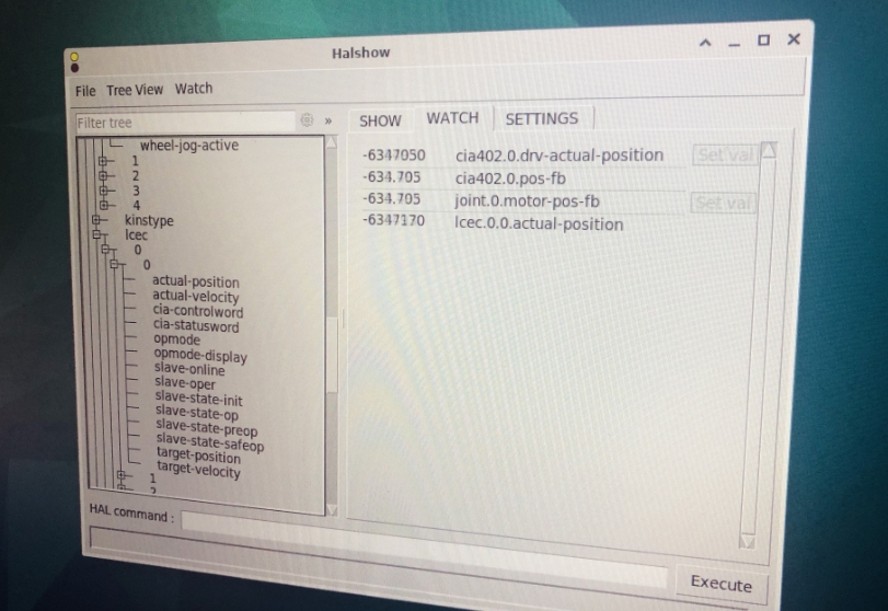

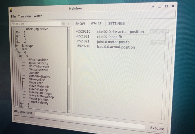

- MakerYang
- Posts: 62
- Thank you received: 17
27 Nov 2023 02:17 #286598
by MakerYang
Replied by MakerYang on topic In using ECR60+NPN(GPIO), I encountered an issue.
I viewed the relevant data using this method, and it appears to be normal. I didn't record a video, but I took a few photos during the zeroing process.
In fact, the zeroing operation didn't produce any relevant errors, and it met expectations. The only issue is that it cannot reflect the current tool position information in real-time on the visualization interface. The 'actual_position' data retrieved from Python remains unchanged, while only the data for 'joint,' 'joint_actual_position,' and 'joint_position' show variations.
I use the following formula in the visualization interface to display and align the tool's position:
This section of the program can provide relevant information and real-time position feedback during normal jogging control and machining operations. The only time it doesn't show any data changes is during the zeroing process.
