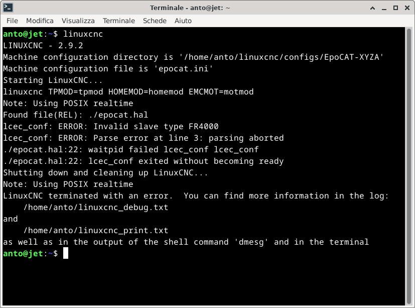

07 Jan 2024 09:52 #290072
by jjdege
lcec_conf: ERROR: Invalid slave type was created by jjdege
- Posts: 12156
- Thank you received: 4149
07 Jan 2024 11:18 #290075
Replied by rodw on topic lcec_conf: ERROR: Invalid slave type
It says there is an error on line 3 of your xml file
please share it
please share it

07 Jan 2024 13:19 - 07 Jan 2024 13:22 #290088
by jjdege
Replied by jjdege on topic lcec_conf: ERROR: Invalid slave type
this is the xml,
but it has always worked
I believe the FR4000 is not included in the repository devices
this is the fork here

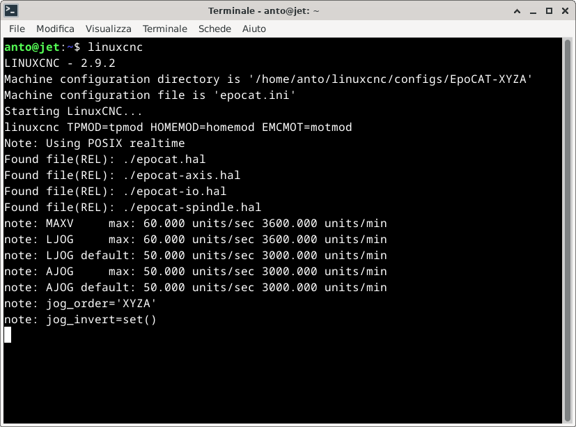

I did some tests, the problem is in the lcec_conf and lcec.so files loaded from the repositories are compiled without the device I use
this is the output replacing them with a backup copy that I had compiled manually
LCNC works
I was wondering if manual compilation has been inhibited and only devices must be used
inserted into the repositories
Thank you very much

- Posts: 12156
07 Jan 2024 20:47 #290142
So the hal driver has never supported this device
I thnk you should clone hte new fork from github.com/linuxcnc-ethercat/linuxcnc-ethercat
and add the driver support and send them a pull request to get it included.
That way it will be included in the igh repository once approved...
The new fork probably will fix your build error

08 Jan 2024 16:45 #290229
by scottlaird
Replied by scottlaird on topic lcec_conf: ERROR: Invalid slave type
FWIW, I merged the FR4000 driver last week: github.com/linuxcnc-ethercat/linuxcnc-ethercat/pull/97.
Hopefully it'll appear in the igh repository before very long.

12 Jan 2024 07:14 - 12 Jan 2024 07:17 #290474
by jjdege
Fantastic! I updated, my device is seen by LCNC.
It doesn't see "generic" devices but I see that work is being done here
many thanks for the work

- scottlaird
- Posts: 136
- Thank you received: 161
12 Jan 2024 18:52 #290522
by scottlaird
I *think* this is all fixed now with 1.5.2 or above. There's a 1.5.3 package in the .deb repository, so hopefully it's easy to upgrade and test.
