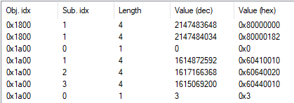

i am a little bit lost with the configuration of CANOpen Devices via EtherCAT.
All other EtherCAT Components are working fine with LinuxCNC but since a few days i am trying to configure Nanotec SMCI-47-S stepperdrivers but i am stuck in the first step - configuring the device with TwinCAT.
What i have done so far:
- Adding EtherCAT coupler and IOs to TwinCAT -> working properly
- Adding the EL6751 and add an CANOpen Network
- Add generic CANOpen Slave and load the corresponding eds File to make the data and diagnosis readable
- I can communicate with the slave and everything goes "OP"
- I need to define the content of PDOs by setting the RX/TPDO Mapping Parameter
- Trying to change the TPDO1 Mapping Parameter results in an Error called: "SDO data mismatch at StartUp" ... "SDO Upload Error 0x1a00 SI2 received value != expected value"
The manual describes PDO mapping as following:
0x1a00 subid 1 does not throw an error because it´s equal to the current config on the motor driver.
I am not sure about the step number 1 - Do i have to put the device into PreOp by Startup SDOs? I think that the device is in Preop while configured by twincat.
Has anyone experience configuring CANOpen devices with CiA402 profile and can give some hints configuring the PDOs correctly?
Thanks in advance

2 years 9 months ago #290798
by bkt
Replied by bkt on topic Ethercat, EL6751 and CANOpen
and your xml file is?

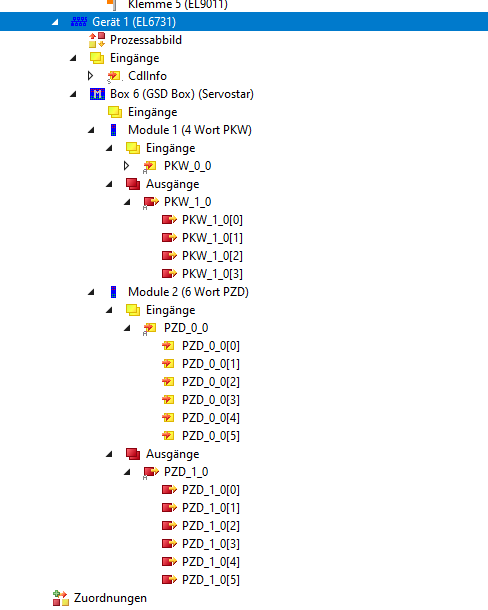

Hello endian,
great, in the end I found somebody who is brave enough to work on the kollmorgen servos! Awesome!
In the appendix, you can find a tarball of my current version. As I said, the drive is somehow communicating with lcnc, but I do have terrible timing issues.
In a nutshell, what I did or tried to do:
set up the EL 6731 using twincat3
lcnc comp
lcnc ini/hal
Here are my issues / todos
Sorry for the lengthy message, but maybe you have some hints on one of the issues. I'll definitly take a look at the other thread and your provided info. Thanks again!
BR Franz
- PDOs for parameter channel and process data
- cycle time 1ms
- use of Ethercat MDP Mapping and upload the config to the EL6731, hence no init commands or startup sdos in ethercat.xml on lcnc side necessary (Not sure here)
- not sure about settings for Distributed Clocks (just left it default, at the moment)
lcnc comp
- use parameter channel to set operation mode <--- velocity
- byte swapping magic (not sure If I got that right)
- scaling the velocity and position feedback (not sure about the scaling numbers, docu is a mess, as you probably know
lcnc ini/hal
- try to use a simple PID loop: position command (from motion, setpoint) position-feedback (from servostar. Here I do have the issue -- due to comm problems this data is very laggy, hence the PID cannot do its job) PID output == velocity command to servostar
- I'm not sure if I correctly use the parameter channel of profibus (PKW) Due to lack of understanding of SDOs, I simply put the PKW as an PDO and initialize the drive on startup -- IMHO it would be better to do that via SDO or some other hard-coded init sequence I'm not aware of. Maybe the constantly send/rec of the parameter channel causes the timing issues.
- I need to parameterize the velocity profile for the position loop. Where to do that? Drive GUI?
- Homing: I think of simply use the built-in homing method of lcnc, the implementation in the hal comp seems to be a bigger time effort. Here a question, in case the homing switch is reached (digital I/O of another EL card) how to set the position feedback of the kollmorgen servo to zero.
- Enable the drive is working, disable is buggy -- need to correct this
BR Franz

1 year 11 months ago #313746
by endian
Replied by endian on topic Ethercat, EL6751 and CANOpen
- PDOs for parameter channel and process data - You have to set SDO via ethercat-conf.xml on startup else there will be a default values I thought
- cycle time 1ms - this is right, default is 4ms which should cause lagging
- use of Ethercat MDP Mapping and upload the config to the EL6731, hence no init commands or startup sdos in ethercat.xml on lcnc side necessary (Not sure here) - yes they are necessary
- not sure about settings for Distributed Clocks (just left it default, at the moment) - you active DC, it is for EL6731 necessary, GC for profibus are possible but they are not implemented in the kollmorgen card yet
- use parameter channel to set operation mode <--- velocity - from character of movement, it is necessary only velocity mode because positionning are over motion tasks in the servo internal..
- byte swapping magic (not sure If I got that right) - I will share my program with them... there it is probably right because it jump to enable and I had a position feedback directly
- I'm not sure if I correctly use the parameter channel of profibus (PKW) Due to lack of understanding of SDOs, I simply put the PKW as an PDO and initialize the drive on startup -- IMHO it would be better to do that via SDO or some other hard-coded init sequence I'm not aware of. Maybe the constantly send/rec of the parameter channel causes the timing issues. - there it is little bit different, it had only one universal canal where datas are mirroring each other - you have to be carrefull and you have to get right answer from driver itself...
- I need to parameterize the velocity profile for the position loop. Where to do that? Drive GUI? - position loop as in the CiA standard are not directly possible because of idea of communication shape itself
- Homing: I think of simply use the built-in homing method of lcnc, the implementation in the hal comp seems to be a bigger time effort. Here a question, in case the homing switch is reached (digital I/O of another EL card) how to set the position feedback of the kollmorgen servo to zero. - it should be tested in the drive gui and then u should run it over op mode 1 with 14 and 15 bit of zsw off ... characteristic have to be done in the driveGUI soft itselft before... I did tutorial of driveGUI installation on the Debian distro before.. lets check them, you should have easier live after
- Enable the drive is working, disable is buggy -- need to correct this -
