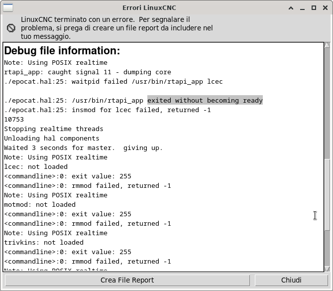

02 Feb 2024 15:09 #292222
by jjdege
Replied by jjdege on topic Git update: 1.14.3
- scottlaird

02 Feb 2024 23:14 #292261
by scottlaird
Replied by scottlaird on topic Git update: 1.14.3
It core-dumped? Hmm. That's not good.
I'll look into it in a couple hours. It's not a very big driver, so it's probably not hard to find.
- scottlaird
- Posts: 136
- Thank you received: 161
03 Feb 2024 00:47 #292264
by scottlaird
I think I found it. Or, at least I found *a* bug that would cause it to core dump. There could be others as well. It should be released as v1.14.3 momentarily.
Apparently we were only at 1.14.2 before, so I mis-named this whole thread

03 Feb 2024 08:35 #292284
by jjdege
Hi scottlaird
awesome that's all OP, you're great
I attach XML
thank you so much for your work
I attach XML
