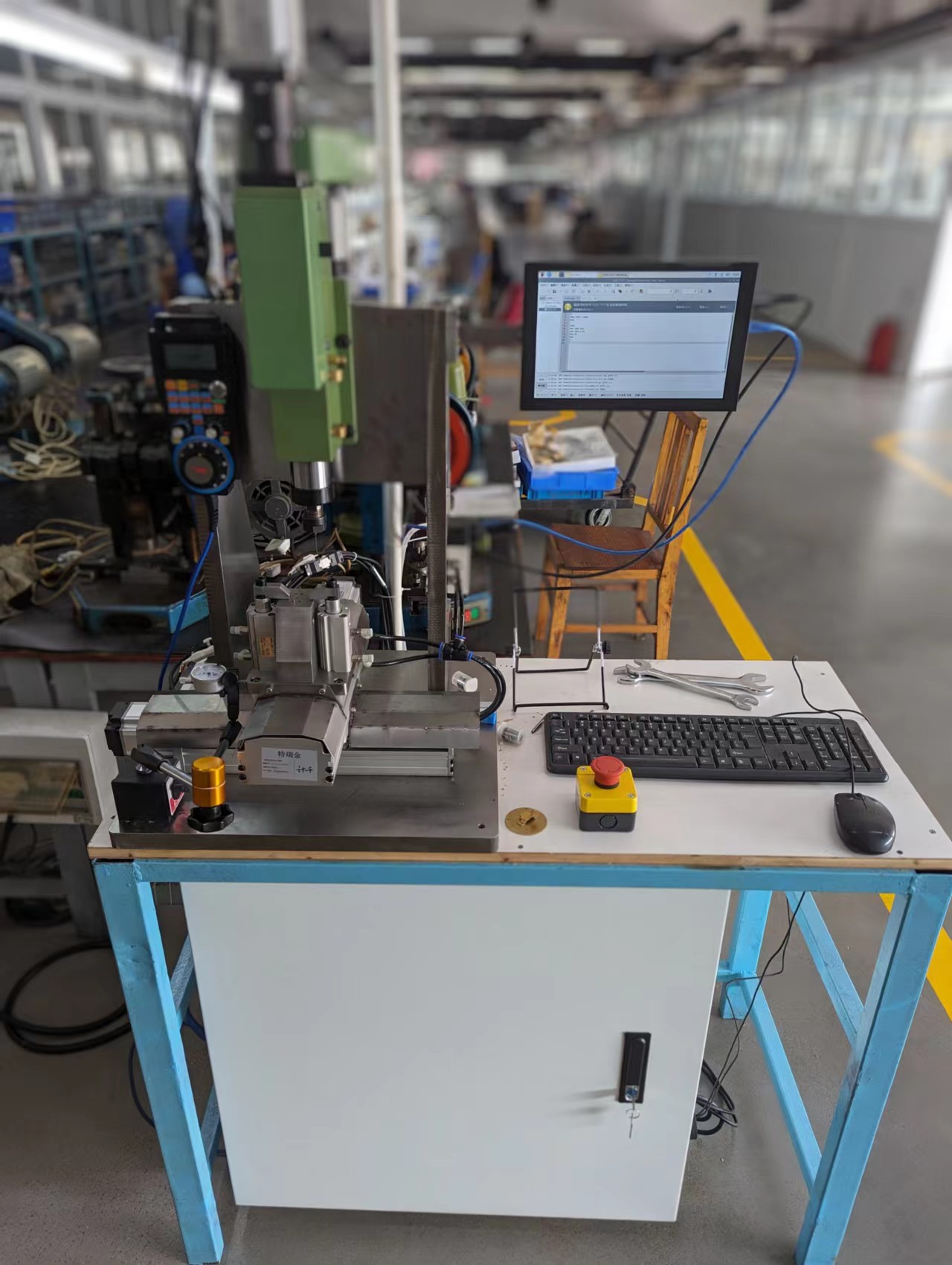

Linuxcnc + raspberry Pi + ethercat project opensource was created by Rabin
PROJECT VLOG: space.bilibili.com/341589947/channel/col...ondetail?sid=1918828
GitHub: github.com/rabin-HE/OPENCNC-J
- Introduction
- This is an open-source integration project based on Linuxcnc. Its aim is to facilitate electrical engineers in using a combination of Linuxcnc + EtherCAT with CIA402 protocol + Raspberry Pi (or X86 - Debian).

Have you managed to work around the strange Beckhoff licence?

Very nice. Try monitors from greentouch. www.greentouch.com.cn/?list_9/
Can you list specifications for your spindle and x,y,z stages?

I don't think there is an issue here for software. If a machine design is used to make a machine to sell for profit, you need to have a company and register for a free license with tthe Ethercat Technology GroupHave you managed to work around the strange Beckhoff licence?

The specific motor and drive models of X, Y, Z and Spindle are indicated in the Project Procedure List.Very nice. Try monitors from greentouch. www.greentouch.com.cn/?list_9/
