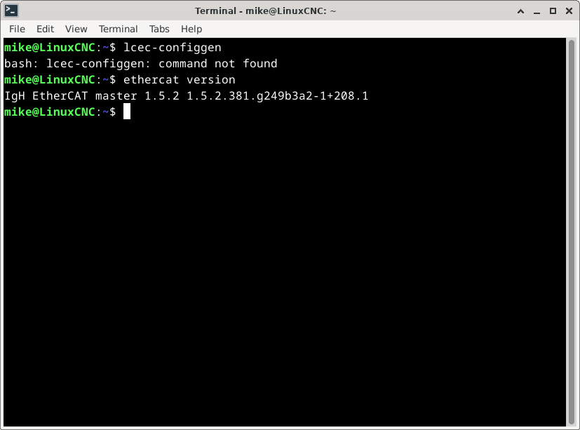

Hi, the config generator looks like a helpful tool. I have one Rtelligent ECT60 stepper drive running and I now need to figure out how to add two Rtelligent RS750E AC servo drives.
I apologize for asking such a simple question, but I am not sure how to run the lcec-configgen. Maybe I don't have it installed. I am clearly inexperienced, so I could be missing something simple.
I appreciate everyone's help on the forum.
I've attached a picture of my terminal and my version of Ethercat. My linuxCNC version is 2.9.2

It's
lcec_configgen
and comes with the linuxcnc-ethercat package. It first appeared a year ago (April -24) so might be too new for your installation.

sudo apt upgrade should upgrade to  the latest Ethercat package as its not linked to the Linuxcnc version
