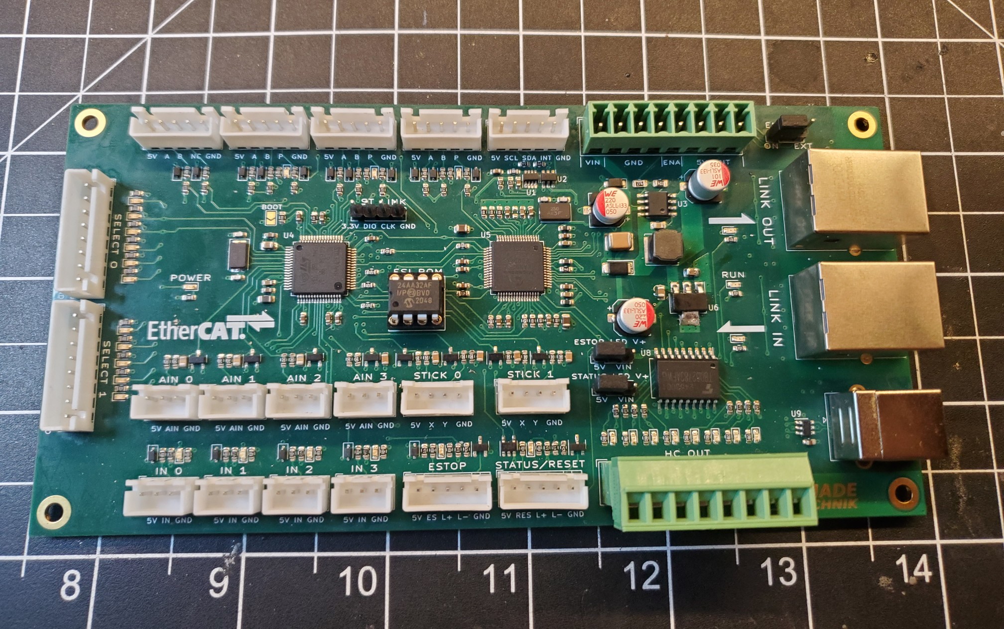

I think you use ethercat or you don't.
That's a fair assessment.
Whether you use Mesa or Ethercat is a matter for personal preference but if you are building a machine for resale customers will expect to see ethercat. The added cost may well be offset by reduced labour in the wiring.
I do agree with what you're saying here, but the machine OEM/professional crowd can keep buying what they're buying. I don't build CNC machines for sale...not in the traditional sense. Then again I'm not so sure it looks all that professional when you open a cabinet and see a bunch of Chinesium....EtherCAT or not. I'm sure it's fine but I don't understand why they always use that font lol....there's something about that font that says "stay away"

It sounds like you're talking about IO for a control panel.....That's literally what I'm making, I mentioned it several times. I already have a 32 button/LED keypad via I2C IO expander, just gotta get the code into the EtherCAT slave device.
That's great. I look forward to when you share the design with the community.
I'm not sure if you are being intentionally argumentative?
In your original post:
Just the Beckoff stuff that's astronomical in cost and some servo drives.
I happened to be working on a PCB with pretty much the same hardware but I was searching for what code is currently out there when I came across that. Glad to see someone's done some of that work. I just thought it was odd that I see alot of talk about EtherCAT but nobody using stuff like this, or modules that don't cost $500 each. Honestly the EtherCAT chip itself has 16 GPIO so a pretty simple EtherCAT IO board can be made for like $20

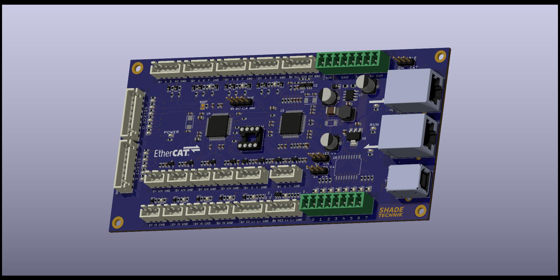

That's not an open design bud, sorry if that was unclear. To clarify, none of the PCBs I'm talking about making are open designs. Most of the stuff I make is only made cuz it goes into something else....and I can't open source that. That's the case with whatever I'm talking about here.
You mentioned making an EtherCAT IO module....If you can do that you can make a keypad, and share if you like. If you post a question and I have an answer I'd be glad to help, PCW has helped me many times when I had a question about something I don't do often. I don't think I've ever asked him for the schematics for a 7i96 tho.
I have some code in LinuxCNC (written for me, not by me), I'll likely have some other relevant open source code to share soon. Just no PCBs at the moment :(
Those control panels you posted can't be made and sold for any less then that, they're industrial panels.....they won't be cheap. I've got a keyboard in my box that cost me $150...that's just how it goes. I do make something that's has the same purpose basically. The EtherCAT PCB I'm currently working on is for that. If I were to sell you this PCB you could make that panel yourself and stick this in it.
Yes I said "IO modules don't have to cost $400"....that's true. I think you get a bit unrealistic with the $3 dev boards. You're quoting my comment about being able to make one for $20 out of context, that's clarified in later posts as I was talking about a vendor. That's actually not quite true as I explained with the costs associated with testing.
All I'm saying is that I'm going to make some things for personal use. If they seem to work out well I am in a position where I can possibly meet the ETG requirements to offer them for sale, and possibly make other devices that make sense to make and sell. That depends on enough interest for me to cover the ETG costs, otherwise I'd just be burning money. By "make sense" I mean they are priced better than most anything else  you can get of that type, otherwise you'd be better off just buying the other thing.

08 Apr 2024 18:32 #297827 by blazini36
Replied by blazini36 on topic Anyone seen this?
About ready to run a prototype...
27 Apr 2024 01:31 #299158 by blazini36
Just waiting on software
