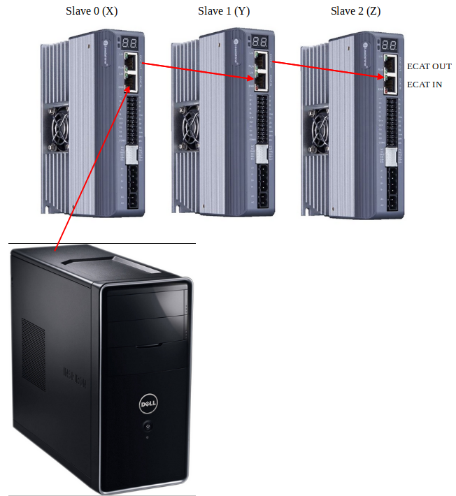

LinuxCNC+3 sets of EtherCAT servo
now I met an issue: axis index error
I installed the EtherCAT servo from X to Z in EtherCAT topology, but when I jog moving X axis, Z motor rotates, jog moving Z axis, X motor rotates

Sounds like your physical wiring is mixed up. Just debug one slve at a time.

Yes, my mistake, it is physical wiring issue.
I use Xinje Ethercat servo(Type: DS5C1K-20P4-PTA), its IN port on the down side while OUT port on the up side. I regarded upside port(OUT port) as IN port wrongly, it works in weird ways.

Just adding my 5 cents. I also had the same issue (3 axis machine with the Z-axis actually moving when I jogged the X-axis on the PC).
I'm using the leadshine CS3E-D1008 and in/out was connected correctly. But the PC was connected to the drive with slave address 2. Motors are wired with slave 0 connected to the X motor, slave 1 to Y motor and slave 2 to Z motor. This cause X/Z to be swapped in linuxcnc.
Ethercat is not ethernet. Order of connecting DOES really matter! See attached picture for correct wiring of 3 ethercat drives for an XYZ machine.
