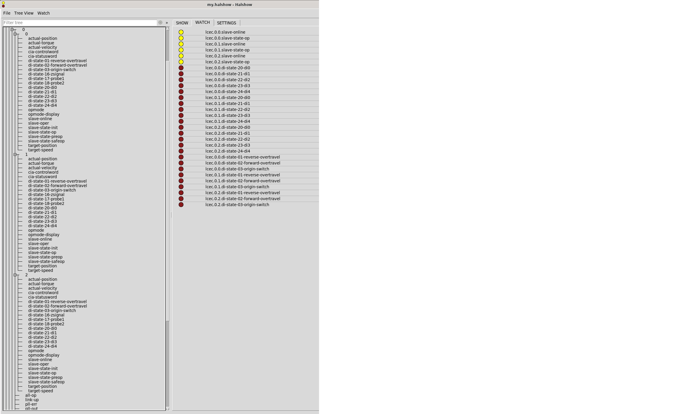

21 Jul 2024 06:26 #305749 by lmclaren
Replied by lmclaren on topic Problems with Lichuan Ethercat servo drive
I have extended the ethercat-conf.xml so I can read the digitial input pins, this is my first attempt so please let me know if there is a better way.

21 Jul 2024 06:30 #305750 by lmclaren
examples of hal show

One thing I noticed is that
ethercat state -p0 PREOP
changes the state of my Beckoff EK1100 instead of the servo drive. By changing p0 to p1, I can change the state of the servo drive to init (1ry) and preop(2ry) but nothing else. I tried changing some zeros to ones in Rob's config but it didn't work.
I have also heard people staying they did stuff using twin cat, but I downloaded it and did some quick googling but I didn't get anywhere.
Is there something else it could be? Could I have missed a step
Thank you in advance
