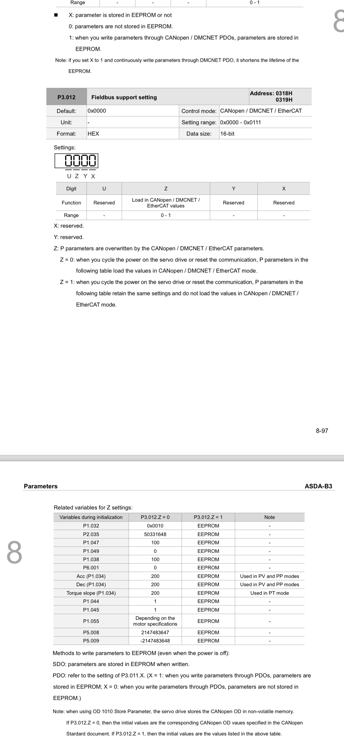

Maybe try saving parameters on the device and see if that helps? It's kind of the wrong layer, but it might trigger the right behavior anyway.
filecenter.deltaww.com/Products/download...0210201.pdf#page=548

24 Apr 2024 07:12 #298971
by zmrdko
Replied by zmrdko on topic esi_write lost after reboot
I tried setting p3.012 to 0100 to use eeprom values, but it did not make any difference

28 Apr 2024 06:26 #299232
by zmrdko
Im in contact with Delta support. The main issue is missing Digital output PDO 60FEh.
I also described issue with sii changes wanishing after reboot and the reply was:
Which data do you need to write? I'm asking because you can't write all EEPROM in B3 servo drives, only the essential ODs. The design of the servo drive does not allow you to have the same data after rebooting, except for the write-allowed ones. So, you may see it like that.

27 May 2024 08:43 #301551
by zmrdko
According to Delta support response, Delta B3 servo drives are not made to store sii permanently.
However after firmware upgrade, the drives are listed with correct name.
