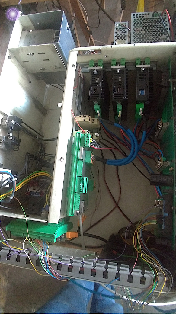

I'm working on a retrofit on the electronics of a small old machining center
the FR400 drives MOONS' SR4plus and DMA860S steppers, with EasyIO as in/out,
the mini center has an ATC and several in/outs are needed, otherwise the FR400 is sufficient for a traditional CNC,
everything works perfectly.

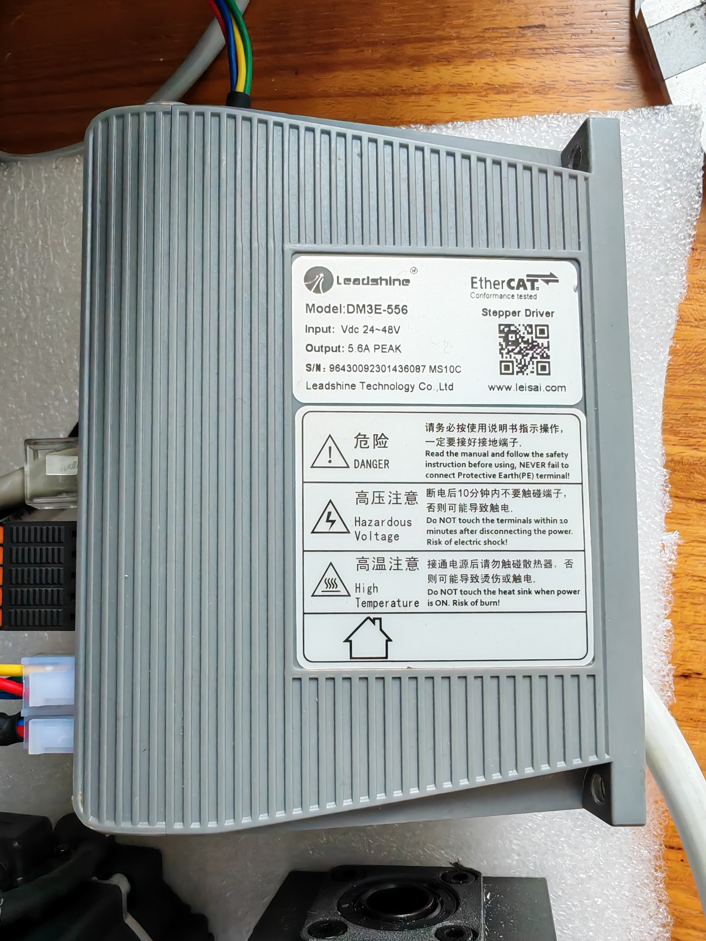

Hi,according to the attachment file .I guess it's called DM3E-556 ?

22 May 2024 16:41 - 22 May 2024 16:41 #301155
by jjdege
Replied by jjdege on topic Help,Leadshine DM556 open-loop stepper config
HI
sorry but the DM3E-556 communicates directly via EtherCAT with LCNC,
what I said applies to the DM556 which needs an EtherCAT controller to communicate with LCNC
I don't see DM3E-556 among the devices supported by LCNC,
you will need to build an .XML generic to make it work

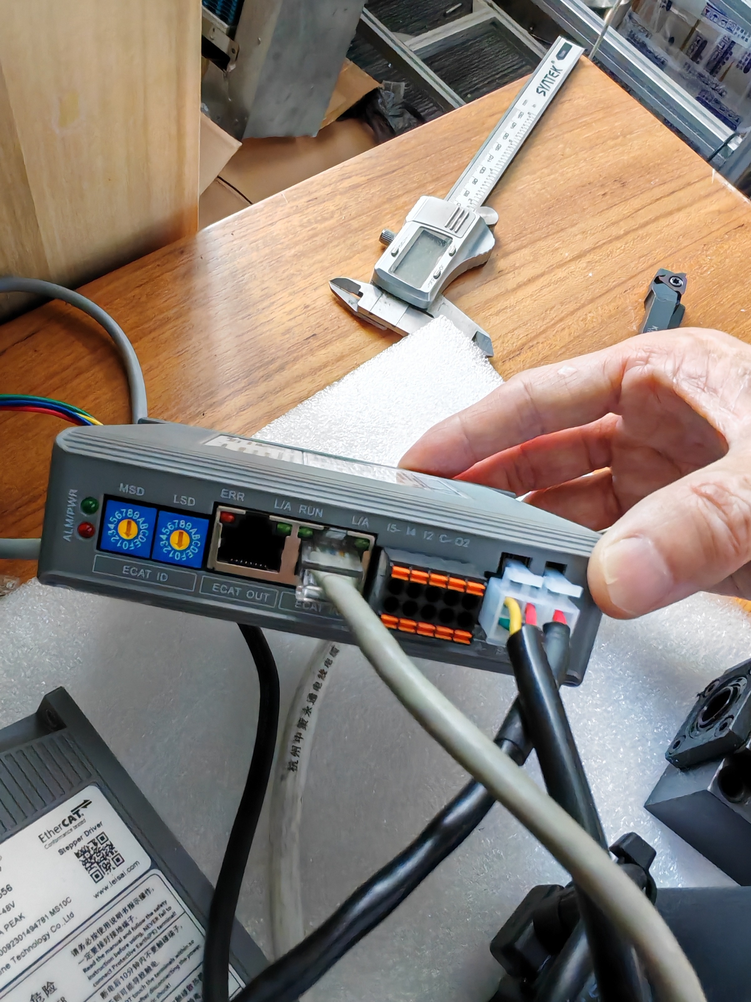

Hi,in the terminal ,while I used "ethercat sl" command ,it did show up connected to DM3E-556 but while I used the control panel such as axis ,it can't control the stepper motor to rotate.I guess the problem may be due to .ini or hal and xml file ,but I dont know how to config it correctly .I looks that it 's much more complex to config the open-loop stepper motor comparing with the servo motor.do you have any workable .ini/.hal/.xml file of the open-loop stepper motor ?

24 May 2024 07:18 #301291
by jjdege
LCNC starts?
if it starts in halpin lcec.0. your device with connection pins, are they visible?
Connected in "OP" mode or "SAFEOP"?in the terminal ,while I used "ethercat sl" command ,it did show up connected to DM3E-556 but while
LCNC starts?
