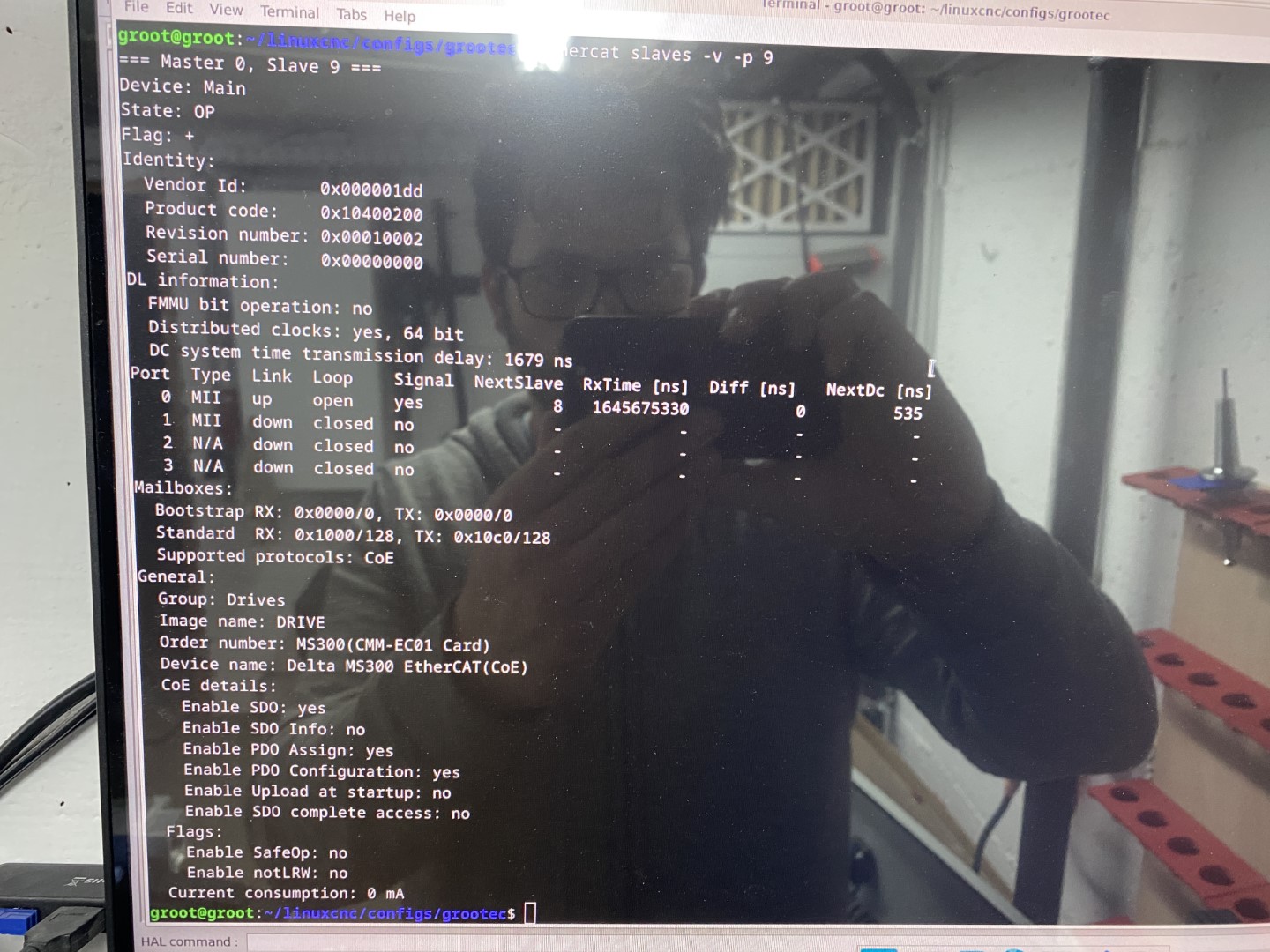

- VFD has a CMM-EC01 (according to ethercat slaves -v)

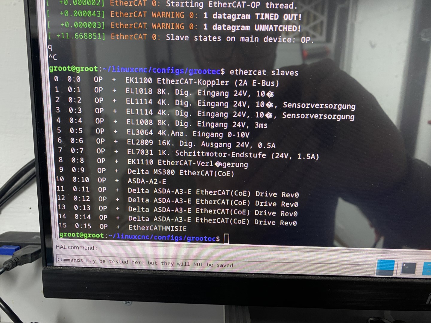

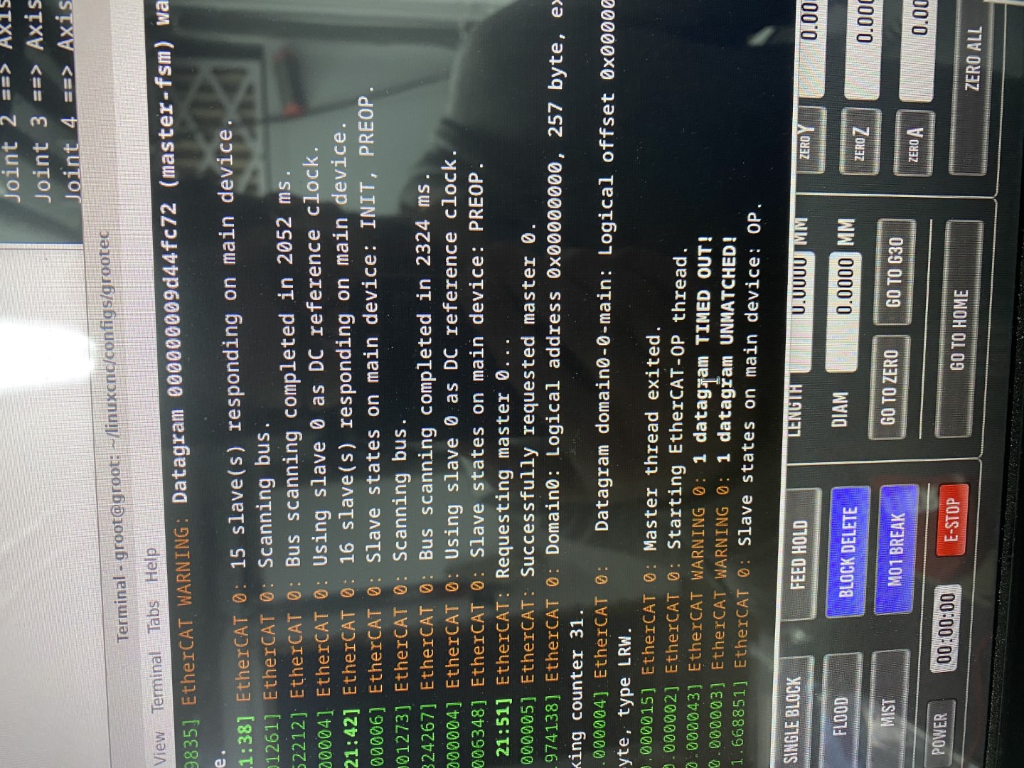

- When starting linuxcnc based on this config ( my repo, ethercat-conf.xml ) all slaves go OP (takes a couple of seconds)
- Beckhoff slaves and custom slave behave as expected

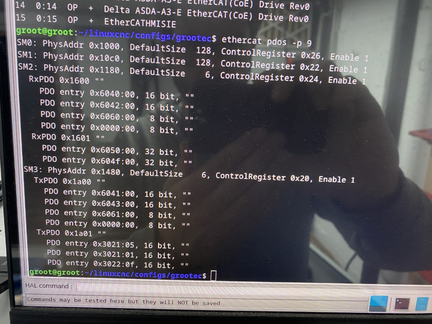

- Ethercat pdos and ethercat slaves -v export attached as photos
- I have not had the issues of not seeing any PDOS to which an alternative SII binary was suggested here: forum.linuxcnc.org/ethercat/45099-trunca...-bit-signed-integers
I have tried the linked binary to no effect. I have tried using the Init commands as outlined in the example repo above to no effect (I admit that I do not fully understand those)

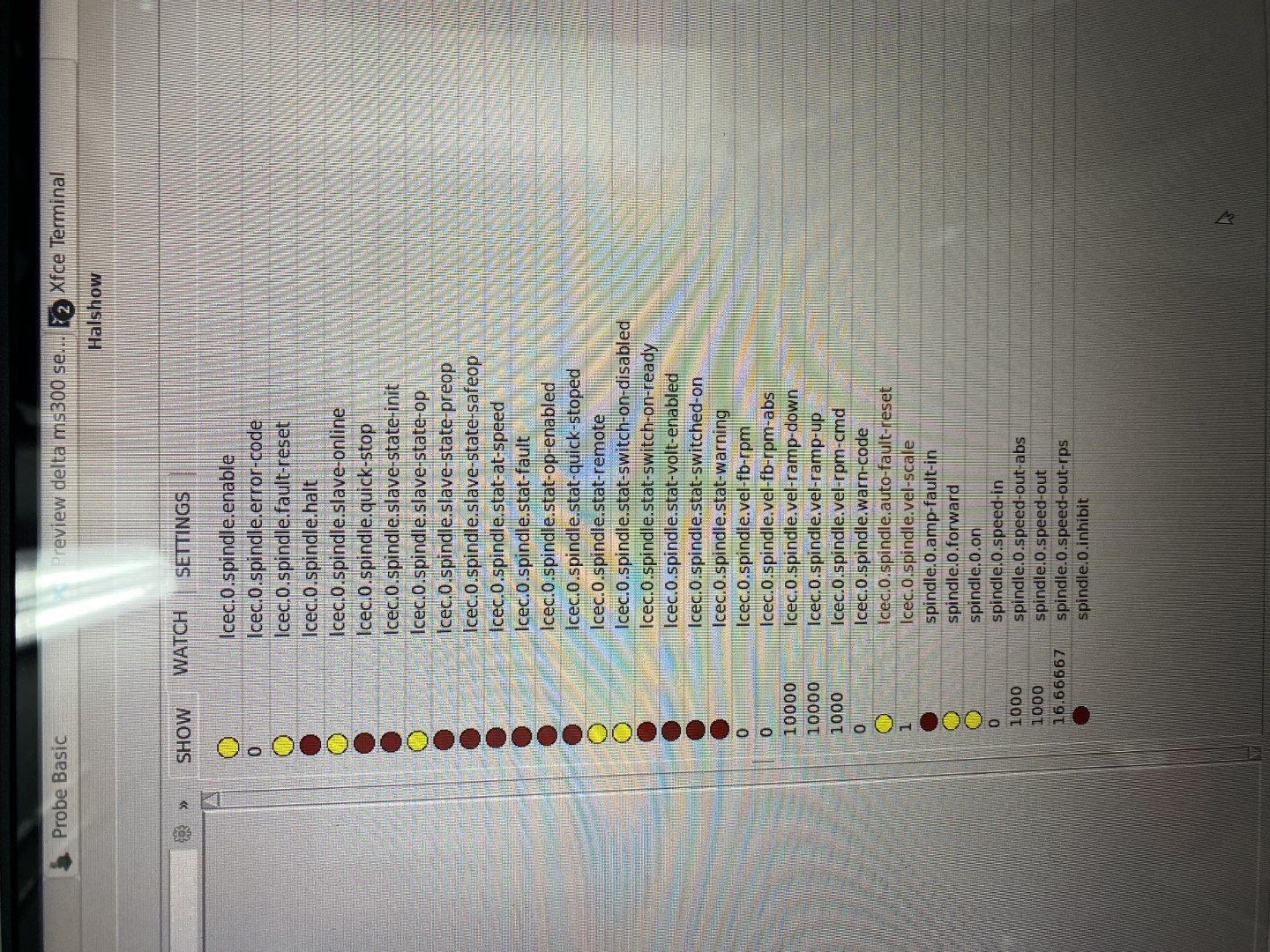

When setting a spindle speed (S1000, e.g. 1000 rpm) in MDI and issuing M3 afterwards the following happens
See halshow below for parameters and values:
1) VFD shows output command frequency as 333.33 Hz --> This is od, because it is scaled by a factor of 10! 33.33Hz would be correct as this is a 4 pole spindle
2) Nothing happens. No movement of the spindle, instead: Looking at hal show it becomes apparent, that the driver is stuck on stat-switch-on-disabled
At this point: No error messages on the VFD, no Fault via EtherCAT
I am lost (to say the least) and have been for days now. Does anyone have any pointers?

The devil always is in the details.
I line by line reviewed manuals and code again.
My issue with the spindle not starting and the vfd being stuck at the state mentioned above is the result of connecting pin lcec.o.spindle.fault-reset to machine-is-on. Accordingly, the pin is always high in following the implementation of lcec_dems300 this results in a bit of the control word being always 0 (where it should switch to one).
I fixed this using a oneshot.
What remains is the factor of x10 in the RPM transmission (with the received being too high!). No idea what causes this. Typically one would expect something like 1000 being interpreted as 100.0 but that would be factor 10 smaller and not larger. I will likely fix this by setting velocity scale accordingly. It still bugs me though...
