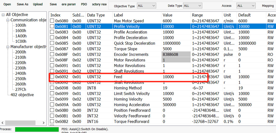

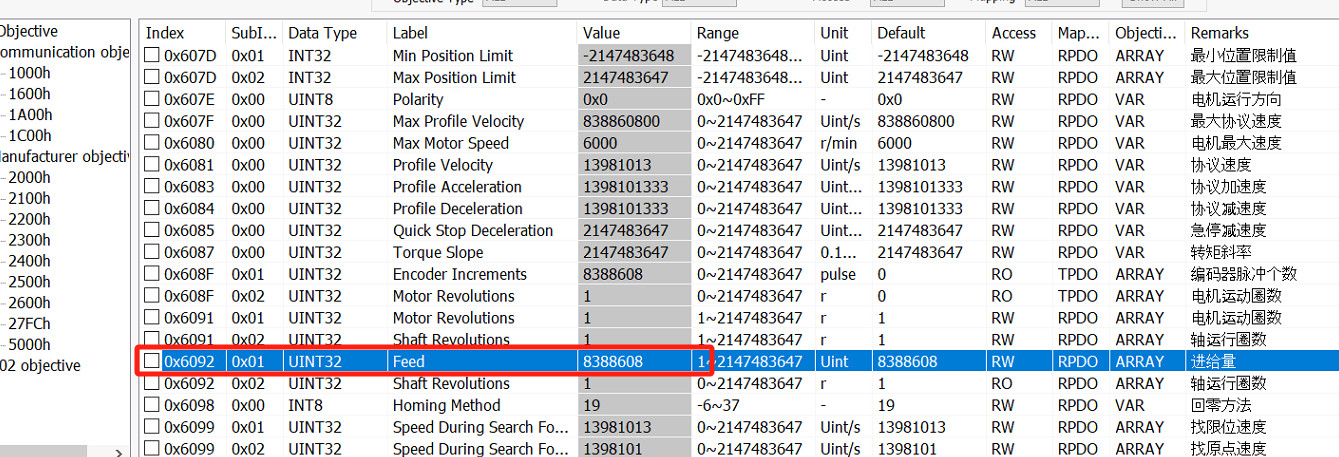

I have new servo drive: Leadshine EtherCAT EL6-EC400
I can read feedback of EL6-EC400, but could not control it.
I tested well with Leadshine EtherCAT drive EL7-EC400F.
I know that this model is in LCNC EtherCAT database: linuxcnc-ethercat.github.io/esi-data/devices/EL7-EC400F
Maybe EL6 series is new, not yet updated in LCNC database.
I confirm that ESI of EL6-xxx is same as EL7-xxx
Can you advise how to solve issue ?. Thank you.
