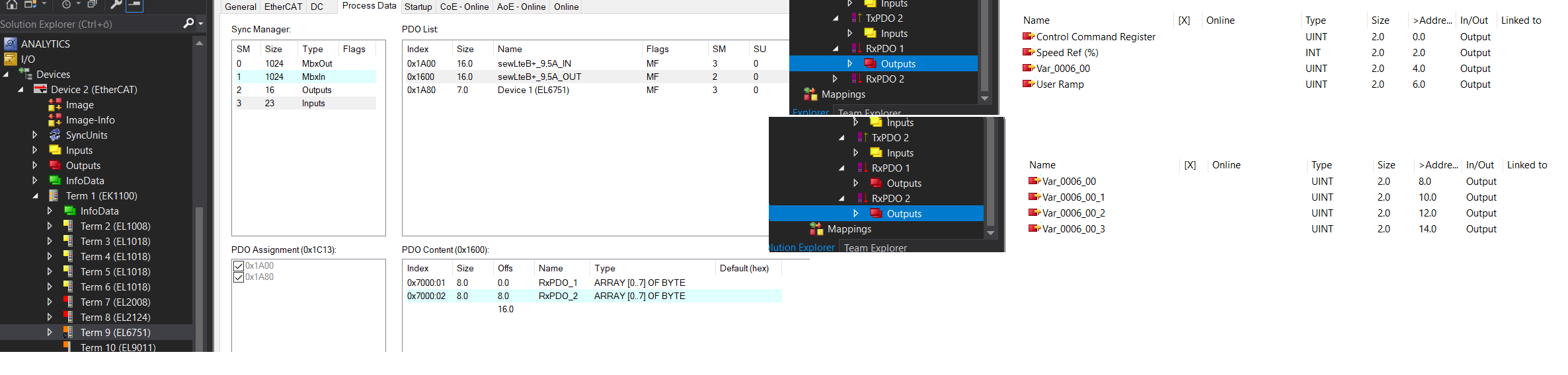

Hello,
have anybody idea how to define data type array of bytes in the ethercat-conf.xml file which is loaded during startup of lcec?
I am working currently on some configuration file and in the twincat 3 enviroment is slave described PDOs as array[0...7] of bytes ...
I think if there will be definition over "complex" data type and inside will be byte to byte definition of each variable ...have anybody experiences with something like I desribed higher please?
thanks
regards
thanks
regards

- endian
- Posts: 339
- Thank you received: 134
31 Jul 2024 13:35 - 01 Aug 2024 04:33 #306553
by endian
Replied by endian on topic Exotic data types in .xml config
It is EL6751 CANopen master from beckhoff with some sew lte-b+ vfd wchich is build in them directly. When I working on it via the TwinCAT3 enviroment, there are TX RX PDOs formated in the shape which I last described.. array[0...7] of bytes
I think there should be possibility to write them as complex with 64bit size and then slice it inside to correct s32 or u32s for the hal...
regards
regards
Last edit: 01 Aug 2024 04:33 by endian.

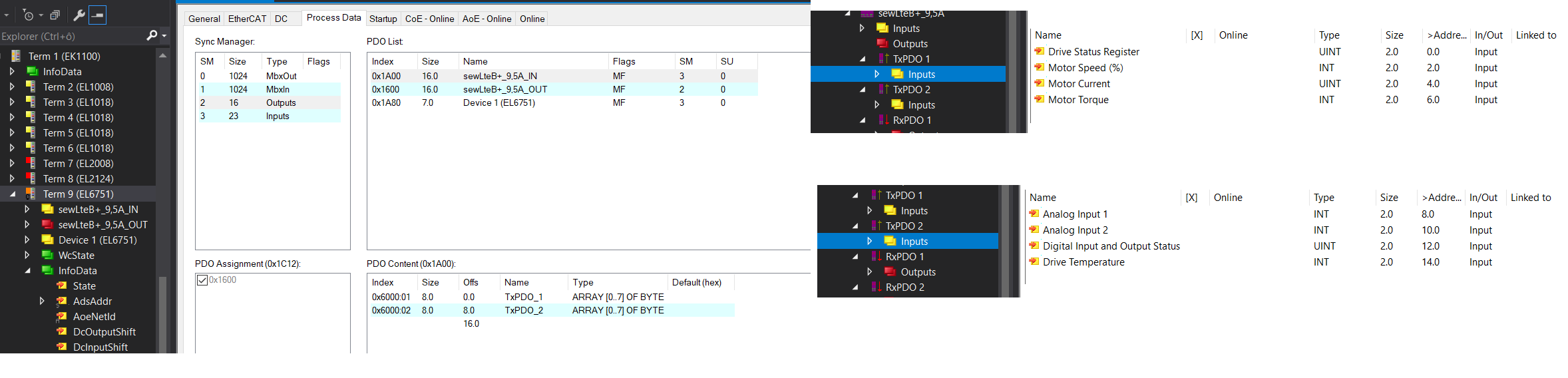

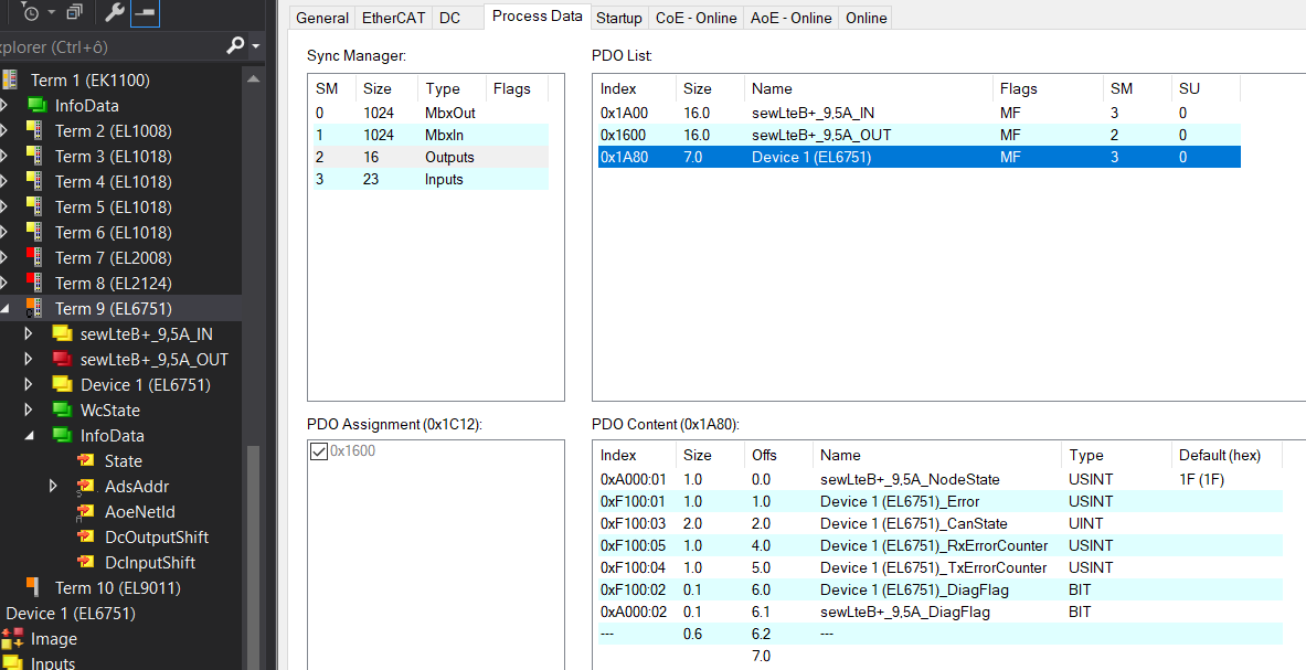

- endian
- Posts: 339
01 Aug 2024 04:13 - 01 Aug 2024 04:32 #306594
by endian
I did some paint science ...
there are in the 2 and 3 SM are data objects 1A00 and 1600 which are filled from array of bytes...
next
there is a 1A80 data type which are describtion EL6751 itselt...
have a look
this is status without SDO mapping done
[/code]user@user:~/ethercat-master$ ethercat slaves 0 0:0 PREOP + EK1100 EtherCAT Coupler (2A E-Bus) 1 0:1 PREOP + EL1008 8Ch. Dig. Input 24V, 3ms 2 0:2 PREOP + EL1018 8Ch. Dig. Input 24V, 10�s 3 0:3 PREOP + EL1018 8K. Dig. Eingang 24V, 10�s 4 0:4 PREOP + EL1018 8K. Dig. Eingang 24V, 10�s 5 0:5 PREOP + EL1018 8K. Dig. Eingang 24V, 10�s 6 0:6 PREOP + EL2008 8K. Dig. Ausgang 24V, 0.5A 7 0:7 PREOP + EL2124 4K. Dig. Ausgang 5V, 20mA 8 0:8 PREOP + EL6751 CANopen Master [code]user@user:~/ethercat-master$ ethercat pdos === Master 0, Slave 1 === SM0: PhysAddr 0x1000, DefaultSize 1, ControlRegister 0x00, Enable 1 TxPDO 0x1a00 "Channel 1" PDO entry 0x6000:01, 1 bit, "Input" TxPDO 0x1a01 "Channel 2" PDO entry 0x6010:01, 1 bit, "Input" TxPDO 0x1a02 "Channel 3" PDO entry 0x6020:01, 1 bit, "Input" TxPDO 0x1a03 "Channel 4" PDO entry 0x6030:01, 1 bit, "Input" TxPDO 0x1a04 "Channel 5" PDO entry 0x6040:01, 1 bit, "Input" TxPDO 0x1a05 "Channel 6" PDO entry 0x6050:01, 1 bit, "Input" TxPDO 0x1a06 "Channel 7" PDO entry 0x6060:01, 1 bit, "Input" TxPDO 0x1a07 "Channel 8" PDO entry 0x6070:01, 1 bit, "Input" === Master 0, Slave 2 === SM0: PhysAddr 0x1000, DefaultSize 1, ControlRegister 0x00, Enable 1 TxPDO 0x1a00 "Channel 1" PDO entry 0x6000:01, 1 bit, "Input" TxPDO 0x1a01 "Channel 2" PDO entry 0x6010:01, 1 bit, "Input" TxPDO 0x1a02 "Channel 3" PDO entry 0x6020:01, 1 bit, "Input" TxPDO 0x1a03 "Channel 4" PDO entry 0x6030:01, 1 bit, "Input" TxPDO 0x1a04 "Channel 5" PDO entry 0x6040:01, 1 bit, "Input" TxPDO 0x1a05 "Channel 6" PDO entry 0x6050:01, 1 bit, "Input" TxPDO 0x1a06 "Channel 7" PDO entry 0x6060:01, 1 bit, "Input" TxPDO 0x1a07 "Channel 8" PDO entry 0x6070:01, 1 bit, "Input" === Master 0, Slave 3 === SM0: PhysAddr 0x1000, DefaultSize 1, ControlRegister 0x00, Enable 1 TxPDO 0x1a00 "Channel 1" PDO entry 0x6000:01, 1 bit, "Input" TxPDO 0x1a01 "Channel 2" PDO entry 0x6010:01, 1 bit, "Input" TxPDO 0x1a02 "Channel 3" PDO entry 0x6020:01, 1 bit, "Input" TxPDO 0x1a03 "Channel 4" PDO entry 0x6030:01, 1 bit, "Input" TxPDO 0x1a04 "Channel 5" PDO entry 0x6040:01, 1 bit, "Input" TxPDO 0x1a05 "Channel 6" PDO entry 0x6050:01, 1 bit, "Input" TxPDO 0x1a06 "Channel 7" PDO entry 0x6060:01, 1 bit, "Input" TxPDO 0x1a07 "Channel 8" PDO entry 0x6070:01, 1 bit, "Input" === Master 0, Slave 4 === SM0: PhysAddr 0x1000, DefaultSize 1, ControlRegister 0x00, Enable 1 TxPDO 0x1a00 "Channel 1" PDO entry 0x6000:01, 1 bit, "Input" TxPDO 0x1a01 "Channel 2" PDO entry 0x6010:01, 1 bit, "Input" TxPDO 0x1a02 "Channel 3" PDO entry 0x6020:01, 1 bit, "Input" TxPDO 0x1a03 "Channel 4" PDO entry 0x6030:01, 1 bit, "Input" TxPDO 0x1a04 "Channel 5" PDO entry 0x6040:01, 1 bit, "Input" TxPDO 0x1a05 "Channel 6" PDO entry 0x6050:01, 1 bit, "Input" TxPDO 0x1a06 "Channel 7" PDO entry 0x6060:01, 1 bit, "Input" TxPDO 0x1a07 "Channel 8" PDO entry 0x6070:01, 1 bit, "Input" === Master 0, Slave 5 === SM0: PhysAddr 0x1000, DefaultSize 1, ControlRegister 0x00, Enable 1 TxPDO 0x1a00 "Channel 1" PDO entry 0x6000:01, 1 bit, "Input" TxPDO 0x1a01 "Channel 2" PDO entry 0x6010:01, 1 bit, "Input" TxPDO 0x1a02 "Channel 3" PDO entry 0x6020:01, 1 bit, "Input" TxPDO 0x1a03 "Channel 4" PDO entry 0x6030:01, 1 bit, "Input" TxPDO 0x1a04 "Channel 5" PDO entry 0x6040:01, 1 bit, "Input" TxPDO 0x1a05 "Channel 6" PDO entry 0x6050:01, 1 bit, "Input" TxPDO 0x1a06 "Channel 7" PDO entry 0x6060:01, 1 bit, "Input" TxPDO 0x1a07 "Channel 8" PDO entry 0x6070:01, 1 bit, "Input" === Master 0, Slave 6 === SM0: PhysAddr 0x0f00, DefaultSize 0, ControlRegister 0x44, Enable 9 RxPDO 0x1600 "Channel 1" PDO entry 0x7000:01, 1 bit, "Output" RxPDO 0x1601 "Channel 2" PDO entry 0x7010:01, 1 bit, "Output" RxPDO 0x1602 "Channel 3" PDO entry 0x7020:01, 1 bit, "Output" RxPDO 0x1603 "Channel 4" PDO entry 0x7030:01, 1 bit, "Output" RxPDO 0x1604 "Channel 5" PDO entry 0x7040:01, 1 bit, "Output" RxPDO 0x1605 "Channel 6" PDO entry 0x7050:01, 1 bit, "Output" RxPDO 0x1606 "Channel 7" PDO entry 0x7060:01, 1 bit, "Output" RxPDO 0x1607 "Channel 8" PDO entry 0x7070:01, 1 bit, "Output" === Master 0, Slave 7 === SM0: PhysAddr 0x0f00, DefaultSize 0, ControlRegister 0x44, Enable 9 RxPDO 0x1600 "Channel 1" PDO entry 0x7000:01, 1 bit, "Output" RxPDO 0x1601 "Channel 2" PDO entry 0x7010:01, 1 bit, "Output" RxPDO 0x1602 "Channel 3" PDO entry 0x7020:01, 1 bit, "Output" RxPDO 0x1603 "Channel 4" PDO entry 0x7030:01, 1 bit, "Output" === Master 0, Slave 8 === SM0: PhysAddr 0x1000, DefaultSize 1024, ControlRegister 0x26, Enable 1 SM1: PhysAddr 0x1400, DefaultSize 1024, ControlRegister 0x22, Enable 1 SM2: PhysAddr 0x1800, DefaultSize 0, ControlRegister 0x26, Enable 1 SM3: PhysAddr 0x2400, DefaultSize 0, ControlRegister 0x22, Enable 1
next
have a look
Last edit: 01 Aug 2024 04:32 by endian.

02 Aug 2024 14:32 #306788
by endian
what is really not clear to mo how exactly type definition of these ending stuff ... I think it should be like this or ?
<syncManager idx="3" dir="in">
<pdo idx="1A00">
<pdoEntry idx="6000" subIdx="01" bitLen="64" halType="complex" />

working twincat3 project with EL6751 and one slave... I am creating the .xml config and I will try them with etherlab master...
regards
regards
