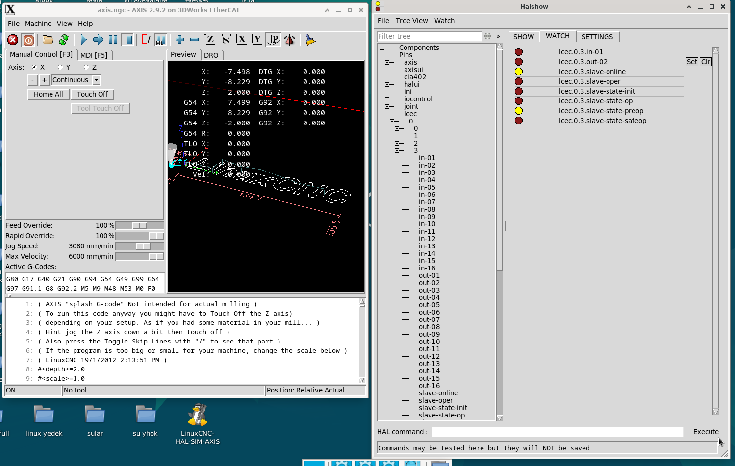

- Hello, I would like to add an EtherCAT IO device. What should I do

03 Aug 2024 22:13 #306894
by feng
Hello, I would like to add an EtherCAT IO device. What should I do was created by feng

lite@LinuxCNC:~$ sudo ethercat slaves
0 0:0 OP + L7EC-400S(COE)
1 0:1 OP + L7EC-400S(COE)
2 0:2 OP + L7EC-400S(COE)
3 0:3 PREOP E EM32DX-E4
/* Master 0, Slave 3, "EM32DX-E4"
* Vendor ID: 0x00004321
* Product code: 0x01100073
* Revision number: 0x18050210
ec_pdo_entry_info_t slave_3_pdo_entries[] = {
{0x7000, 0x01, 16}, /* OUT */
{0x6000, 0x01, 16}, /* IN */
ec_pdo_info_t slave_3_pdos[] = {
{0x1600, 1, slave_3_pdo_entries + 0}, /* RxPDO0-Map */
{0x1a00, 1, slave_3_pdo_entries + 1}, /* TxPDO1-Map */
ec_sync_info_t slave_3_syncs[] = {
{0, EC_DIR_OUTPUT, 0, NULL, EC_WD_DISABLE},
{1, EC_DIR_INPUT, 0, NULL, EC_WD_DISABLE},
{2, EC_DIR_OUTPUT, 1, slave_3_pdos + 0, EC_WD_ENABLE},
{3, EC_DIR_INPUT, 1, slave_3_pdos + 1, EC_WD_DISABLE},
{0xff}

- cekaa
- Posts: 19
02 Apr 2026 06:13 #345057
by cekaa
Replied by cekaa on topic Hello, I would like to add an EtherCAT IO device. What should I do
Hi, I have the same problem. How did you switch to XML OP mode?
Leidshine em32dx-e
ceka@debian:~$ ethercat slave
0 0:0 OP + XINJE-DS5C1 EtherCAT(CoE) Drive Rev4.0 v3.7.70
1 0:1 OP + XINJE-DS5C1 EtherCAT(CoE) Drive Rev4.0 v3.7.70
2 0:2 OP + XINJE-DS5C1 EtherCAT(CoE) Drive Rev4.0 v3.7.70
ceka@debian:~$

- cekaa
- Posts: 19
03 Apr 2026 07:13 #345102
by cekaa
Is there a place to learn how to use XML?
ceka@debian:~$ ethercat pdos
=== Master 0, Slave 2 ===
SM0: PhysAddr 0x1000, DefaultSize 64, ControlRegister 0x26, Enable 1
SM1: PhysAddr 0x1100, DefaultSize 64, ControlRegister 0x22, Enable 1
SM2: PhysAddr 0x1200, DefaultSize 6, ControlRegister 0x64, Enable 1
SM3: PhysAddr 0x1400, DefaultSize 12, ControlRegister 0x20, Enable 1
=== Master 0, Slave 3 ===
SM0: PhysAddr 0x1000, DefaultSize 128, ControlRegister 0x26, Enable 1
SM1: PhysAddr 0x1400, DefaultSize 128, ControlRegister 0x22, Enable 1
SM2: PhysAddr 0x1800, DefaultSize 5, ControlRegister 0x64, Enable 1
RxPDO 0x1600 "RxPDO0-Map"
PDO entry 0x7000:01, 16 bit, "OUT"
SM3: PhysAddr 0x1c00, DefaultSize 7, ControlRegister 0x20, Enable 1
TxPDO 0x1a00 "TxPDO1-Map"
PDO entry 0x6000:01, 16 bit, "IN"
ceka@debian:~$

- cekaa
- Posts: 19
04 Apr 2026 01:37 #345146
by cekaa
I struggled a lot because it was a topic I didn't understand at all. I added the pdos and the lcec_configgen result, but I didn't understand what kind of structure I was supposed to create.
When 32 bit = 16 bit
3 0:3 SAFEOP+ERROR E EM32DX-E4 ????????????????????????????????????????????
ceka@debian:~$
lcec_configgen
<slave idx="3" type="generic" vid="0x00004321" pid="0x01100073" name="D4">
<!--EM32DX-E4-->
<syncManager idx="0" dir="in"/>
<syncManager idx="1" dir="out"/>
<syncManager idx="2" dir="out">
<pdo idx="1600">
<!--RxPDO0-Map-->
<pdoEntry idx="7000" subIdx="01" bitLen="16" halPin="out" halType="u32"/>
</pdo>
</syncManager>
<syncManager idx="3" dir="in">
<pdo idx="1a00">
<!--TxPDO1-Map-->
<pdoEntry idx="6000" subIdx="01" bitLen="16" halPin="in" halType="u32"/>
</pdo>
</syncManager>
</slave>
</master>
</masters>
ceka@debian:~$
Would the `lcec_configgen` command help? Could someone write the correct configuration for me?
ceka@debian:~$
old now
ceka@debian:~$
lcec_configgen
<!--EM32DX-E4-->
<pdo idx="1600">
<!--RxPDO0-Map-->
</pdo>
</syncManager>
<pdo idx="1a00">
<!--TxPDO1-Map-->
</pdo>
</syncManager>
</slave>
</master>
</masters>
ceka@debian:~$
