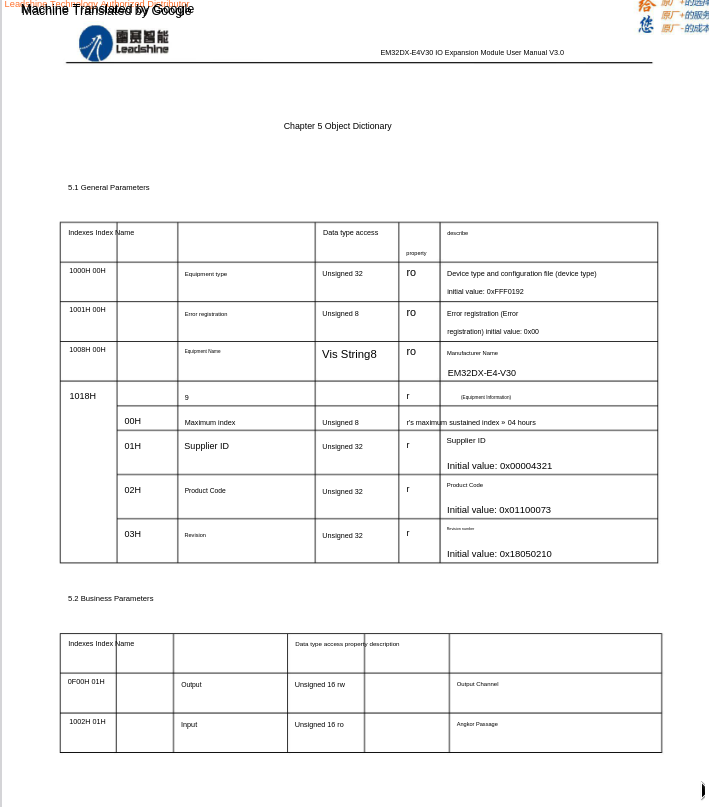

04 Apr 2026 06:45 #345155
by cekaa
Replied by cekaa on topic Hello, I would like to add an EtherCAT IO device. What should I do
sudo dmesg -wH
[Apr 4 07:43] EtherCAT 0: Master thread exited.
[ +0.000016] EtherCAT 0: Starting EtherCAT-IDLE thread.
[ +0.000038] EtherCAT ERROR 0-3: Failed to receive AL state datagram: Datagram initialized.
[ +0.000017] EtherCAT 0: Releasing master...
[ +0.000001] EtherCAT 0: Released.
[ +0.024165] EtherCAT ERROR 0-0: AL status message 0x001A: "Synchronization error".
[ +0.001309] EtherCAT 0-0: Acknowledged state SAFEOP.
[ +0.014483] EtherCAT ERROR 0-1: AL status message 0x001A: "Synchronization error".
[ +0.001578] EtherCAT 0-1: Acknowledged state SAFEOP.
[ +0.010458] EtherCAT ERROR 0-2: AL status message 0x001A: "Synchronization error".
[ +0.000839] EtherCAT 0-2: Acknowledged state SAFEOP.
[ +0.011212] EtherCAT ERROR 0-3: AL status message 0x002D: "No Sync Error".
[ +0.000528] EtherCAT 0-3: Acknowledged state SAFEOP.
[ +0.007163] EtherCAT 0: Slave states on main device: PREOP.
[ +0.783938] EtherCAT WARNING: Datagram 000000007d6dd556 (master-fsm) was SKIPPED 1 time.
[ +12.203295] EtherCAT: Requesting master 0...
[ +0.000003] EtherCAT: Successfully requested master 0.
[ +0.001335] EtherCAT 0: Domain0: Logical address 0x00000000, 112 byte, expected working counter 12.
[ +0.000003] EtherCAT 0: Datagram domain0-0-main: Logical offset 0x00000000, 112 byte, type LRW.
[ +0.000009] EtherCAT 0: Master thread exited.
[ +0.000002] EtherCAT 0: Starting EtherCAT-OP thread.
[ +0.000030] EtherCAT WARNING 0: 1 datagram UNMATCHED!
[ +5.267792] EtherCAT WARNING 0-0: Slave did not sync after 5000 ms.
[ +6.879988] EtherCAT ERROR 0-3: Timeout while setting state OP.
[ +0.007489] EtherCAT 0: Slave states on main device: SAFEOP, OP.
[ +3.132001] EtherCAT 0: Slave states on main device: SAFEOP, OP + ERROR.
- cekaa
- Posts: 19
04 Apr 2026 06:55 #345156
by cekaa
That's all the information in the PDF.
