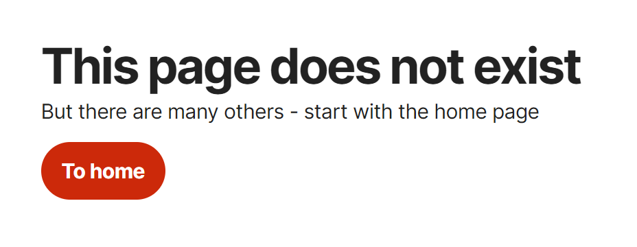

Could you please write the name and model? There is no product at the link.I think this would be a good I/O module but you would need to create the generic xml which is not hard There may be an xml file here somewhere.
www.aliexpress.com/item/1005004377766525.html
- Posts: 12156
- Thank you received: 4149
05 Aug 2024 08:38 #306979
Replied by rodw on topic EtherCAT i/o board for spindle, estop and mpg
Odd, it works for me CATIO-A

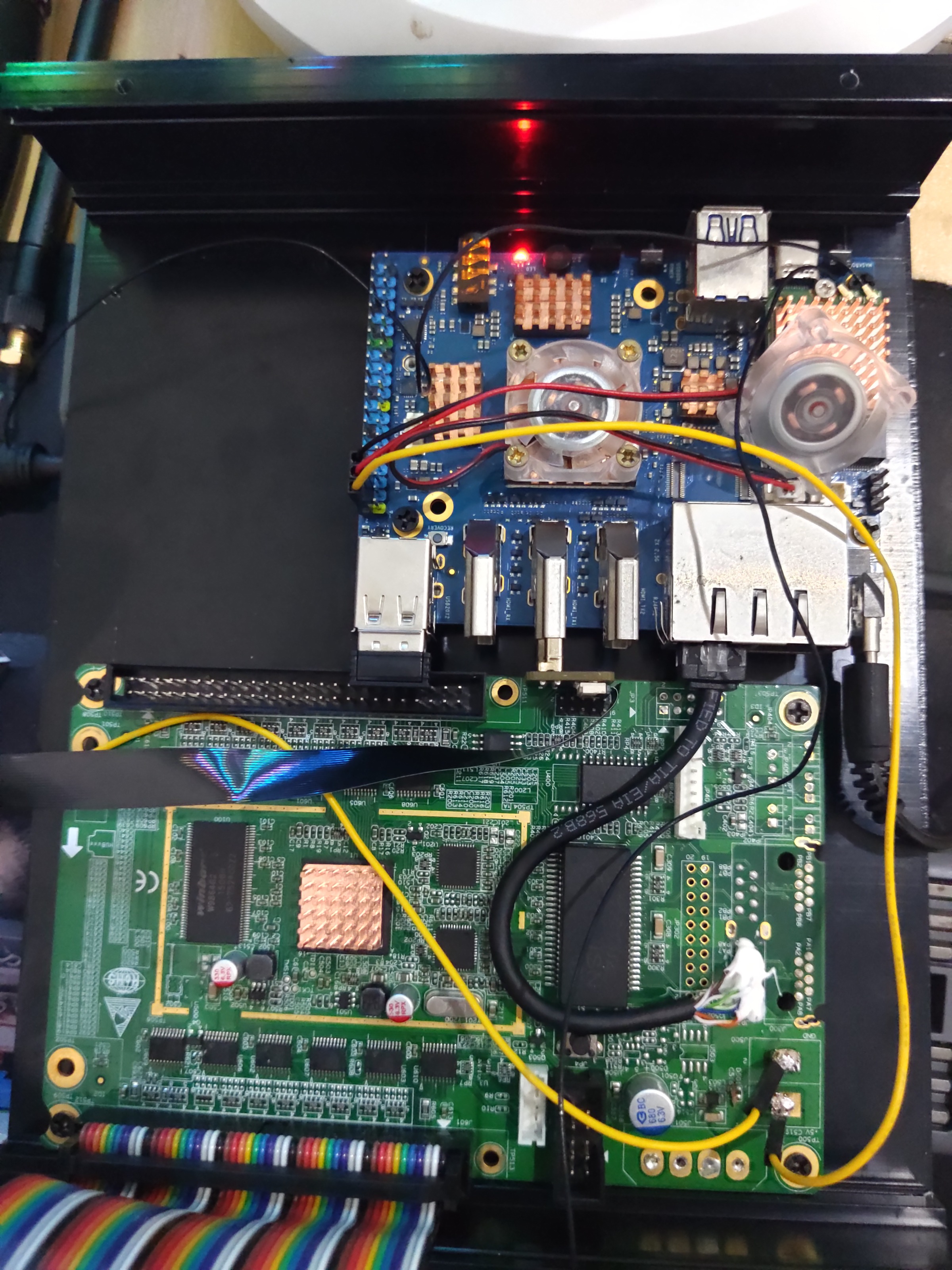

05 Aug 2024 14:09 - 05 Aug 2024 14:13 #306998
by onceloved
Replied by onceloved on topic EtherCAT i/o board for spindle, estop and mpg
Last edit: 05 Aug 2024 14:13 by onceloved.
