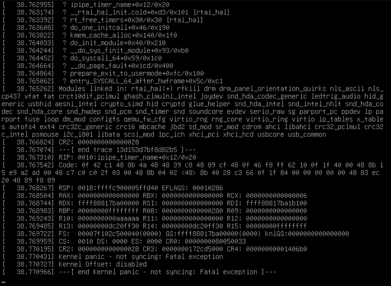

I'm still having trouble booting to RTAI. I did try to follow the steps from the official docs, but running the linuxcnc-install.sh script would cause source conflicts on a LinuxCNC ISO, leaving me unable to use apt. On a vanilla Debian 12 ISO, it would still install linuxcnc-uspace and all, but then on trying to run sudo apt install linuxcnc it would cause conflicts again, even when I try to purge linuxcnc-uspace and linuxcnc-doc*.
I tried it following the instructions from the pinned RTAI thread , install a fresh vanilla Debian 12 ISO, download the 4 .deb files and install them with dpkg, yet the linuxcnc package would fail to build with dpkg. Either way, it still leaves me with the same error about the root filesystem on attempting to boot. I even tried to go with BIOS boot instead of UEFI.
Am I still doing something wrong? Should I open a new thread in the Installing LinuxCNC forum section regarding this?
Edit: in the rescue shell I am dropped in, uname -r does confirm I am running the RTAI kernel. So the issue is not the kernel installation allegedly, but it somehow not finding the correct root filesystem? I double and triple checked the UUID, it is indeed the correct one.

I managed to figure my way around the conflicts, I was interpreting the docs incorrectly probably. Also not sure what exactly I did differently, but after a few reinstalls through varying methods, I got past that error and onto a new problem.
Upon booting to the RTAI kernel, the display manager service fails to start entirely. I am able to press Ctrl+Alt+F1 to log into a tty, though and uname -r does tell me I am booted to the correct kernel. I am still unable to start the display manager or the desktop environment at all, even manually. Interestingly, when I start latency-test, a kernel panic occurs and the system freezes up entirely. I am attaching an image.
All this on UEFI boot and on both a vanilla Debian 12 install and an install of the LinuxCNC 2.9.3 ISO as well.
Quite honestly, I have no idea what to think.

Try setting the BIOS in Legacy mode or with CMS enabled.

Wait, i just saw the tittle, EtherCAT did not work with RTAI at all, are you sure it works now?

Oh, I already did that as I mentioned a few posts ago. However, I didn't mention in the latest post that trying it in Legacy boot doesn't get me past the initial root filesystem error. No clue...
I will attempt to try some different RTAI versions and will also see if I can try it out on a different computer altogether. In the pinned RTAI thread I saw some talk of unstable versions and on differing behavior across different motherboards.
Will give it a few more tries before I look into buying new hardware, lol.

I am positive Sascha dropped support for RTAI back years ago, and this would have been before Scott started the new branch that everyone is working from on the REPO. (I can remember Sascha stating that no one is using RTAI now and he was dropping support)
Be aware that RTAI had a lot of work arounds back in the day. The last time that I built with RTAI was back in 2015 and that was under Debian 7 Wheezy with LCNC 2.6... Back before 2015, RTAI was dominate as LCNC did not play well with PREEMPT. But somewhere around 2015-2017, PREEMPT took over. I am pretty sure that Sascha fixed the "mutex" problem back before PREEMPT came into play. I worked heavily on the RTAI builds back between 2013-2015, and I am sure I have all my notes from back then on the work arounds. Also, you mentioned about "missing modules", I am sure you are talking about the "kernel modules" as that was a problem back with RTAI builds. I am extremely busy and never on here, but I will try to do a RTAI build over the weekend and see if it will work without doing a bunch extra work. Two weeks ago, I did a minimal Debian 12 with LCNC 2.10, ECAT 1.6, and Sascha's code, but that was with PREEMPT... I will do my best to try and do a build and let you know something.
Also, in the BIOS... yes you have to be "legacy" and under the "drives' section you need to check if it is in "RAID" mode. If you have more than one SSD/drive hooked up, it will try to automatically turn RAID on and you will get the BOOT errors you are describing.
Hope it helps...

I am pretty sure that RTAI is not supported by ethercat debs. For starters, the debs use DKMS so the kernel modules are compiled on yur computer so I suspect that requires a mainstream kernel to fetch the linux-headers source code.

Yeah I agree, I hadn't went to the RTAI site in a long time and wasn't sure if by chance it had gone mainstream. I checked earlier and no, it's still the task of compiling. So, yeah you are right about the debs.
It really comes down to if he can get PREEMPT working or if he has to go with RTAI. If RTAI, then it will be a not so fun source build... those kernel modules suck to deal with if they don't install right off.
