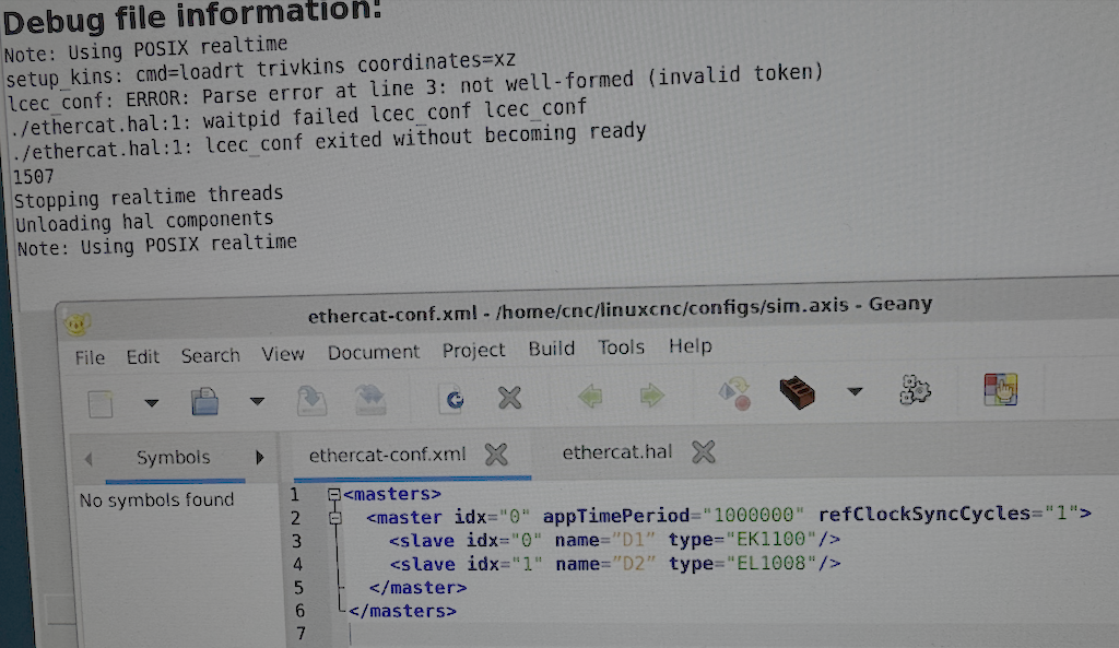

Hello I've been trying to get the Beckhoff components to start for a few days, with very little success.What I did was set up the Raspberry 5, installed Ethercat and made my first attempts with the components.What components: EC AC Servo, EK1100 (cheap on eBay) EL1008 (also cheap)Connected:Servo slave0EK1100 Slave1Only the servo then starts my Linux configuration with various lcec pinsAs soon as the Beckhoff comes into play, it crashes.I made a test xml, can someone tell me if the structure is correct? I don't really know if the various values are correct

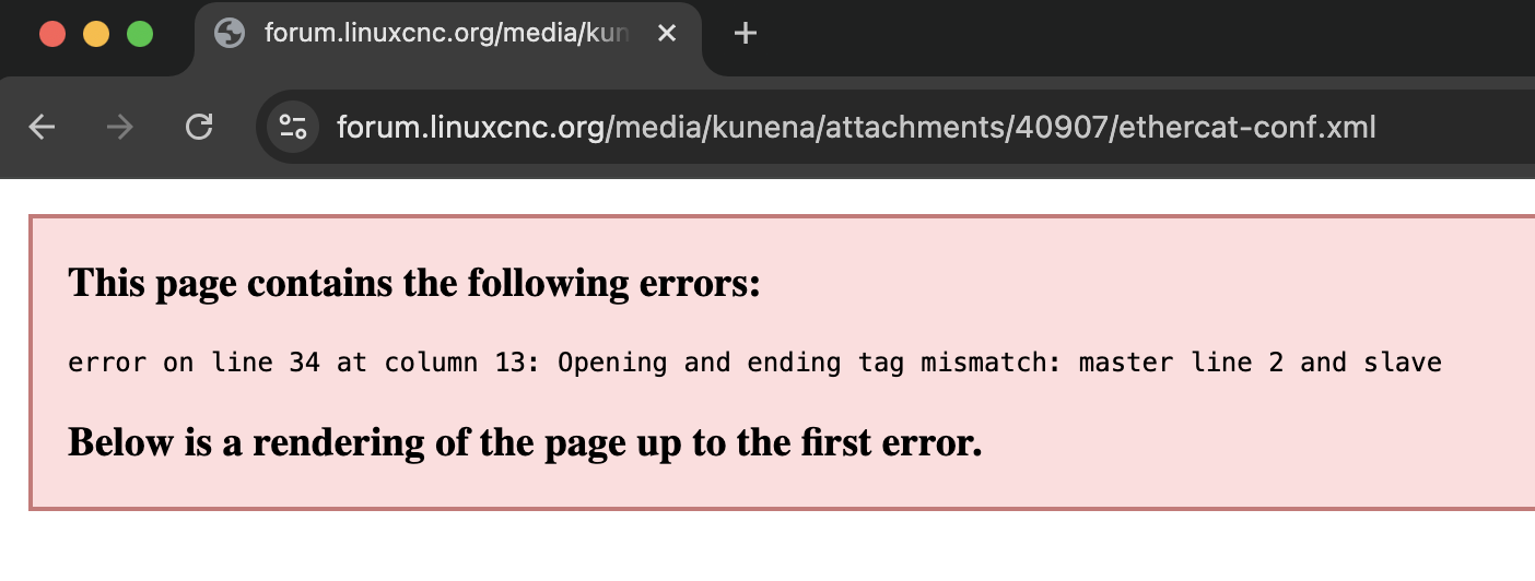

I tried opening your ethercat-conf.xml and it has invalid syntax...see attached screenshot. Try fixing that and see if it works.
K
K

Try removing
name="D1" and name="D2"

I have name= statements in my ethercat conf for Beckhoff stuff but they are the last entry ie
<slave idx="0" type="EK1100" name="1000_EK1100"/>
But I think your problem may be the quotes around the name...they look different than the rest of the quotes. I don't use geany so maybe it's just a code highlight thing.

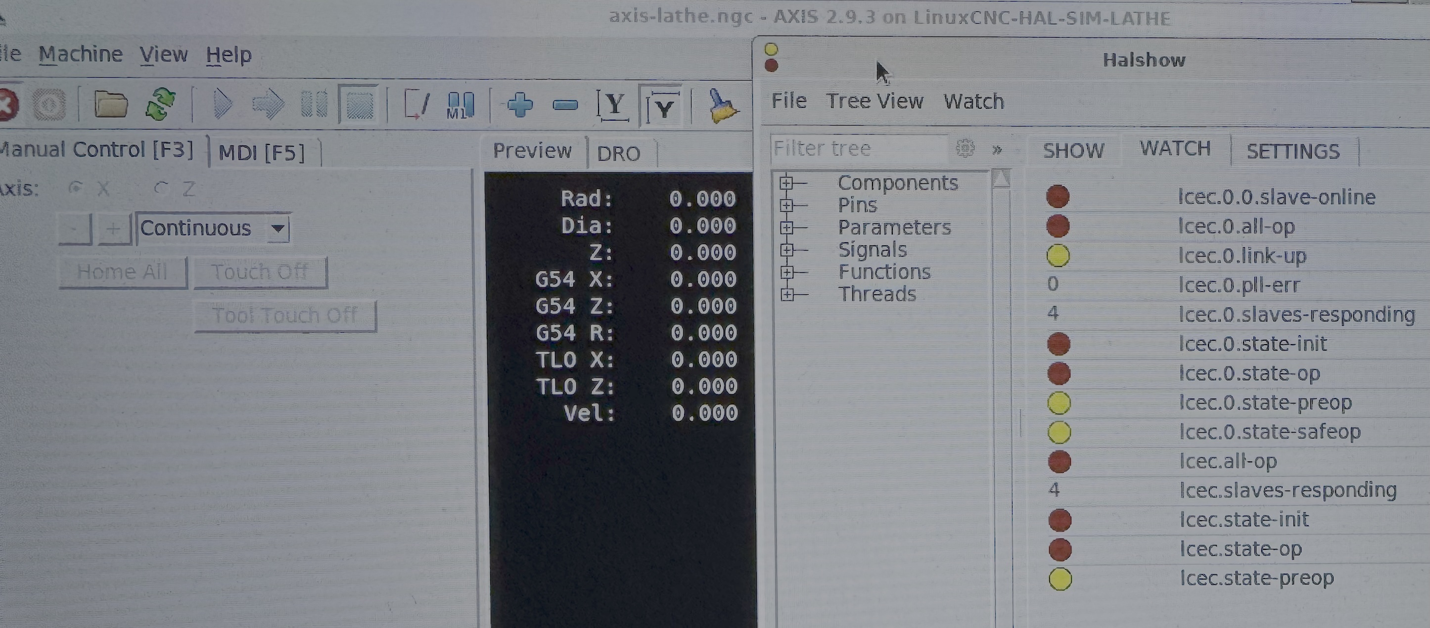

Hallo thanks for the suggestions, it didn't help, I'll approach the matter the other way round, from the servo side. I'll stay here in the post and not open a new one.the sevo is connected and has a connection to the Raspberry, the display shows 28rd, when I start Linuxcnc the emergency stop is activated and cannot be changed? the display then shows 48rd. I read the memory on the console with siitool and it worked without any problems. the 3 files are in the zip. can someone help me?

Anyone who can read has a clear advantage. vid&pid means vendor ID and product code. And these are specific to the hardware. Well, one step further. Lcnc also starts now but nothing happens, so let's keep looking.
