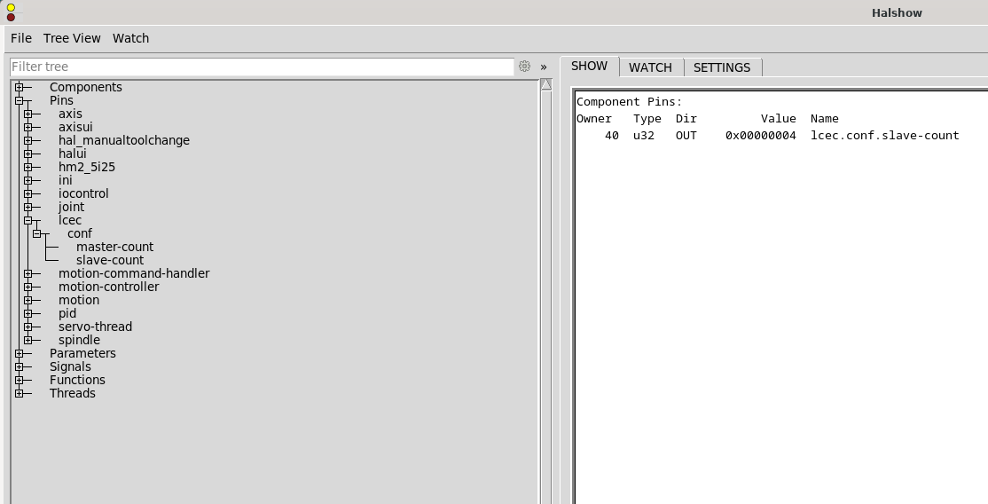

here is my result of ethercat slaves:
0 0:0 PREOP + EK1100 EtherCAT-Koppler (2A E-Bus)
1 0:1 PREOP + EL2008 8K. Dig. Ausgang 24V, 0.5A
2 0:2 PREOP + EL1008 8K. Dig. Eingang 24V, 3ms
3 0:3 PREOP + EL1018 8K. Dig. Eingang 24V, 10�s
my xml file is attached
and a print screen of what I have in Hal show. My pins are not visible
Last edit: 09 Dec 2024 09:36 by vibram.
09 Dec 2024 12:07 - 09 Dec 2024 12:59 #316320 by daveyr
Replied by daveyr on topic Ethercat-conf.xml with beckhoff el1008
Now i am quickly getting out of my depth, :) It looks like you maybe missing the link to the XML file in your hal? as you are not showing the EK1100 in the list of Pins.
do you have something similar to
loadusr -W lcec_conf ethercat-conf.xml
You also seem to be missing the Readall / writeall for lcec can you post your hal?
In your xml? and when you start from the cmdline are you getting any errors?
Last edit: 09 Dec 2024 12:59 by daveyr.
09 Dec 2024 13:05 #316329 by daveyr
Here is my very basic (1 axis with error starting Axis) config.
If you dont have a ECT drive then remove that from the xml and just configure a single drive in your Hal and it should start up.
09 Dec 2024 13:16 - 09 Dec 2024 14:48 #316332 by vibram
Replied by vibram on topic Ethercat-conf.xml with beckhoff el1008
THank you, it seems to work for me now with my config.
And I added the read all /write all and tested inputs and ooutputs, great :)
I think I put these 2 rows
loadrt lcec
maybe too early in the file compared to my Mesa card? is it possible ?
Last edit: 09 Dec 2024 14:48 by vibram.
