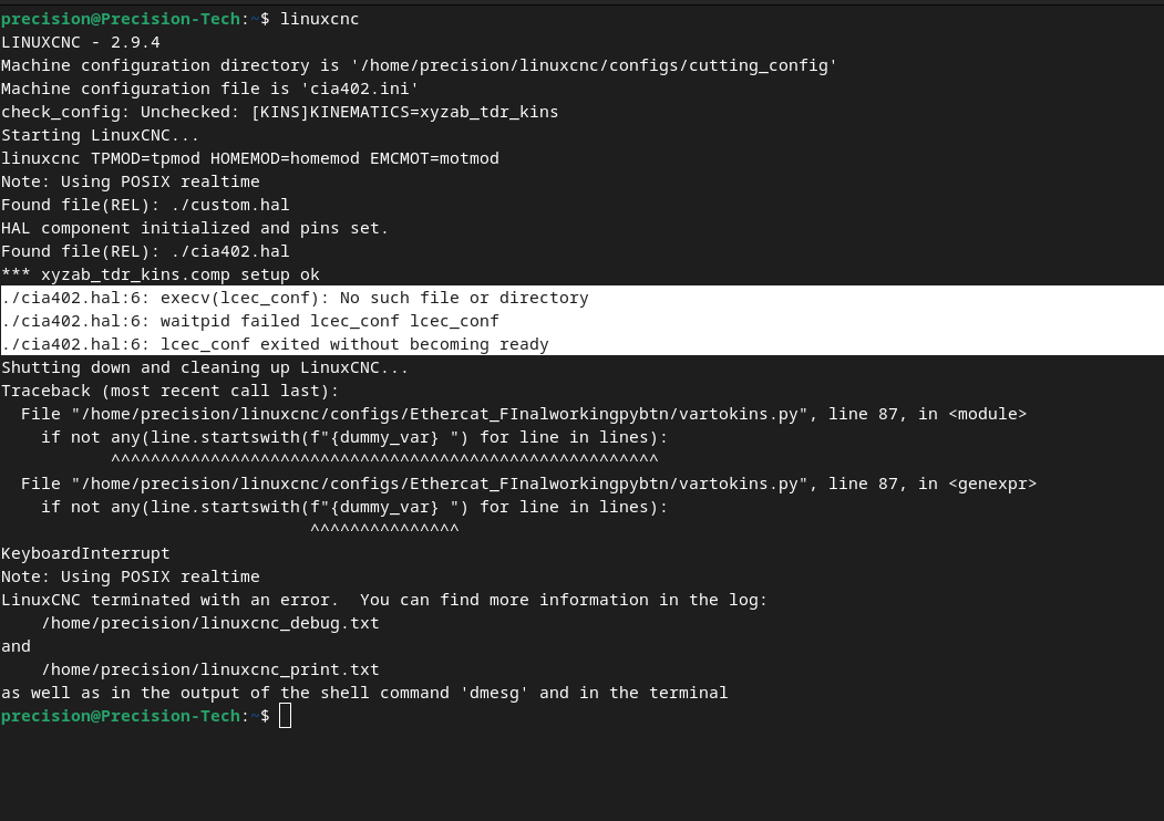

I got a new pc setup and tried downloading ethercat i followed the guide thats on the forum but i keep getting this error any help would be greatly appreciated

Ethercat on its own works fine a reads the slaves the issue is with the driver i think

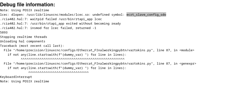

i tried re installing again and now i have this new error instead

26 Feb 2025 12:16 #322687
Replied by rodw on topic Issues with EtherCAT linuxcnc driver installation
I think there is an error where you load your xml file in hal
Do you have this in hal?
loadusr -W lcec_conf ethercat-conf.xml
loadrt lcec
loadrt lcec

Replied by Abdulkareem on topic Issues with EtherCAT linuxcnc driver installation
i do have both of these lines in my hal file

26 Feb 2025 15:55 #322716
by Hakan
Replied by Hakan on topic Issues with EtherCAT linuxcnc driver installation
Did you install linuxcnc-ethercat? The error says it is missing lcec, linuxcnc-ethercat.

27 Feb 2025 03:45 #322770
by Hakan
It mentions a filename vartokins.py, I don't have that here so I don't know what that is.
