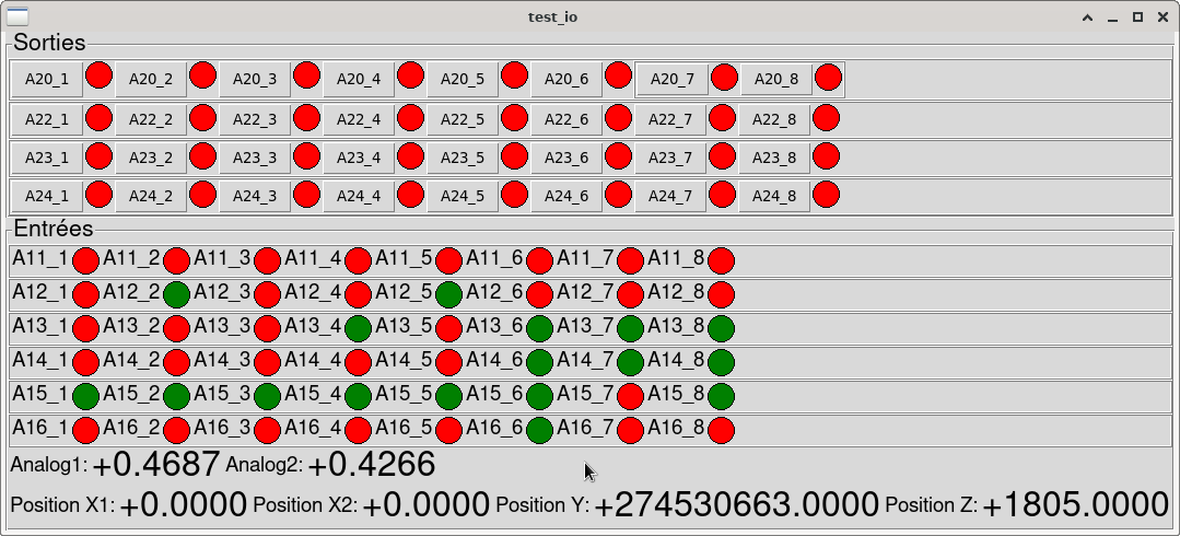

Hello everyone. This is the first time i'm using linuxcnc and i have a lot of questions. I've retrofited dozens of cnc machines with mach3, but none with linuxcnc. This time i need help. I've installed and configured ethercat with kollmorgen s700 drives. I've made a window to read input and output states. and it works. My problem is that i don't know how to display the position of the axes, the x,y and z positions are always at 0 in the main window. Any ideas? I've looked for information in the forums but i guess the answer is so simple that no one has written it down. Thank you in advance.

It works now but i have another problem. My machine have 2 motors for the X axis. When i click on the X+ or X- button only one motor turns (X1). when i click on the Y+ or Y- button it's the other x motor that turns (X2). Any ideas?
Thanks in advance.
LINUXCNC - 2.9.4
Machine configuration directory is '/home/byuser/linuxcnc/configs/53h_alfa'
Machine configuration file is '53h_alfa.ini'
check_config:
INCONSISTENT coordinates specifications:
trivkins coordinates=XXYZ
[TRAJ]COORDINATES=XYZ
Starting LinuxCNC...
Note: Using POSIX realtime
Found file(REL): ./pre_gui.hal
identityKinematicsSetup: coordinates:XXYZ
Joint 0 ==> Axis X
Joint 1 ==> Axis X
Joint 2 ==> Axis Y
Joint 3 ==> Axis Z
identityKinematicsSetup: Recommend: kinstype=both

Solved!!!
- stone_sleeper
- Posts: 7
31 Mar 2025 07:02 #325386
by stone_sleeper
Replied by stone_sleeper on topic need help ethercat et linuxcnc
[KINS]
KINEMATICS = trivkins coordinates=XXYZ kinstype=BOTH
