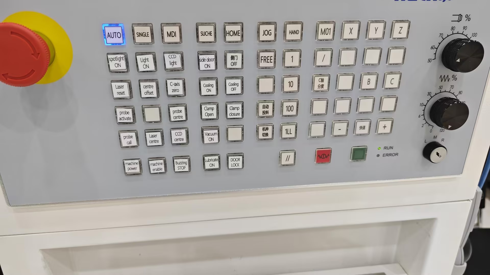

Hi everyone, I’d like to share a long-standing issue I encountered and the solution I found. The problem began when I tried to connect an EtherCAT panel to LinuxCNC. During the configuration process, the slave device remained stuck in the PREOP state and failed to enter OP (Operational state). This was caused by manually configuring certain PDO files, which led to unrecognized settings. The fix was to set configPdos="false" in the configuration. Apologies for my poor English—the original text was translated using software. For reference, I’ve also attached an image showing the LED activation (see attached image). Hope this helps anyone facing a similar issue!

Sure, but that's just one example. Because I haven't done all the configuration yet, in the XML below, I show some outputs and inputs, where value is used to read the MPG signal.

I've forgotten the exact debugmsg at that time. I obtained the information for this issue from the diagnostic LED provided by the manufacturer. The specific content is: Invalid parameters were written.

Can you kindly share more info about this ethercat panel?
Where did you get it and model? And a few more photos?
- NWE
- Posts: 263
- Thank you received: 81
10 Feb 2026 04:14 #342751
by NWE
Replied by NWE on topic Ethercat panel configuration
For what it's worth, searching aliexpress for panel21190e finds some similar items.
I notice one of the pictures shown at www.aliexpress.us/item/3256808758453292.html appears identical to Soccer Kid's panel.
