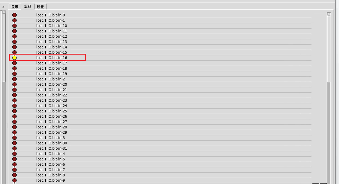

The PDO entries of the EtherCAT master are 128 in number. Any error will occur if the number exceeds this limit. For the same type of enumerated points, you can use the abbreviated form for writing. For example:<pdoEntry idx="6000" subIdx="01" bitLen="32" halPin="bit-in" halType="bit"/> Here, an input point with a sub-index ranging from 1 to 32 is declared.
